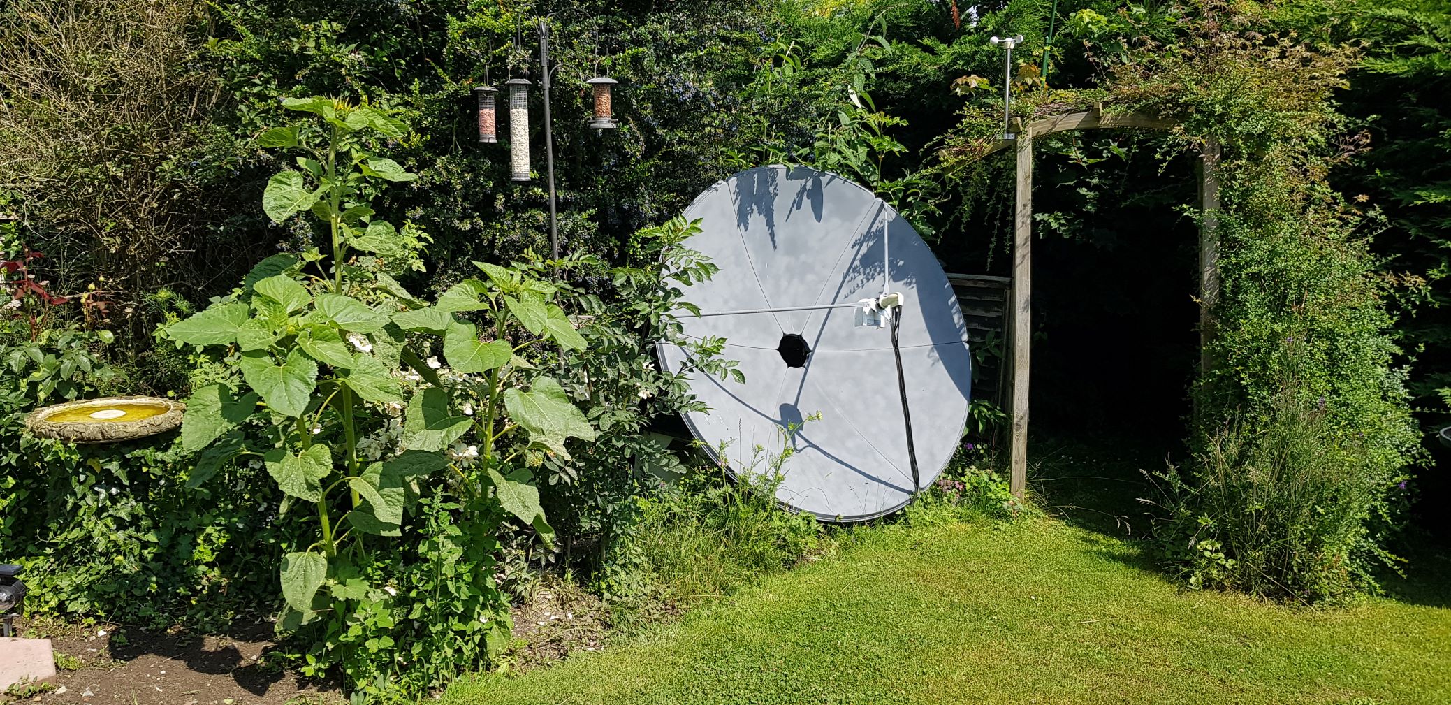

My 1.8 meter QO-100 installation.
Martin
G8KOE
Martin
G8KOE
- G8KOEdish.jpg (769.2 KiB) Viewed 7511 times

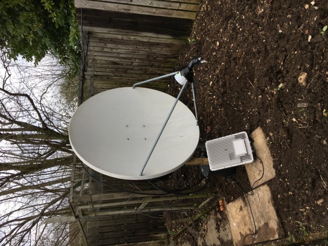

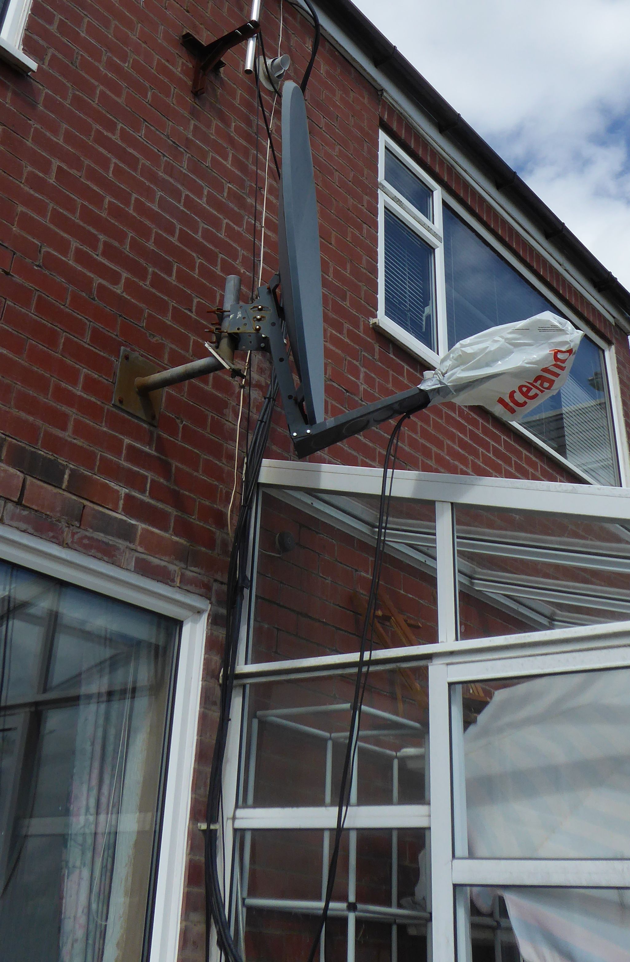

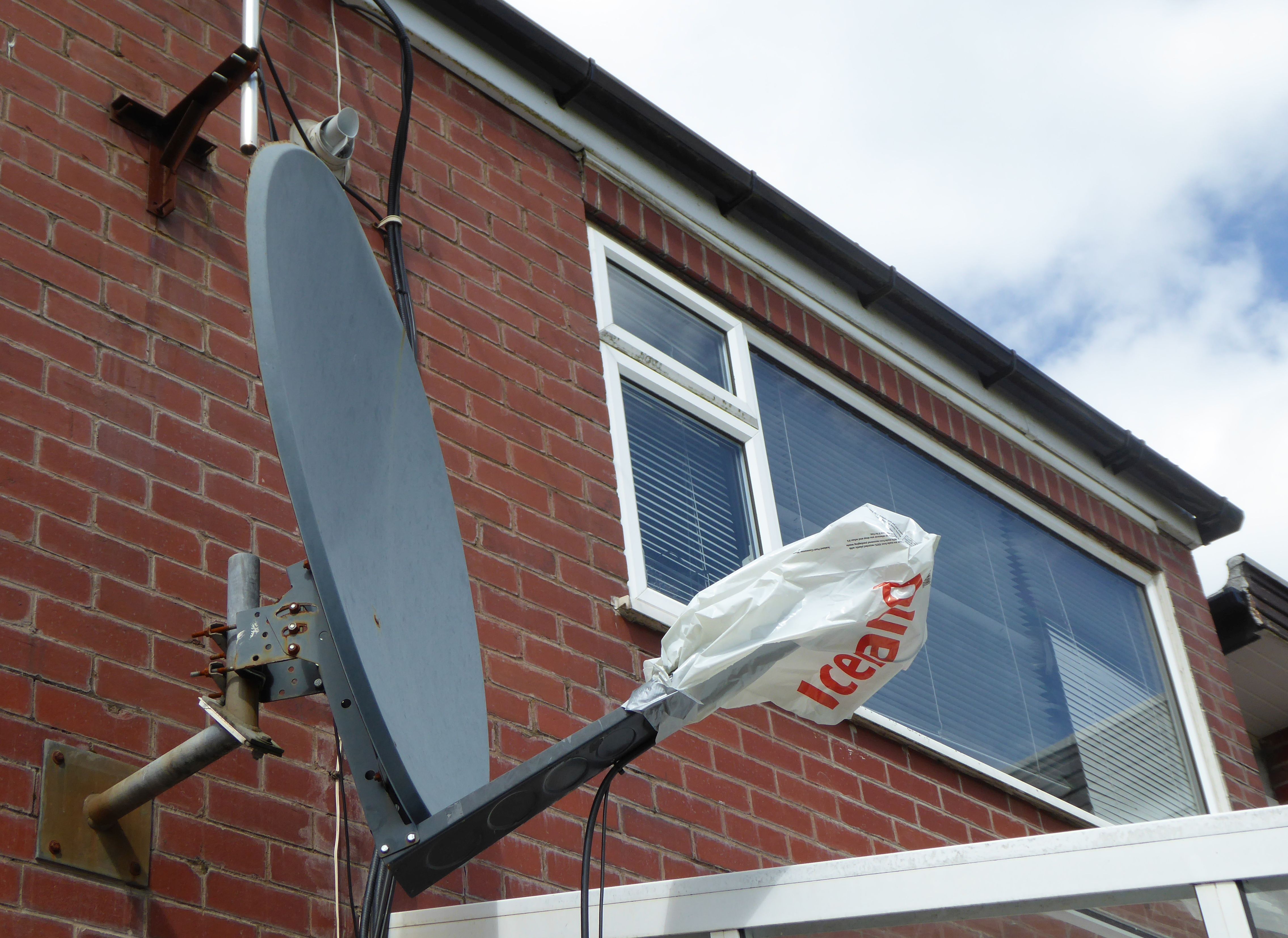

My dish in Harwell is well away from the boundary, but cases like Dave's some wire mesh on the fence would probably provide sufficient screening should a problem be discovered.
Bolton is another matter, my dish is 10ft up in the air so no issues in front of it, the place at risk is the shack below but two layers of engineering bricks and double glazed metallised windows are opaque to RF (ask how I know
) so that's OK.

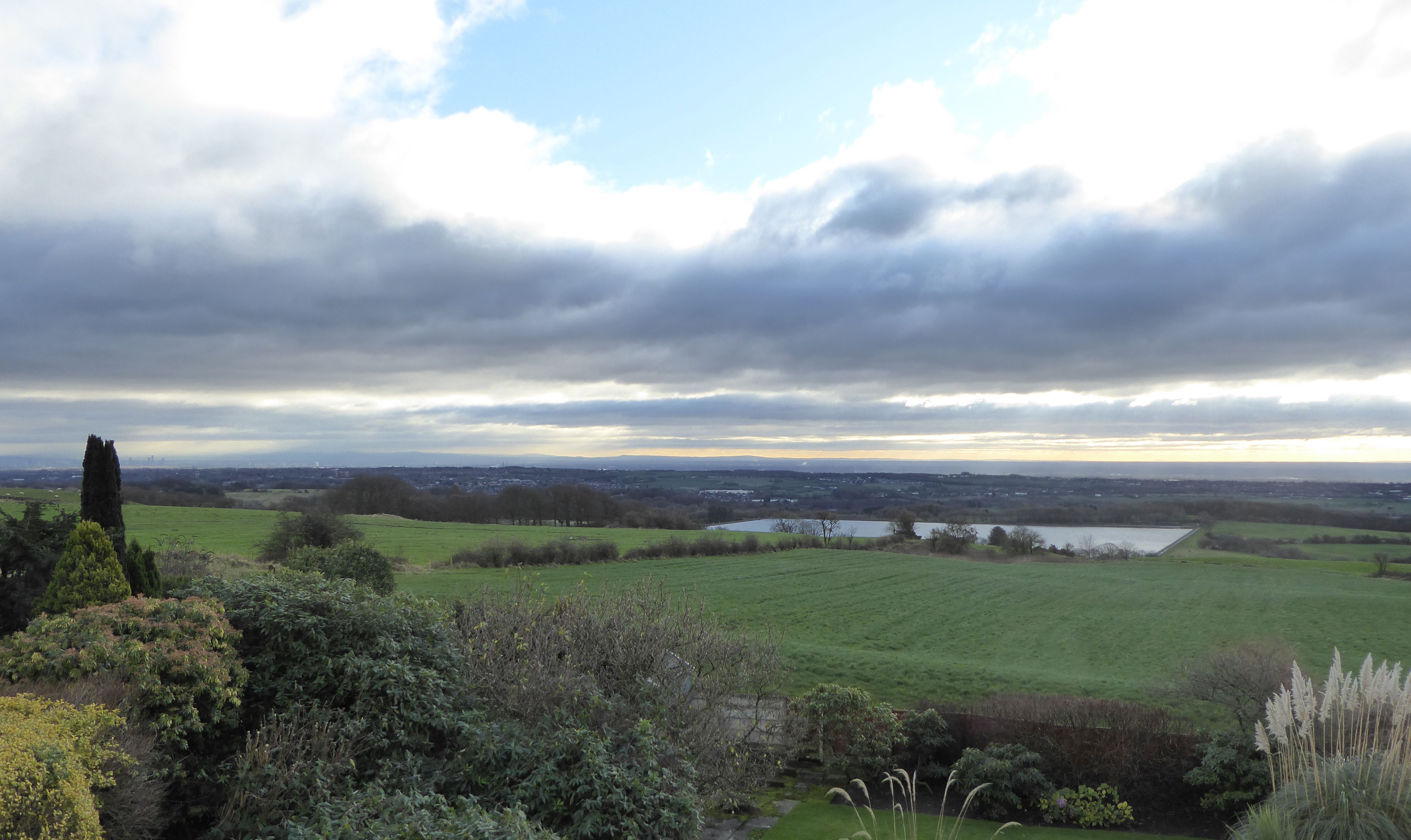

Here is the dish in situ with it's Scandinavian class weather protection Here is the view from said dish towards QO100. So unless the victim is 10ft tall and wearing heals, we should be OK.

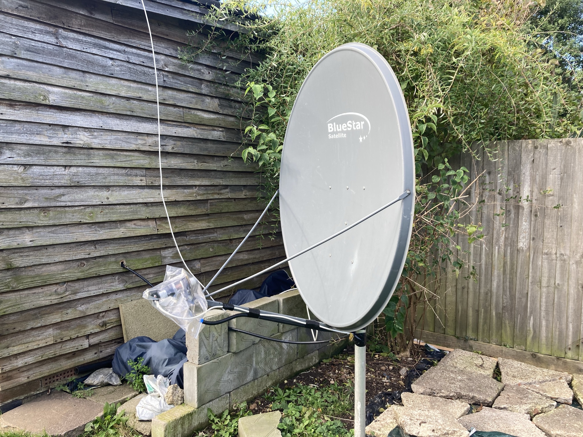

Picture of my 1.2mt dish below.

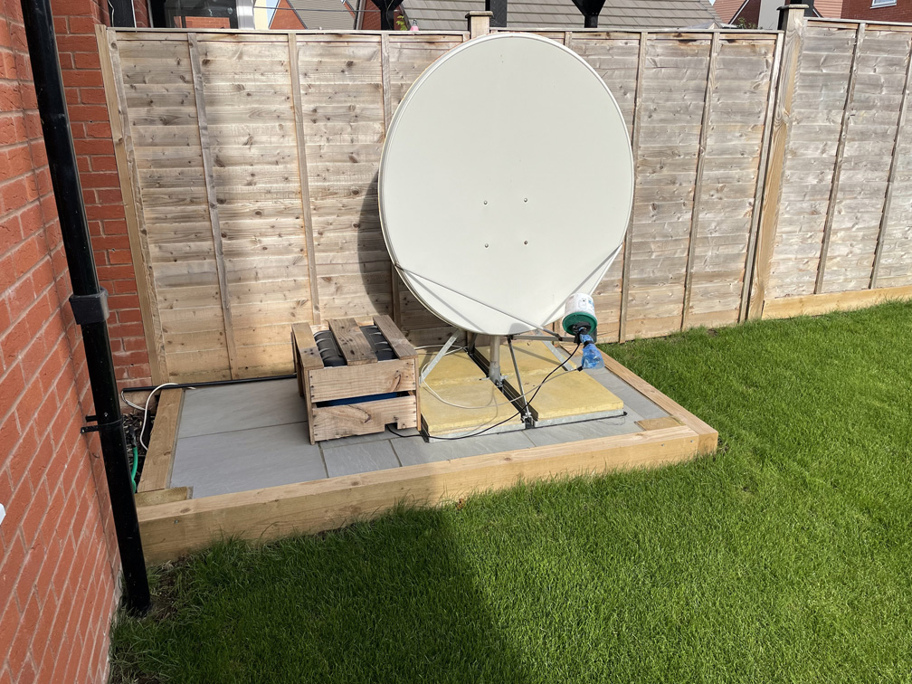

My 1.2m dish.
I measured 2.8m from the POTY to the fence. Its 5.7m from the dish face to the other fence in the direction of QO100 and the dish centre is 1.3 above the ground. So its probably OK where it is.
Duncan G7VVF
Duncan G7VVF

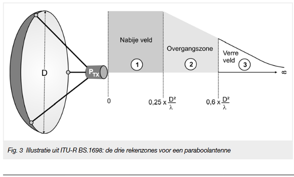

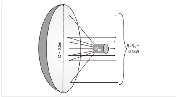

In Electron January 2015 PF1F published an excellent article and held a presentation during the VHF-and-above day in 2015 about 'safe' field levels and parabolic dishes.
In fact, used formulas are often fine for far field but not for nearby field.
ITU-R BS.1698 could be used for that (https://www.itu.int/rec/R-REC-BS.1698/en figure 1, page 15).
In the article by PF1F the mentioned example for 0.8 Watt on 24 GHz in a 50 cm dish. "The 'near field' here means: the distance within which the far-field calculations do not apply at all. For our 50cm dish, this zone 1 runs from 0 to 5 m from the parabola. The maximum S here is the aforementioned 9.8 W/m2, and we assume that it is present everywhere in zone 1.
Zone 2 is the transition area from the near to the far field. Here, the power density S decreases approximately linearly with distance. At the boundary of the far field, in the example at a distance of 12 m, S thus comes to 4.1 W/m2.
The ITU standard already starts the far field at 0.6 D2/λ, so here at a distance of 12 m. Using the far-field formula, we find here an S of 4.2 W/m2, which indeed corresponds very well with the result from the transition zone. (We would find an exact match with the factor π2/16 = 0.617, instead of 0.6.)
Once in the far field, i.e. beyond 12 m in our example, S decreases by the square of the distance. The far-field formula works well here.
The general formulas for the power density are:
Zone 1 (near field): S = 16 P / (π D2)
Zone 2 (transition zone): S = 4 P / (π λ R)
Zone 3 (far field): S = π D2 P / (4 λ2 R2)
Here P is the 'net transmit power, so P = ηPTX.
The gain of the dish is already included in the formulas.
Thus, at the beginning of the transition field, approximately S = 5.1 P/D2; at the beginning of the far field approx. S = 2.1 P/D2. If we know in which zone the limit value is exceeded (if that happens), we can use the corresponding formula to determine the safe distance. Some calculations are still necessary!"

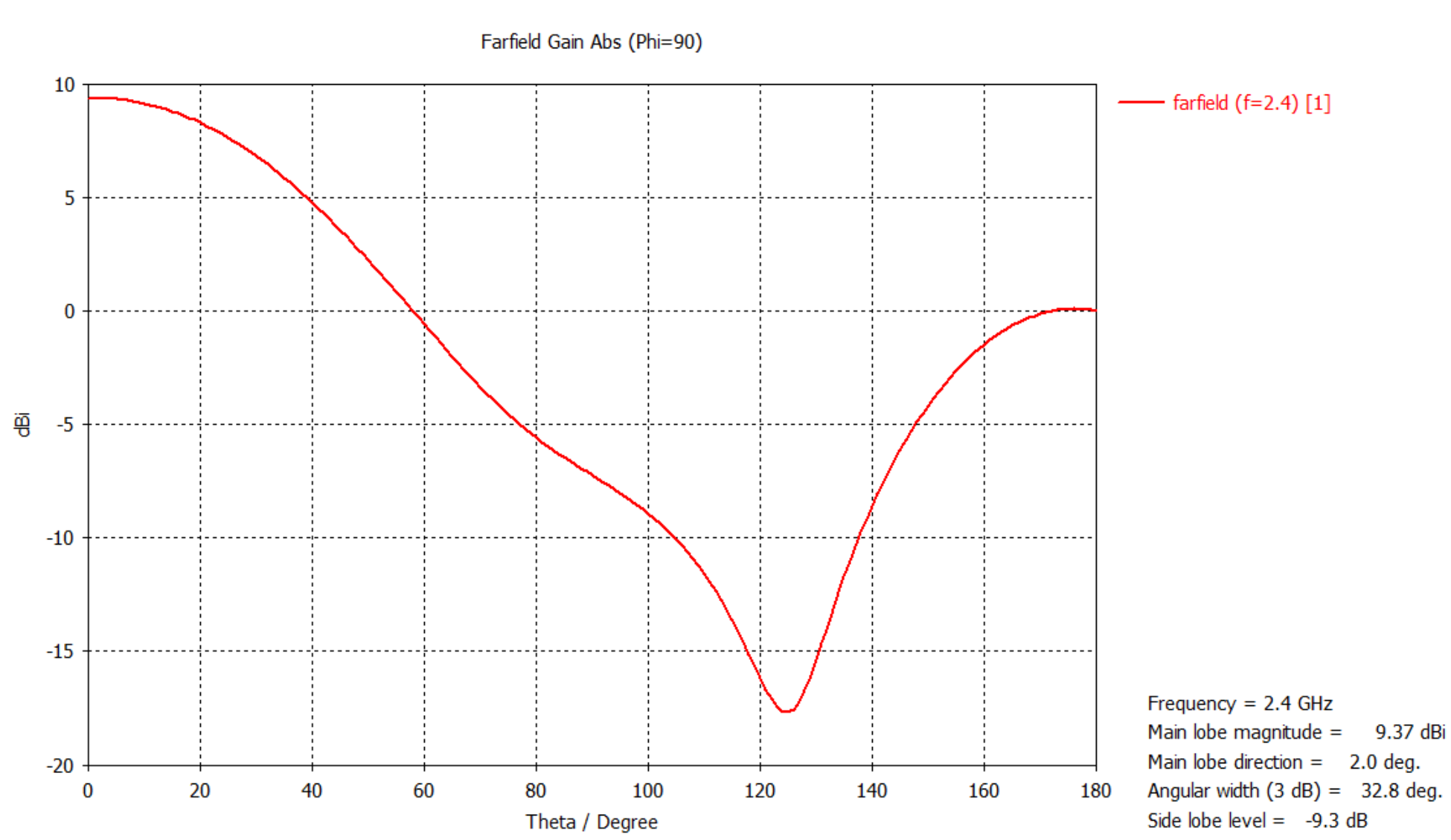

The obvious first test is what if the dish was entirely absent? If a 9.5 dBi horn located at the feed point is still safe behind the dish then there is nothing more to do.
If it is not then the gain needs to be estimated at the edge of the dish. That involves geometry and looking at feed patterns. If you know the F/D you are half way there. If not this might help him https://www.satsig.net/pointing/finding ... -angle.htm - there is a calculator at the end of the page.
The other way is to simply measure the angles and read off the pattern. For example, say the feed arm is 70cm from the dish and the dish is 100cm across then the half angle is roughly 36 degrees. [It's an approximation, probably good enough]. The radiation pattern is approximately like this - someone really ought to measure it you know, it's been 3 years and nobody has -
So at 36 degrees it is only 4 dB down with a gain of ~6 dBi.
With the Channel Master dish the angle is ~40 degrees so 4-5 dBi.
The 10 dB down is at about 55 degrees which would be an F/D of 0.35. That's not the most efficient though*, as well as the energy that hits the dish vs that which misses it there is the illumination efficiency to consider, ideally the illumination is constant across the aperture, but it is not with a simple feed like this. Even though you are losing power past the edge, if the dish illumination is more even you may gain more than you lose. The net result, according to a study by Willi, HB9PZK using the full version of CST is 50-60% efficiency from F/D of 0.4 to 0.75 - which is not great but good enough for such a simple to build feed. Unfortunately Willi deleted his web articles so I can't share a link. A full simulation in CST would be the proper way to do these assessments. Perhaps the RSGB can negotiate with a university with access to do so. It would be a good student project, though probably postgrad rather than undergrad.
*W1GHZ has some excellent notes on this in his antenna book.
Re: QO-100 Transmission EMF Case Studies
Mike,
I agree with you about the 3.5 dBi, my estimation about 0 dBi was too rough (I considered the gain of such wide feedpattern lower)..

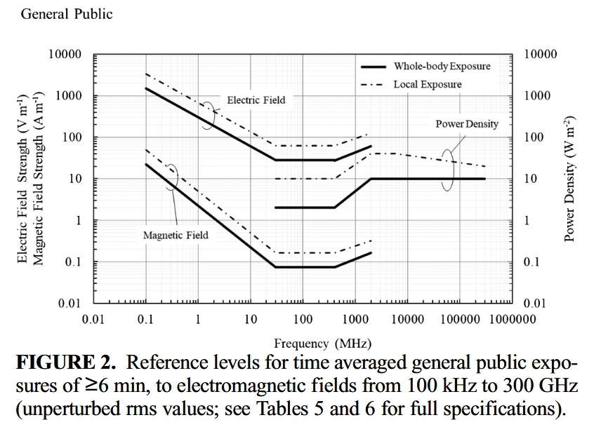

As I understand, the level considered at ‘safe distance’ is for ‘public’ at this frequency is 61V/m (for us ‘worker’ 137V/m). The formula I found is:
d (m) = √ 30 EIRP(W)/ E (V/m)
When we fill out the data for a station with 25 Watts and your 3.5 dBi (= 2.3 times):
√30*25*2.3/61 = 0.68 mtr.
So if the distance of the feed opening to the accessible edge of the dish is less then 68 cm, it is likely the limit is passed?
All of this with a question mark because I am not sure if this all is correct. I am not sure about the (correct use of) the formula and the V/m level. Still a lot to read: https://www.icnirp.org/cms/upload/publi ... dl2020.pdf
If it is (more or less correct), larger dishes are safer because of the larger distance from the feed to the edge.

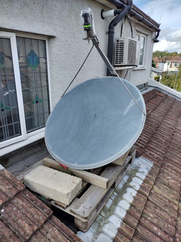

As my dish is already 4m AGL and well screened from passing people I think I'm OK, even when running enough power for 1Ms - only done to see if the amp could.
Any edge over-spill is going to hit the concrete roof tiles, sundry timbers and thermalite bricks. Not that anyone except me goes into the garage below.
About the only RF advantage of my location - a safe line the QO-100
