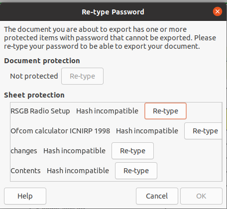

Anyway using the RSGB calculator my main problem area has always been in me running Linux and using Libre office after a few minutes I get this message on the screen.
- Screenshot from 2021-10-21 10-32-11.png (39.58 KiB) Viewed 8324 times
I can not convert to Libre office type .ods files as it will not let me get passed this box and once it occurs it is hard to cancel. So if anyone knows how to solve I would appreciate it.
I have printed off PAEC-2 in case it gives me more clues on exclusion zones, but it looks as though I will still have to await the planned spreadsheet table as mentioned in the talks.

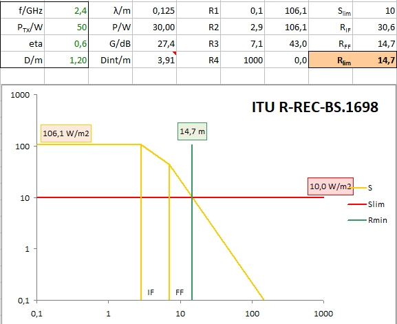

Looking at the calculator I posted in
viewtopic.php?f=2&t=7660 and the data
1.2m dish fed with 50W
it shows
- Result fieldstrength calculator.JPG (97.27 KiB) Viewed 7897 times
So a distance of 14.7 meter
in front of the dish.
However, because the dish is pointed upwards, after a few meters the beam will pass over your head.
Suppose we calculate with a person that is 2 meters tall, the dish is pointed 27 degrees up, the distance will be 3.9 meters. (20 degrees results in 5.5 meters). Of course measured from the lowest point of the dish, not the mount position
It shows the distance is defined by the angle of the dish and how tall the person is
This totally complies the conclusions by Dave.
Powers under about 5 Watt (with this size dish) will reduce the considered safe distance.
So in fact, for ATV consider you need to have the space free in front of your dish (while transmitting).
