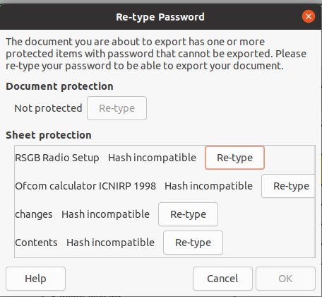

I was unable to view the CAT21 live on Saturday so therefore unable to pose any questions on the day. Viewing the EMF section today, the chart that was shown of the exclusion zones for dishes (35 minutes in) did not seem to show, or, had a very small side-lobes exclusion area.
So I was a bit confused over this as it was something the Mike had mentioned of using a side-lobe mask in a thread I started some time ago, were Mike pointed to an article on this https://en.wikipedia.org/wiki/Side_lobe.
It was mentioned that this only goes down to a 1.2m dish as smaller dished have less than 10 wavelengths may not perform as the chart.
Anyway using the RSGB calculator my main problem area has always been in me running Linux and using Libre office after a few minutes I get this message on the screen.
Screenshot from 2021-10-21 10-32-11.png (39.58 KiB) Viewed 8315 times
I can not convert to Libre office type .ods files as it will not let me get passed this box and once it occurs it is hard to cancel. So if anyone knows how to solve I would appreciate it.

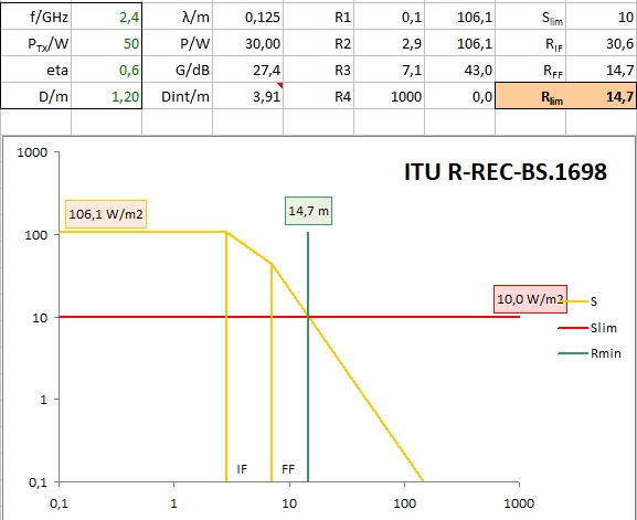

Looking at the calculator I posted in viewtopic.php?f=2&t=7660 and the data
1.2m dish fed with 50W
it shows
Result fieldstrength calculator.JPG (97.27 KiB) Viewed 7888 times
So a distance of 14.7 meter in front of the dish.
However, because the dish is pointed upwards, after a few meters the beam will pass over your head.
Suppose we calculate with a person that is 2 meters tall, the dish is pointed 27 degrees up, the distance will be 3.9 meters. (20 degrees results in 5.5 meters). Of course measured from the lowest point of the dish, not the mount position :mrgreen:
It shows the distance is defined by the angle of the dish and how tall the person is :)
This totally complies the conclusions by Dave.
Powers under about 5 Watt (with this size dish) will reduce the considered safe distance.
So in fact, for ATV consider you need to have the space free in front of your dish (while transmitting).
