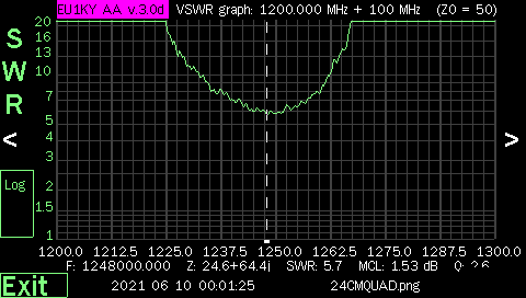

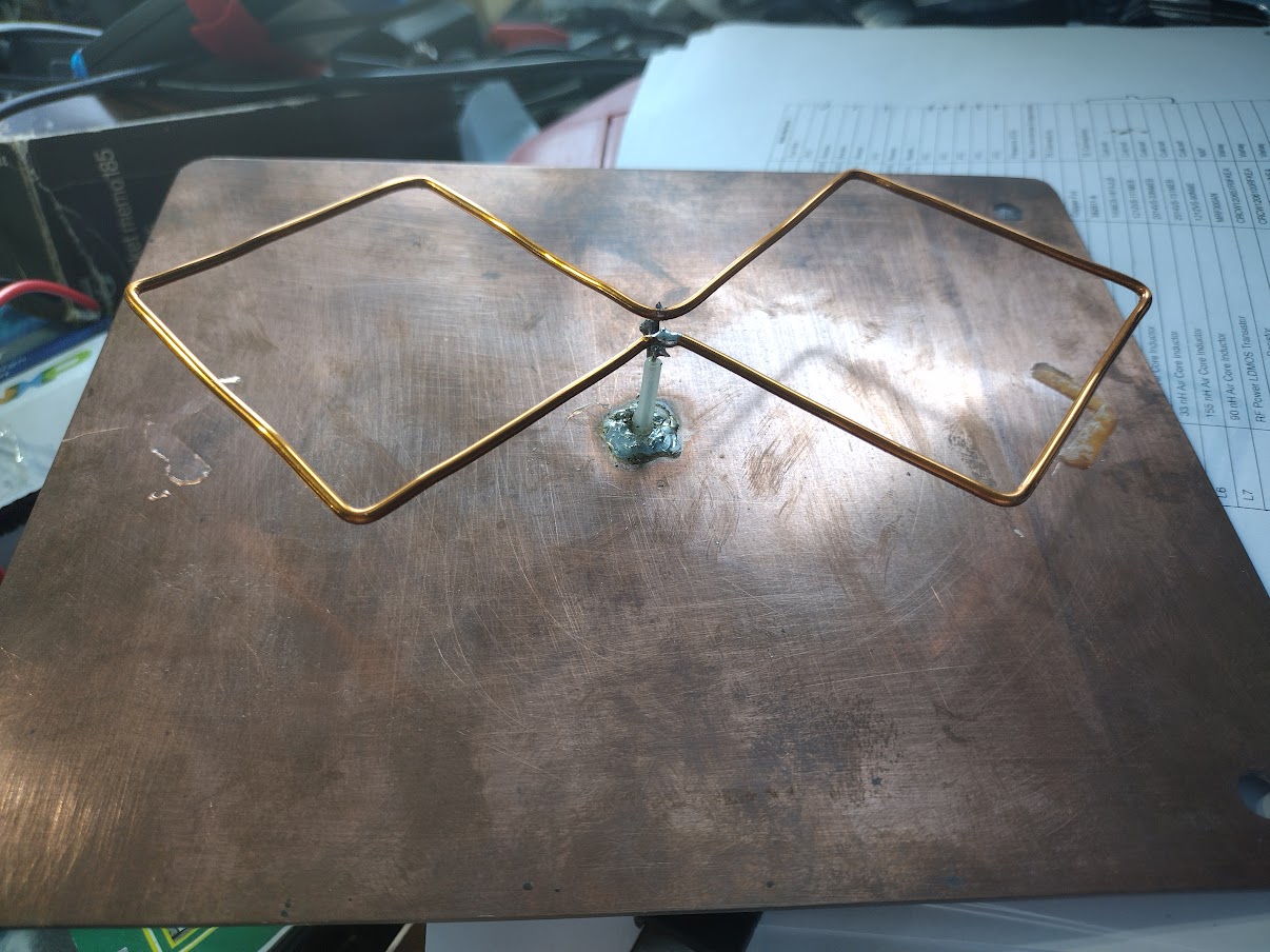

I've a need for some decent gain for /P on 24cms and also something for my local repeater, so I built a bi-quad using one of the many on-line calculators. Previous ones I've built for 3.4GHz seem to match up as expected with my NanoVNAV2.
I built one as per the directions, making a precision 3-D printed bending jig to help and 2mm diameter ECC for the element. However, it really does not look like its a good match and changing the distance from the reflector makes no real difference.
Here's a plot from my EU1KY antenna analyser, the NanoVNA largely agrees.
Only thing it does NOT have ATM is any sort of choke at the feed-point?
Pointers very welcome....
Sides are 60mm, target freq 1250. Thanks

Hi Gareth,
Looking at the photo of your antenna it looks obvious to me that the coax is not connected the way it should.
The shielding of the coax seems to be removed between the reflector plate and the bi-quad element?
The shielding should not be removed, feedpoint one side to the centre pin and the other to the shielding (and do not solder it to the reflector plate).
(By the way, your construction makes depth adjusting difficult, more easy if you use some kind of plastic clamping feedthrough, leave the coax intact).
If you want to do it completely correct (going from balanced to unbalanced) you could add a quarter wave wire in parallel with the coax, one side connected to the pin and the other to the shielding of the coax (therefore an additional hole needs to be made in the plate). Without this additional wire you should also be able to get a proper SWR.
Just google on 'Pawsey Balun'.
Cheers,
Chris PA3CRX

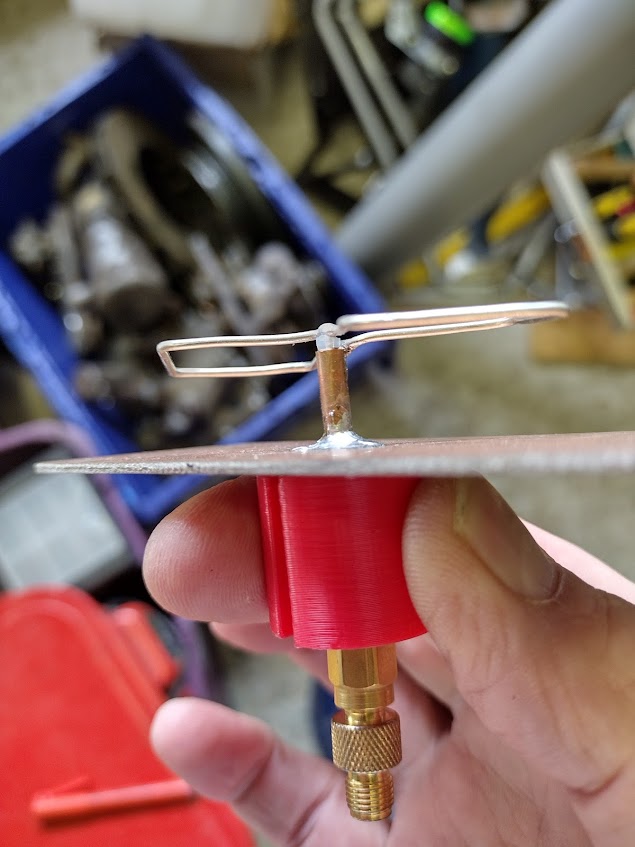

Thanks Chris, I'll implement those suggestions and report back
Not sure quite how I missed that (other than by copying the web page https://buildyourownantenna.blogspot.co ... lator.html) as I didn't when I built the little 3.4GHz dish feeder - picture below...
Every day is a school day (and sometime again it seems

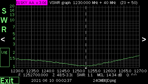

Well that was 'easy' - just got to design some smart 3-D printed supports for it now. This is without any balun and with the coax outer isolated from the backplane.

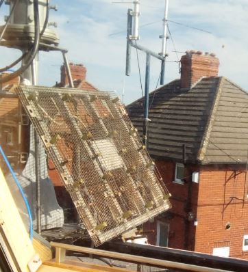

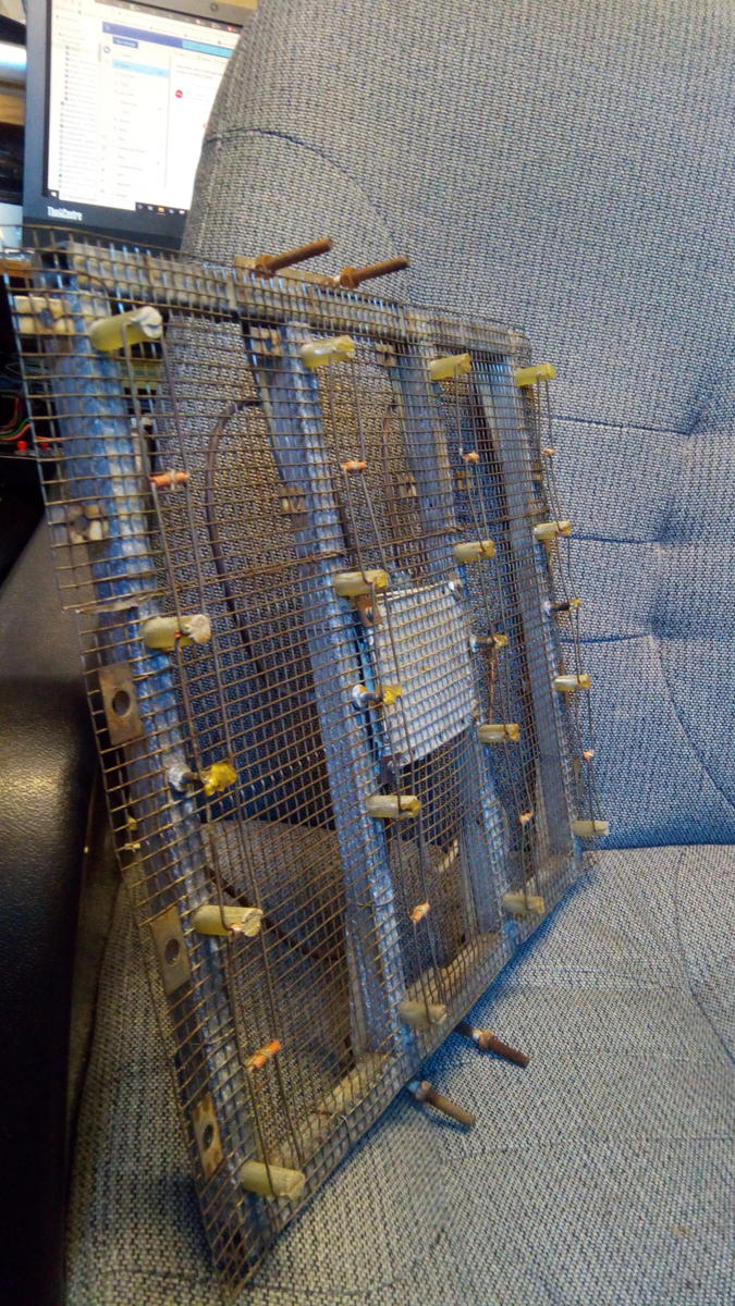

CQTV 180 & 182 mag 1999 describe something similar.
I made one all those years back , but re-scaled for 2.4ghz. after we more or less abandoned 13cm FM TV due to interference from emerging wifi
etc it languished in my coal-place for more than 20 years.
Then came QO-100 and a remembered it. Dug it out burried beneath lawnmowers , old tyres, etc.
Currently i'm using it on the NB transponder. Yes its 3db lost as its horizontal. Im S9 in with 10 watts.
S5 using a 3w (8w Chinese) wifi amp.
I can move it OFF alignment by 20 deg either way and still get in !
Vertical alignment has to be spot on.
Its pointing directly at the satellite.
You can make out the 4 way power splitter on the rear behind the chicken wire reflector 32cm square.
On the front are 4 sets of loops sitting around 1" in front of the reflector.
The loops are made from the single strand copper earth from the inside of mains cable.
The off-stands are plastic PCB type with a hole drilled through for the wire supports.
Dabs of epoxy hold things in place.
The feeds from the power splitter are solid semi-rigid.
Because its only just over a foot square this might be attractive to all those that have the desire to go /p
Tested works good also on the Tuesday Night 13cm contest SSB using Langstone/Pluto
Anyone wants a sched on QO-100 to work me using this old manky thing on the uplink .. send me a message ( QRZ.com for email )
