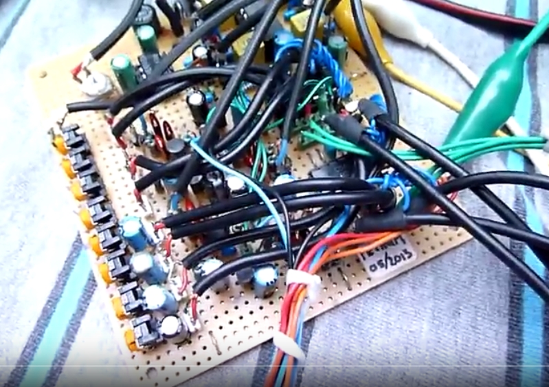

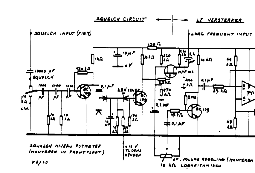

You have several solutions handed over now but to come back on your question how the squelch circuit was made; it is based on an old (1975) schematic of a home made 2 mtr FM transceiver. In accordance with what you assumed indeed a simple high pass filter is used.
In our circuit we used CD4066 instead of the fet (multi channel). Simple but effective!
squelch circuit 1975.JPG (186.14 KiB) Viewed 6659 times
squelch circuit made by PE1RQM.JPG (338.33 KiB) Viewed 6659 times
In case you want to build it: no PCB layout present :lol:
Best regards,
Chris PA3CRX
