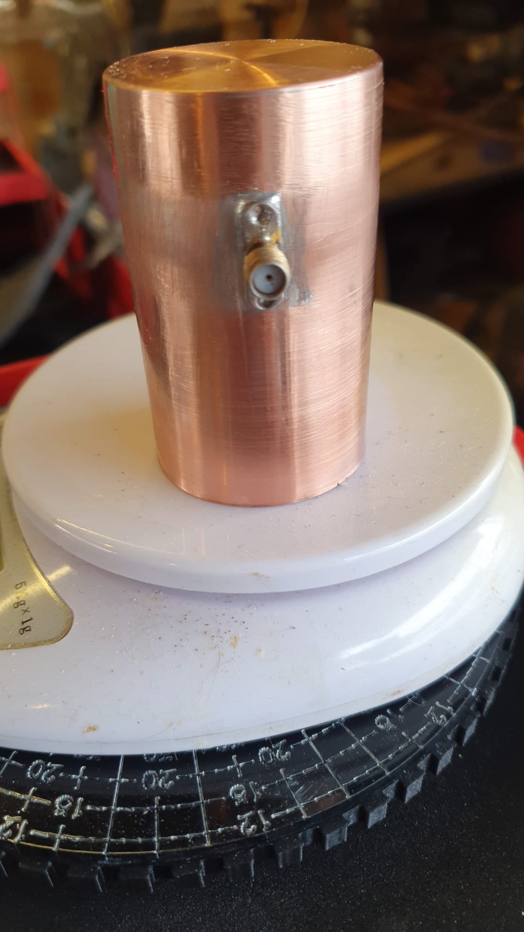

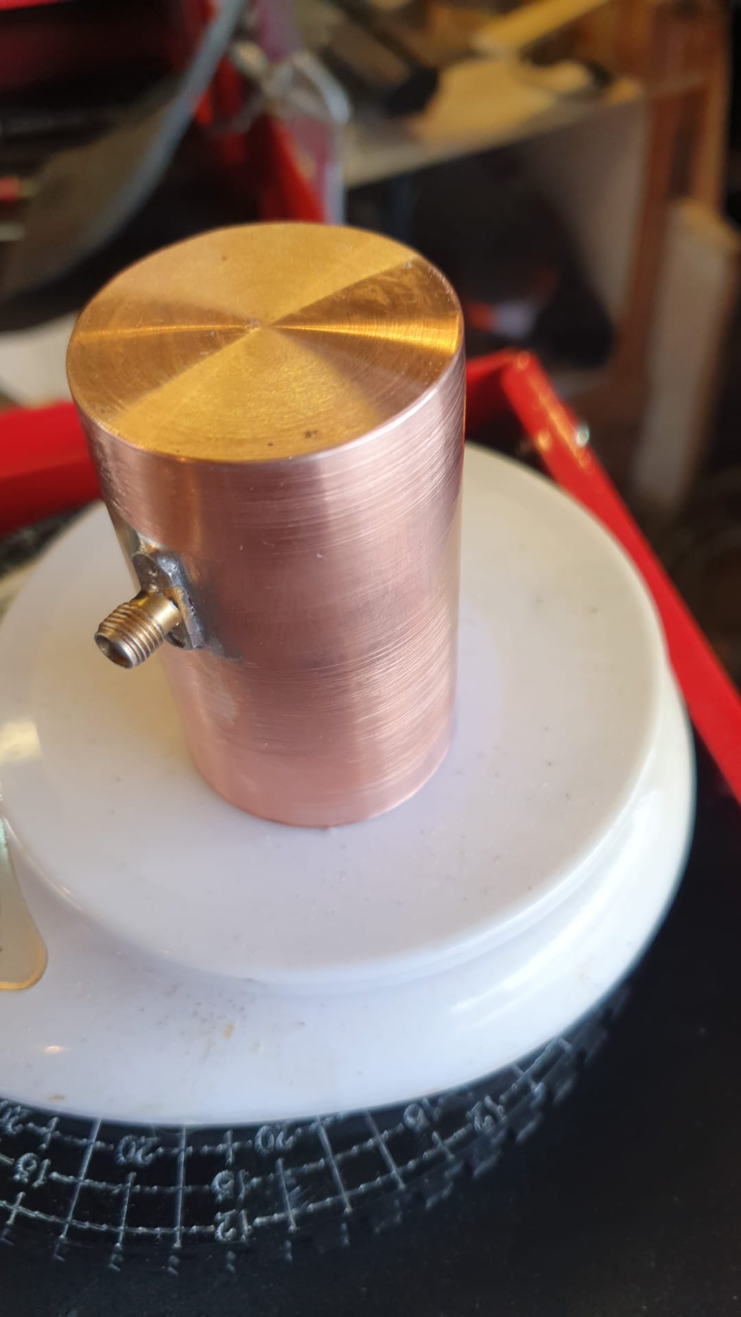

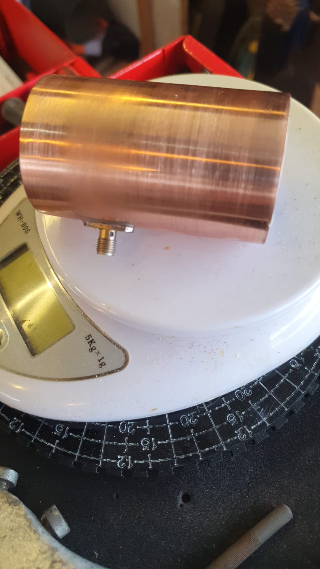

I am having a little play in the workshop. I have made a few 23cms cantennas and the work very well.
So i decided to have a go at making a 5665mhz cantenna for ATV on the 5.6Ghz band.

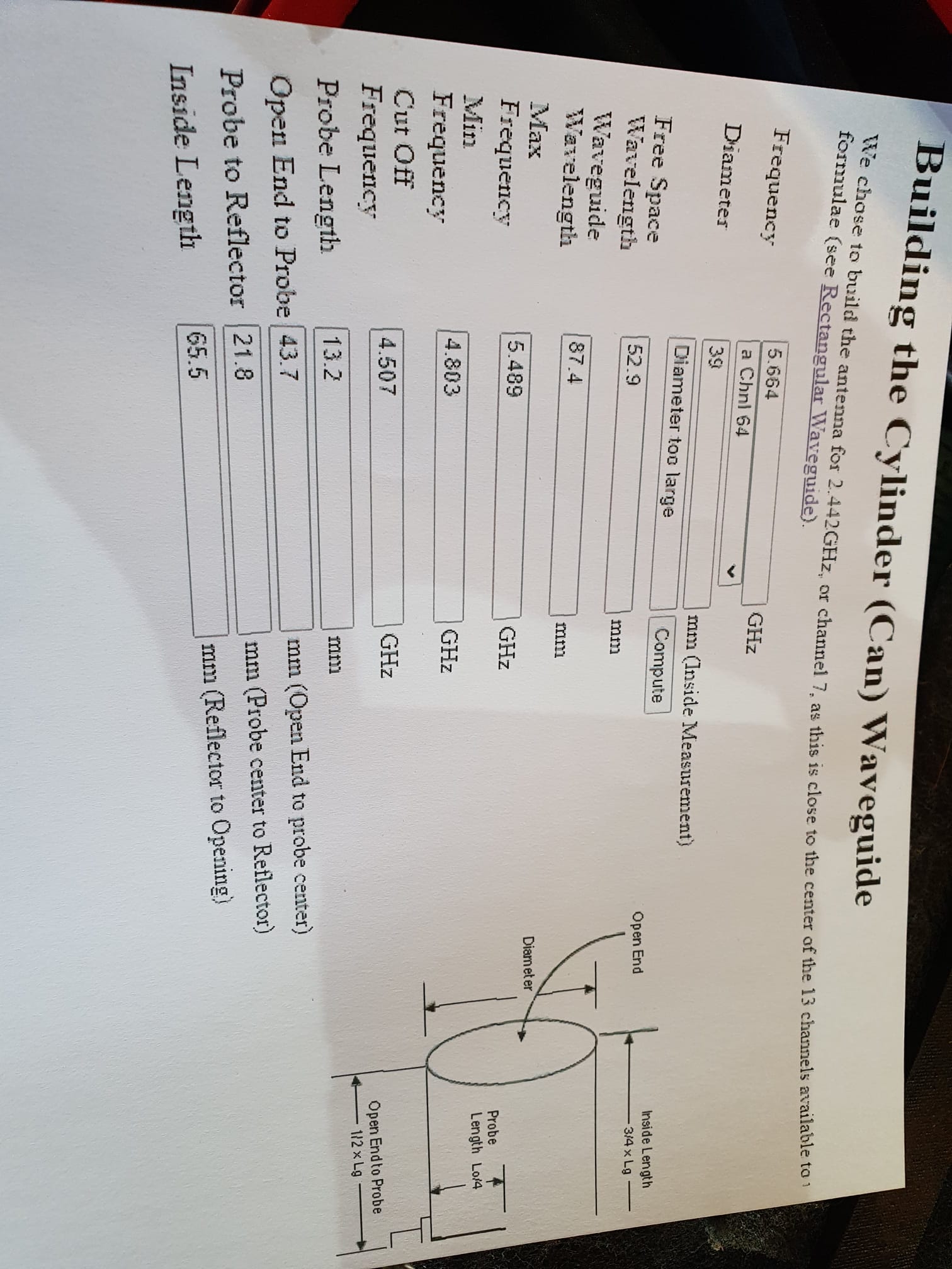

The calculator i used is here https://www.wikarekare.org/Antenna/WaveguideCan.html

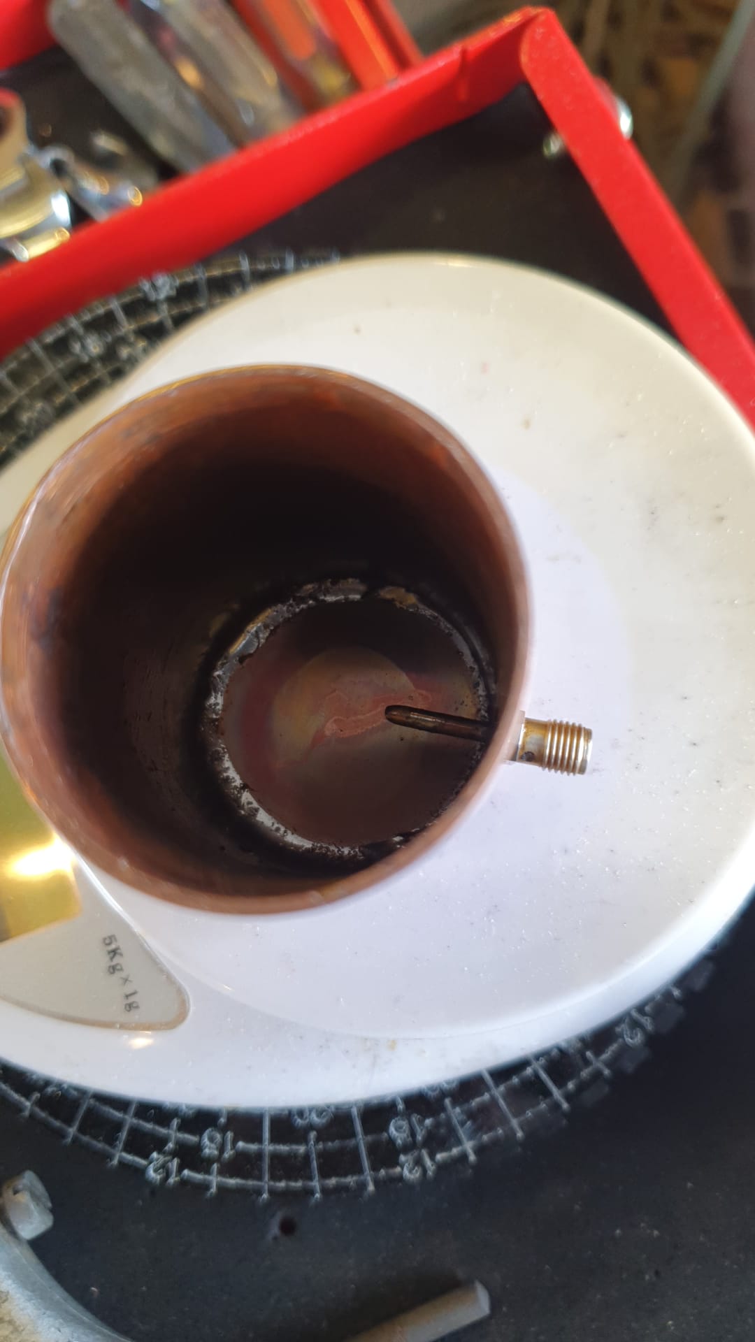

To solder the end on i used solder paste and a blowtorch. this made life easy. As the copper will dissipate a lot of the heat. I did the same attaching the SMA connector.
I intend to attach one to a sky dish. I will be making and 3d printing a holder so i can attach it to dish.
I don't know the gain of the cantenna on its own.( Ive heard figures from 4 to 12 dbi) I guess around 5 or 6 or once its attached to a dish. maybe one of the antenna gurus master of the dark arts of RF could let me know.

You would of been better using an ID of 35mm
As your highest resonant freq is below 5665MHz according to the data you posted.
It will work I guess, but will be a bit lossy, I'm not sure what your vswr will be like on 5665MHz.
Also one tip would be to use a pipecap on the end thus keeping any RF absorbing lead solder outside the waveguide.

Im trying it out wiht what odds and ends i had in the workshop. I know lead solder is not the best to use. I did not have any silver solder at moment.
for copper pipe i had either external dia 0f 35mm or 42mm so i went with the slightly bigger than too small.
my other option for mkII is to build the same. but to slide another piece of 42mm copper tube split down its length inside to make the internal the right dia and to use silver solder and by placing a piece of copper on the end instead of an end cap i can get the distance from the reflector accurate

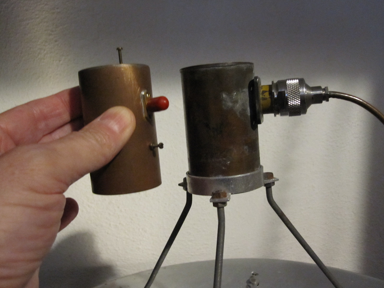

The inside diameter of your tube is 0.74 Lambda; you can read about this in http://www.w1ghz.org/antbook/chap6-3.pdf Your design performs optimal in a deep dish. I do not know the f/D is of a Sky dish but if it is an offset dish it is over illuminated.

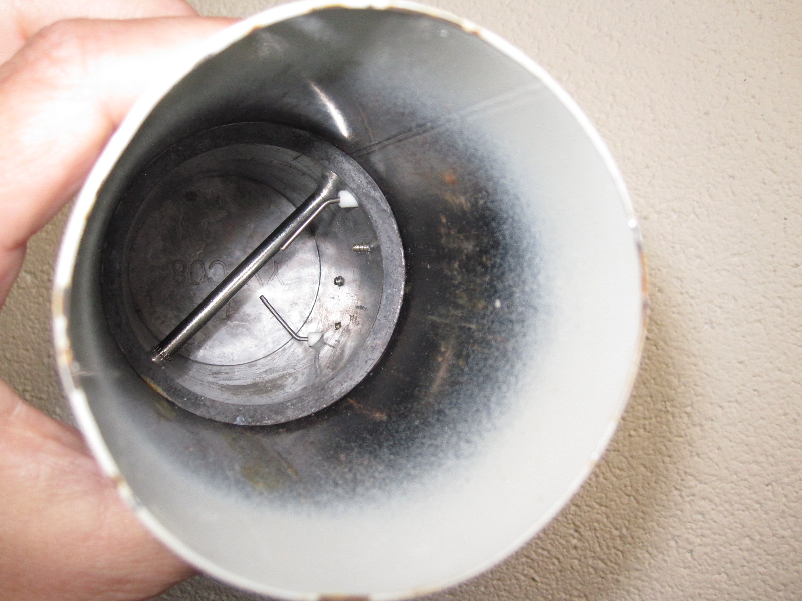

I have two canfeeds for the 6 cm band (with 39mm ID). One with an N-connector and one with an SMA connector. The dimensions are the same but one gave a very bad return loss. Two additional screws solved this but this shows that even when you build in accordance with some calculator, result could be very different. I use this canfeed with a dish with f/D 0.5.
It will work but likely not the optimum result that could be reached (likely a few dB’s less then optimum).
Two canfeeds for 6 cm 39 mm ID.JPG (491.52 KiB) Viewed 6580 times
About the bottom. It is probably not even needed to have a full bottom at all. With my C-band LNB I did some tests and the result of horizontal and vertical polarization looked very similar. This LNB contains two probes (one for each polarization) and it is of course not possible to have the distance from the probe to the bottom for both correct. So a rod is placed at the distance you would expect the bottom, parallel with the probe. For the other probe, this rod is not 'visible' (and the borrom performs as bottom).
C- band LNB.JPG (469.87 KiB) Viewed 6580 times
