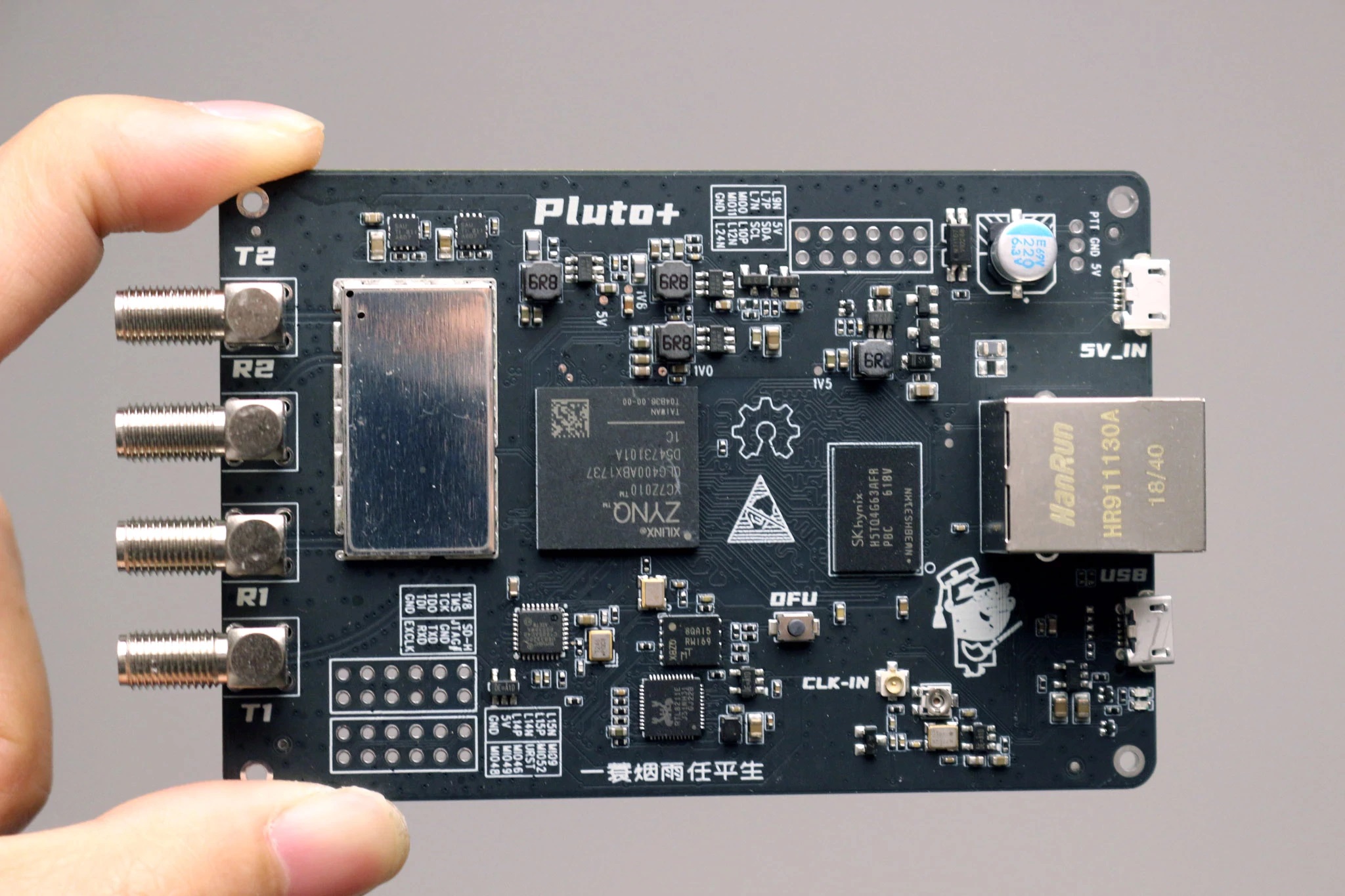

Post by G4GUO » Thu Jul 01, 2021 10:07 am
Just out of curiosity, how many people have a Pluto+ ?

Post by G4GUO » Thu Jul 01, 2021 9:26 pm
It is an option as a replacement for the Pluto and the extra bandwidth is helpful. So far I have used it with DATV-Express and SDR-Console
without any problems. It would need a slight code change to use both channels simultaneously, though.

Post by G4GUO » Thu Jul 08, 2021 8:48 am
Hello Martin,
I can't really answer your questions, but Evariste was given a Pluto+ I think, so he is the best person to ask.
I have not noticed any issues with overheating, but you could always ask the guy that designed the Pluto+
his Twitter account is https://twitter.com/fei666888
The Pluto+ also has an opto coupled PTT line which is hooked to GPIO0.

Post by Pa3fbx » Wed Jul 14, 2021 9:18 am
Strange, a simple question but a lot of different anwers :D ..
Well i do know a few who have a pluto +. Including myselfes..
Evariste has got a free unit but has made no firmware jet or atleast published some thing..
The developper of the pluto + has moved on and not support this unit.
There is a chinese guy who is updating the firmware but has no Ham DATV knolledge and is trying to reachout to Evariste for the code...
Updating the Pluto to Analog 0.33 is no problem but updating to dvb firmware will loose the gigabyte connection..
The onboard PTT is not supported by any firmware by my knolledge..
So yes, a nice piece off hardware witch is worthless without the right firmware...
But still i have good hope for the future..
