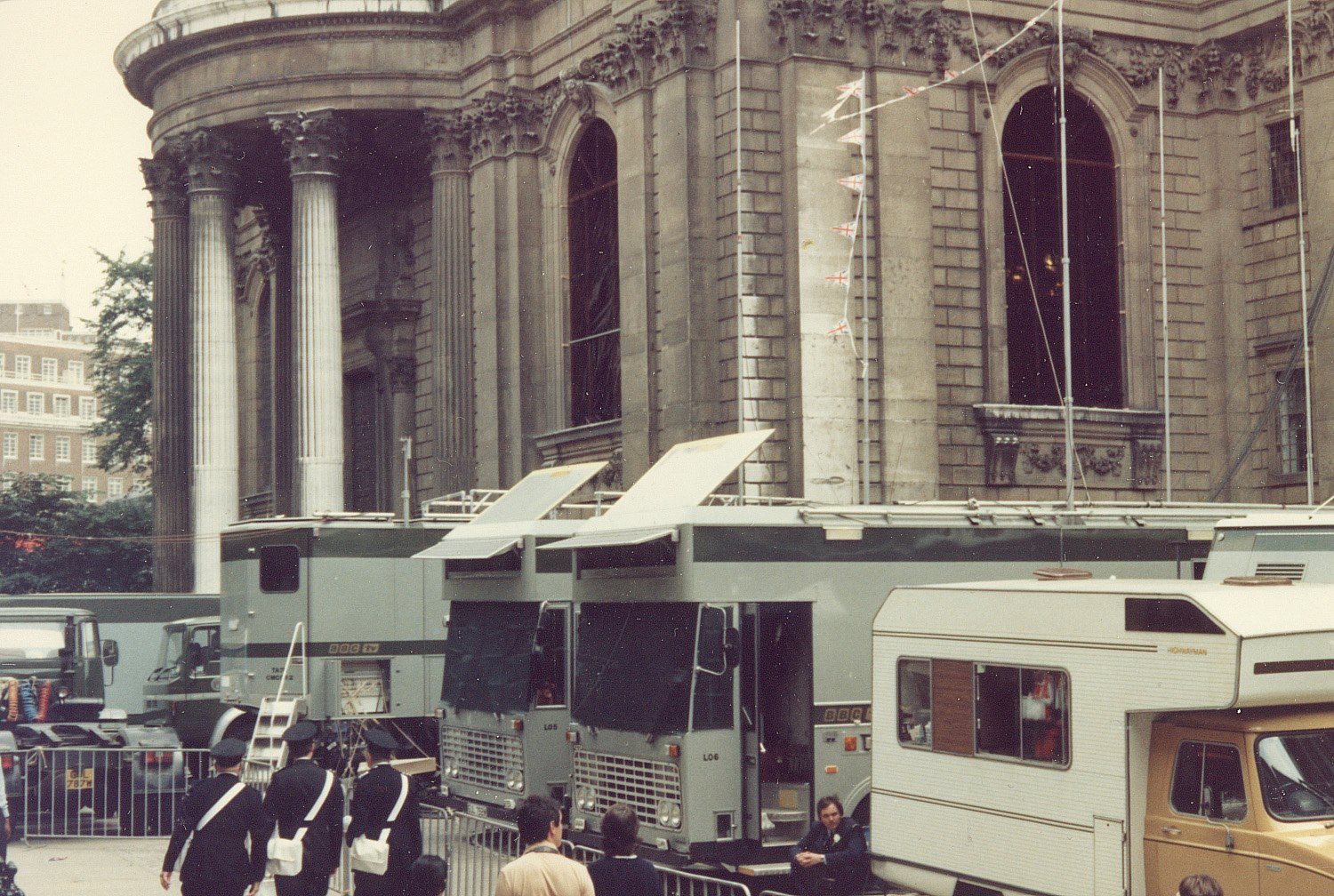

Here is a picture of LO6 at Diana's wedding. (although it might be a newer LO6 )
I was working on LO5 the next one back.
