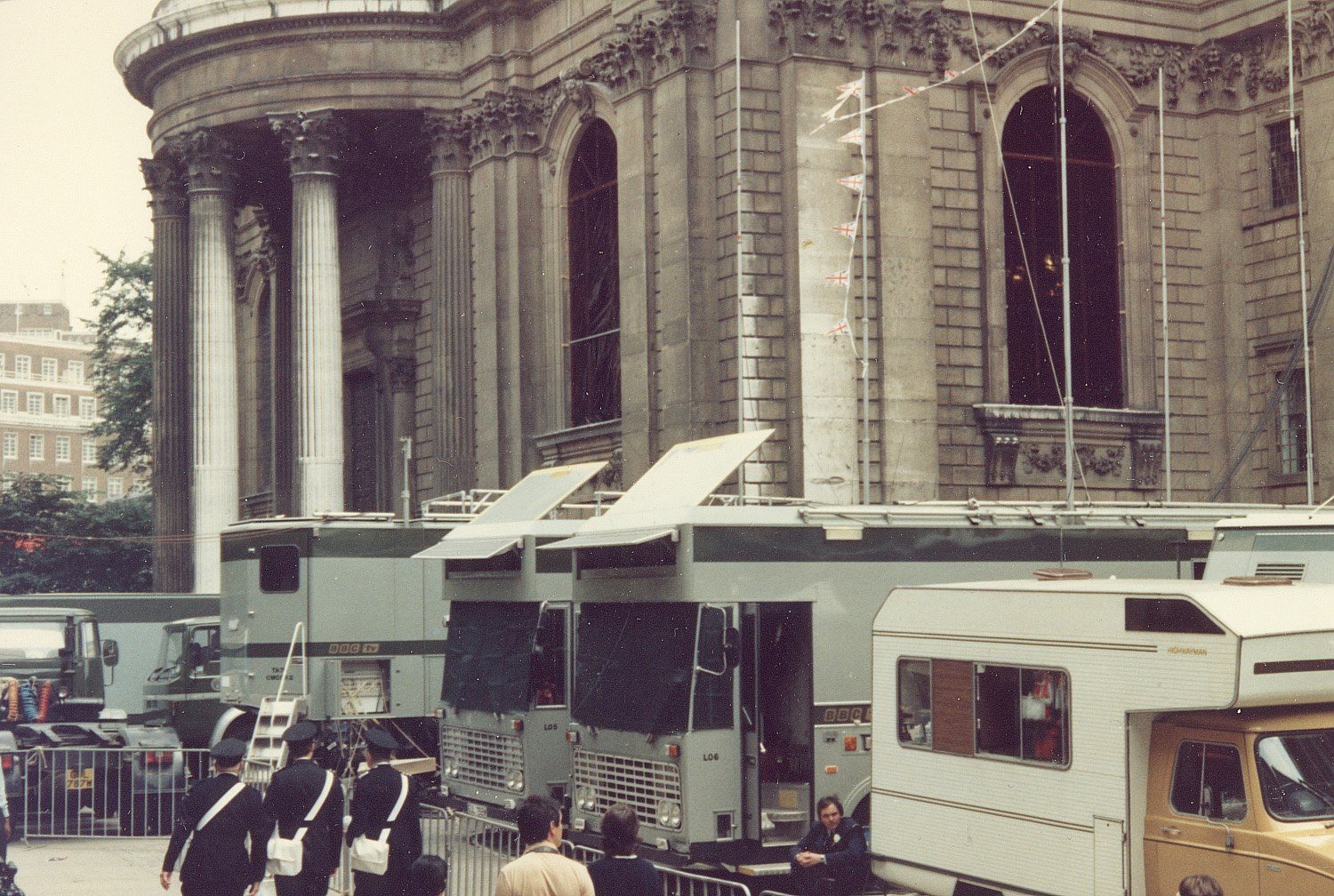

Quote from email I received
'I am trying to help Richard Ellis, who used to work at Pye and was very much involved with the design of the Type II scanners. He is currently involved with the preservation and restoration of the surviving examples, North 3 which is in private hands, and to a lesser extent Lo6 which is being stored by the Science Museum.
Richard is trying to contact vision engineers who used the Natlock or coders on Type II scanners. If anybody still has circuit diagrams or other manuals, it would be a huge bonus. '
Here is a picture of LO6 at Diana's wedding. (although it might be a newer LO6 )
I was working on LO5 the next one back.
Martin G8LCE
