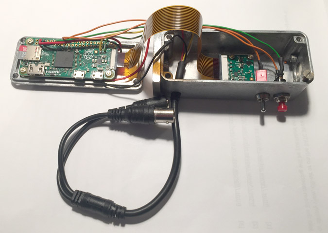

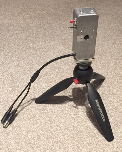

I have just finished boxing up my BATC Video Source as described in CQ-TV 270.
I used a second-hand Eddystone Die Cast Box type 7969 (the smallest in their range) measuring externally 92x28x32mm. I fixed a 7805 regulator to the lid, and mounted the Raspberry Pi Zero above it on spacers. This enables easy access to change the SD Card.
The card selection button and camera switch were mounted in the body of the box, with the camera module looking out of a hole in the "bottom". I used a salvaged flying lead to bring power in from a 2.1 mm barrel connector and take video out to a BNC socket. I tapped a thick piece of aluminium for the tripod thread and fixed this to the end of the box, and added stick-on rubber feet to the lid so that the unit does not scratch the bench when used off a tripod. Photos below.
- Tripod small.jpg (118.13 KiB) Viewed 16548 times
- Closed Box Small.jpg (71.09 KiB) Viewed 16548 times
- Open Box Small.jpg (97.91 KiB) Viewed 16548 times

Nice project Dave,
What is it like temperature wise? does it get hot inside there or havent you run it for long periods?
I wonder if the board could be mounted upside down, and a small aluminium block touching the processor chip to act as a heat transfer block?
Just an idea, but great little project for a pi-zero i have kicking around.

Hi
I don't foresee any heat problems at all. The RPi Zero only draws about 150 ma without the camera on and 190 ma with the camera. So max dissipation on the Zero is about 750 mW. So no need for a heatsink at all.
The 7805 regulator of course might end up dissipating 1.7W with a 13.8 v supply and the camera on - which is why it is bolted to the box lid.

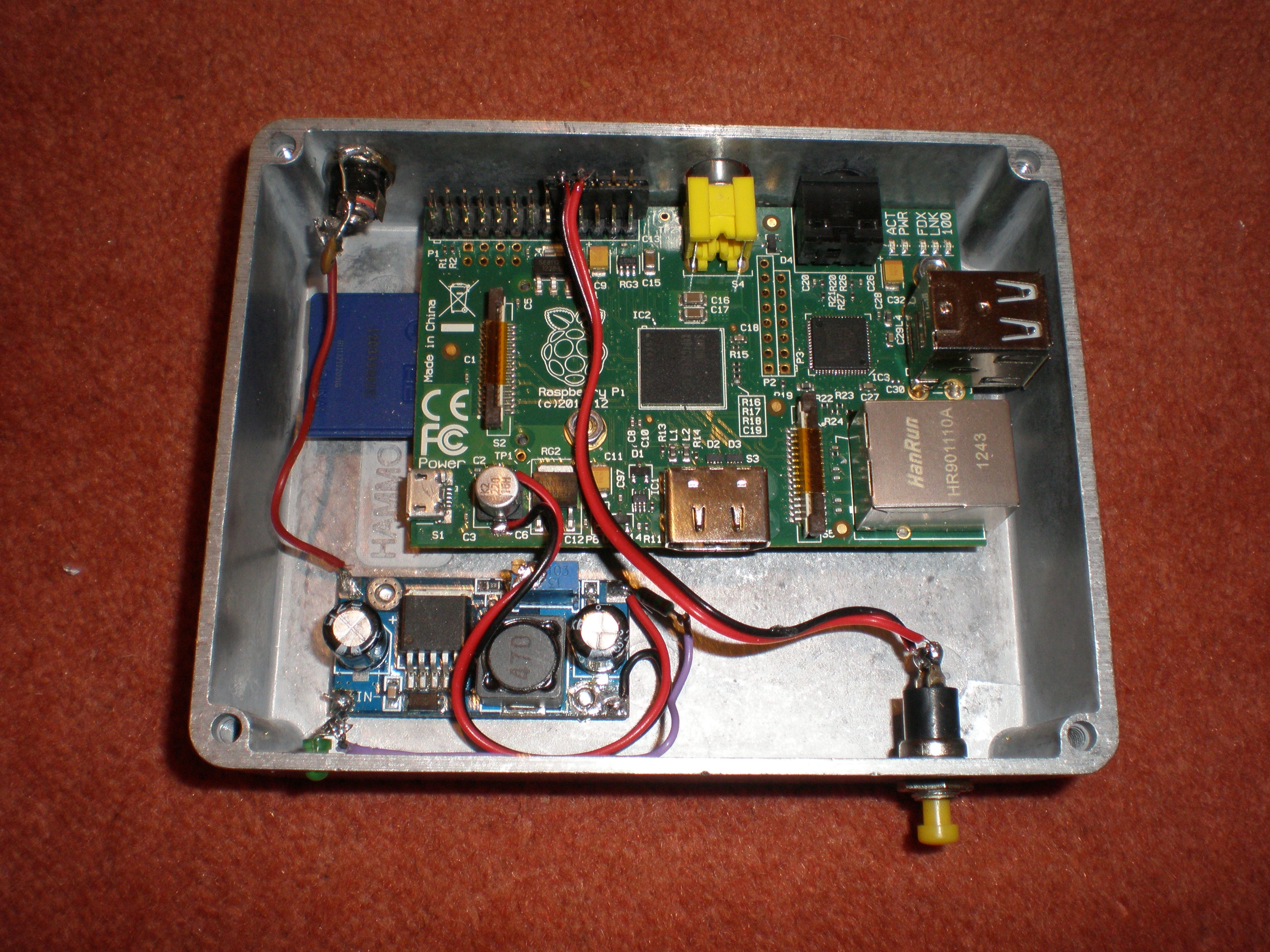

Here is a photo of my version of the video source.
I knew I kept my original RPI model 1A for a reason. Now I Know what it is. It also has the benefit of having the video coming out of a phono connector rather than the illogically wired TRRS connector of later versions. A clue to it's age is the full size SD card!
The RPI and the 12V to 5.2V dc/dc converter fit nicely in the box. I didnt need the source to have a camera which saved some space
G4FRE
