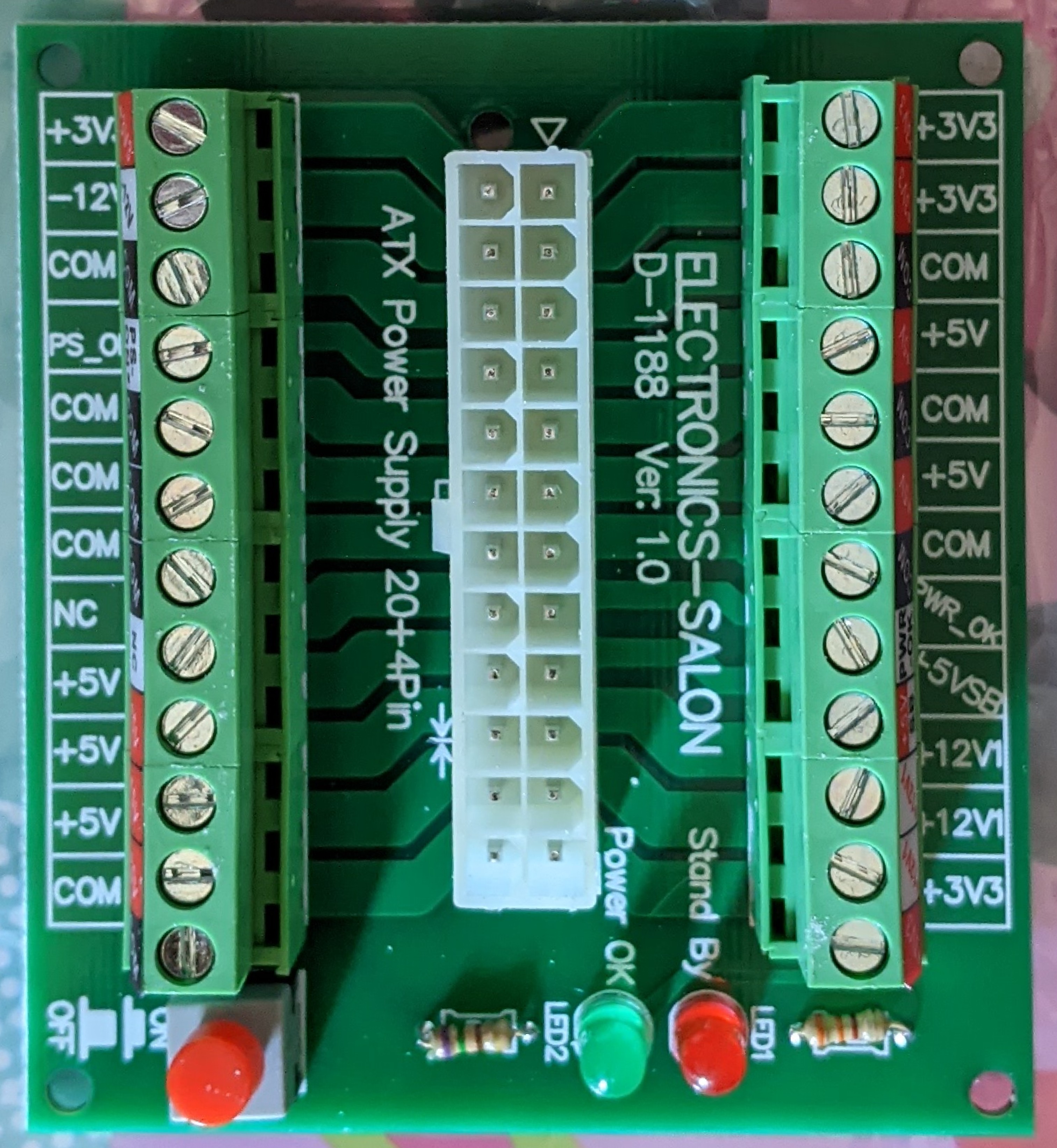

Post by KA5BBC » Sat Sep 26, 2020 3:58 pm
I did find a fantastic breakout board on Amazon for $10 which has traces thick enough to handle all the current an ATX supply can give..
Andy, KA4BBC/MM0BQV

Post by KA5BBC » Sun Sep 27, 2020 9:30 am
FRANCOIS F1CHF wrote:
Sun Sep 27, 2020 8:29 am
hello
did you keep the item number on amazone site ?
thanks
This is Amazon US but it should be easy to find..
https://www.amazon.com/dp/B01NBU2C64
