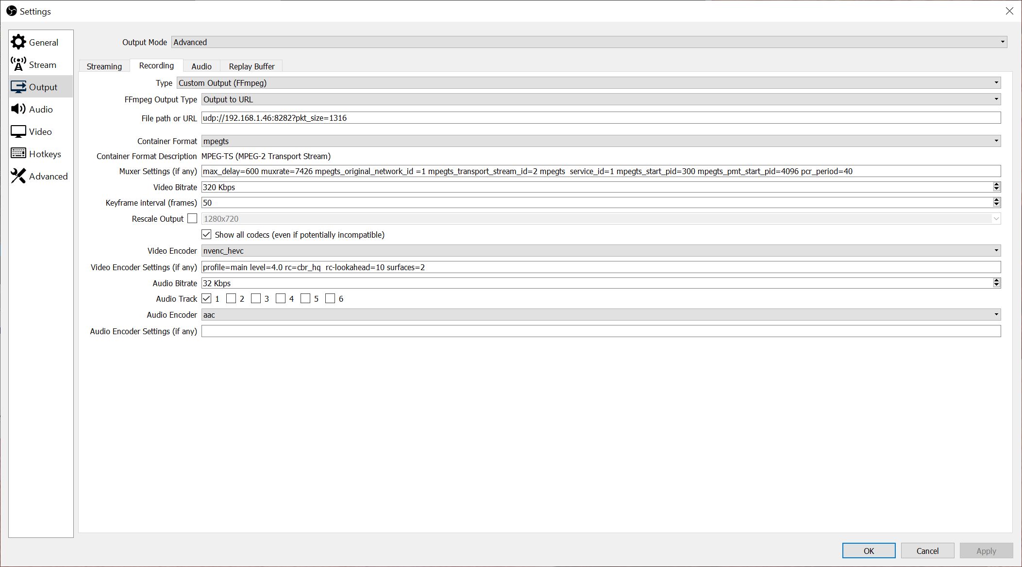

I have upgraded the shack PC with an Nvidia GTX1060 graphics card (and a 750 watt PSU).
The plan is to use the PC running OBS / Vmix to drive the IPTS input on Portsdown but I'm not sure this has been documented anywhere yet so would appreciate some pointers on the following - I'm happy to write it up on a wiki page if useful for anyone else.
I can see the Nvidia hardware encoder in OBS but only H264 - do I need more drivers etc for H265?
Where do I select UDP out and put in the target address?
Once I get OBS sorted, I will then look at Vmix :-)

That's what I am doing. You need a profile and settings.I suppose you want to know what to do.
max_delay=600 muxrate=7426 mpegts_original_network_id =1 mpegts_transport_stream_id=2 mpegts service_id=1 mpegts_start_pid=300 mpegts_pmt_start_pid=4096 pcr_period=40
profile=main level=4.0 rc=cbr_hq rc-lookahead=10 surfaces=2

Of course, it's under "recording" - why didn't I look there rather than the "streaming" tab :o

You need a script on the portsdown to capture this add the metadata and modulate. In my case, I am using a Pluto with the script running on it.
