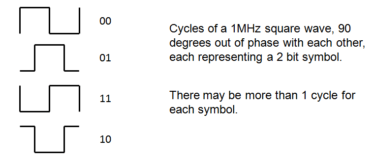

The test system is effectively digital QPSK. 4 digital carriers are generated inside the Raspberry Pi Zero. These are 90 degrees out of phase with each other. QPSK works by modulating 2 bits at a time (a symbol) so each pair of bits selects one of the 4 carrier phases and outputs a few cycles of this on a digital port. This happens at the symbol rate, so the phase of the digital output can potentially change for each new symbol.
The test system in the photos was using 4 cycles of 1MHz carrier per symbol, which gives a symbol rate of 250kS. The spectrum of the RPi output is effectively 'ugly mode'. This doesn't matter at the transmitter because it is being driven with square waves, but the received spectrum is likely to be something similar, rolling off as the frequency increases.
At the receiver, the carrier phases could be recovered and the 2 bits representing each phase be applied to a standard QPSK modulator to be received by MiniTioune. I think it would be preferable to treat the received signal as analogue (a 1MHz carrier) and mix it up to a frequency that MiniTiouner can receive and let MiniTioune decide what the 2 bits are.

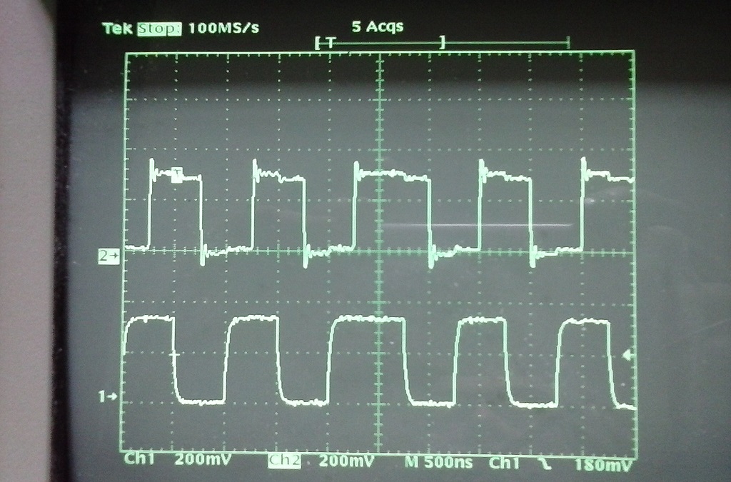

Trace 1 is the digital output of the RPi. The change of phase for a new symbol can be seen at the centre of the screen. Trace 2 is 90 degrees out of phase with trace 1, for local testing.

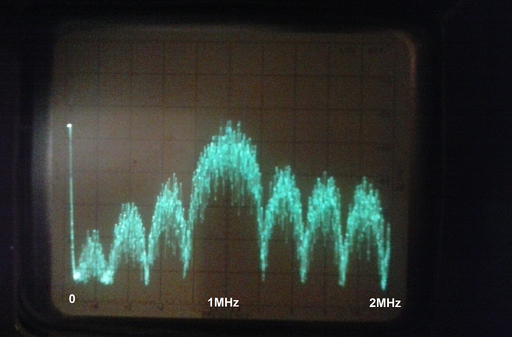

The spectrum of the digital output above is effectively 'ugly mode' on a 1MHz carrier. The received spectrum should be similar, rolling off as the frequency increases.
