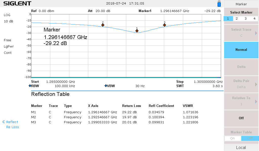

I'm making JVL 23cm quad loop antennas at the moment using JVL's program to design them. As I couldn't find much about measured performance of the narrowband (NB) and wideband (WB) designs, I'm going to try both. I'm building them with aluminium strip elements (apart from the DE which is copper).
My first attempt is a 26el narrowband design for 1296.2MHz on a 2.2m long 20mm square boom. As built, its minimum return loss was on 1301MHz; with some flattening of the DE it's spot on 1296 with Rl of 30dB indicated on my Siglent SA. The real number is less than that as I have some feeder loss. Usable bandwidth (arbitrarily taking Rl at least 15dB) is about 6MHz allowing for the feeder flattering. It has directivity and receives a local beacon when 2m off the ground, so I guess it works.

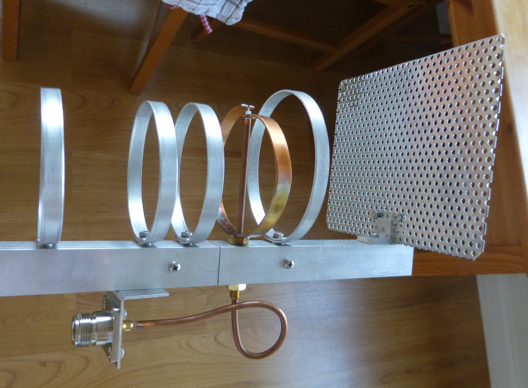

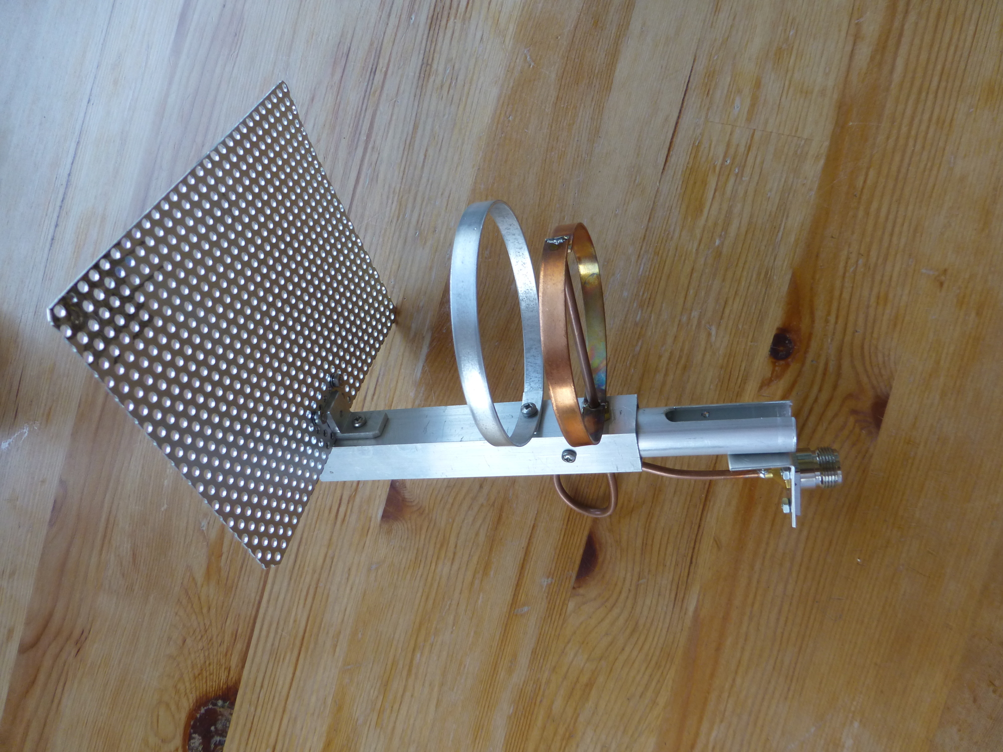

Good to hear about G3JVL; I'd have trouble remembers details of something I did 40 years ago. I'll start by making the log periodic feed as directed by the software and see what happens.
For the record, here's some photos of the feed end of my narrowband 1296MHz loop quad, and the return loss sweep (knock a few dB off the values shown).
Chris G3WIE
Chris G3WIE
- 1296 NB Rl.png (17.13 KiB) Viewed 7742 times

Don't quite understand, preview showed 3 pictures, Submit and 2 vanish. Try again..
- 1296 NB lq.JPG (644.64 KiB) Viewed 7741 times
- 1296 NB feed.JPG (1.3 MiB) Viewed 7741 times
