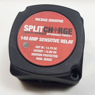

Last idea is a split charge kit with battery / batteries on frame bolted in the back of car, won't charge till car started,
they will still benefit from a good 3 or 4 stage charge from time to time as car alternator usually a little basic.
