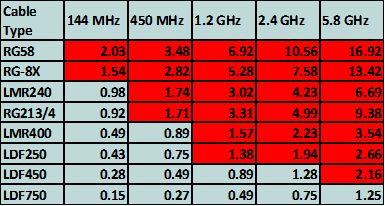

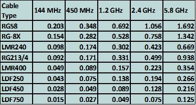

For portable, unless it is a long length your best option for 2m is RG213. There are better low loss coaxes but they tend to be less flexible or prone to damage when being continually coiled and uncoiled. 70cm probably the same for short runs but the loss of 10m of RG213 is 1.7 dB which is getting significant.
At home, again, only if significantly long, LDF4-50 or LMR-400 are good for the long leads, but not ones that have to flex. If you have a rotator you need to use flexible cable for the rotator loop, RG213. Don't be afraid of joints, as long as they are done properly and there are not too many of them. The loss should be under 0.1 dB and the return loss better than 20 dB if done right. Invest in high quality connectors, Cheap ones are probably not good enough. If you have any PL259s, throw them in the bin.
I like to keep losses below 1 dB. Here is a table of the loss per metre of typical coax for 2m to 6cm. It may get WAS garbled by the forum but you should be able to work it out.
This is for a typical 10m length (above values x10) which illustrates that on 2m RG213 should be OK. At UHF and up or for longer lengths you need something better. LMR400 is a good choice because it is cheap and connectors are readily available.
