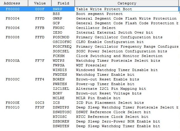

What are the PIC chip configuration settings needed for picdream II? I just have to programme the chip to try mine out
G4FRE
G4FRE
- picdream2_cfg.jpg (83.88 KiB) Viewed 8332 times

Sorry for the late answer, due to very far and long vacations
The configuration is included in the .hex file.
So if your are using a Pickkit 3, just load the .hex file after declaring the chip name.
73's
Alain F1CJN

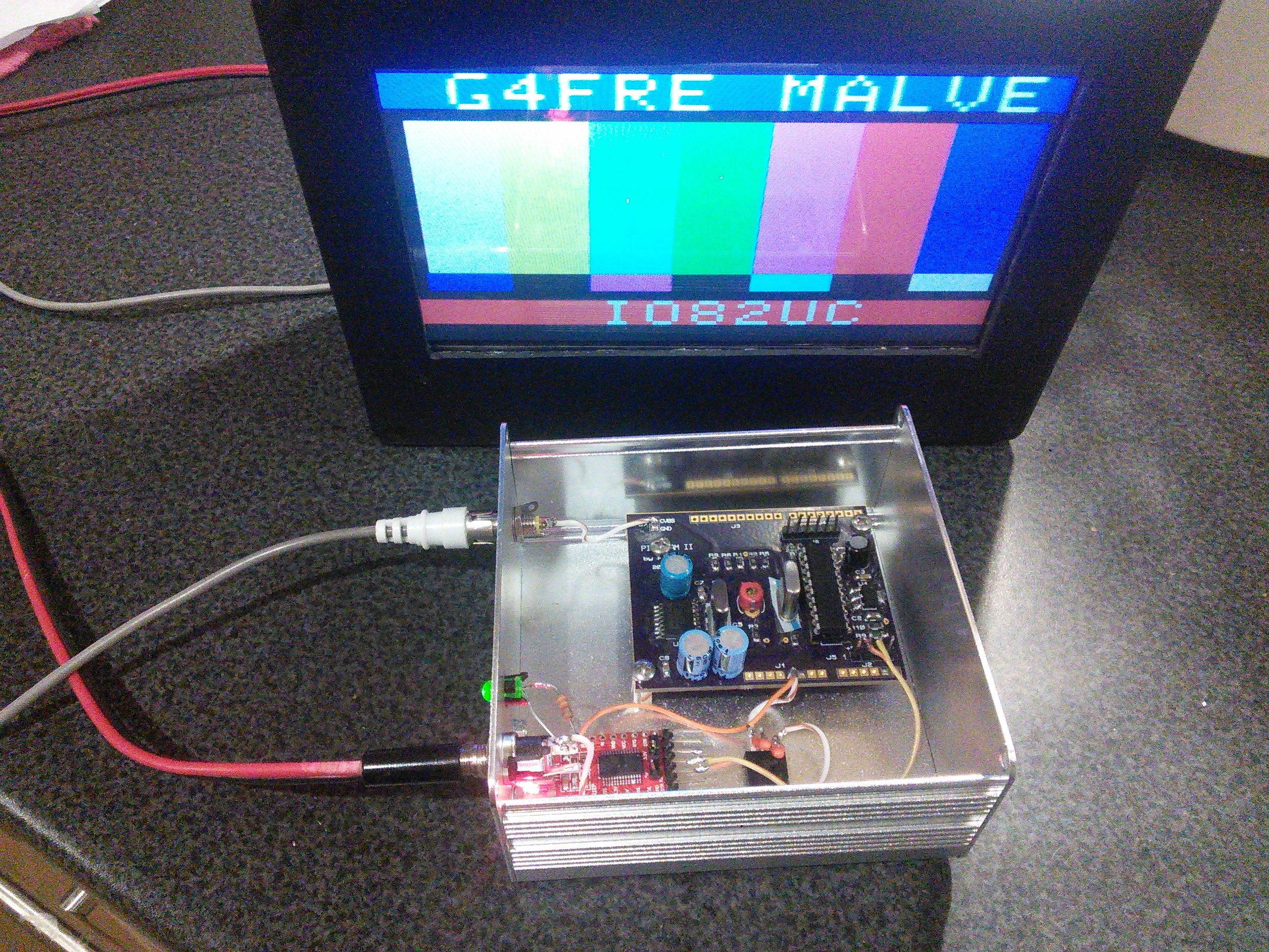

With the hint from Barry about insulating the crystals I got my Picdream II working.
Like Barry, I also programmed the IC in an external programmer. I tried the ICSP port on the PCB but the PICKIT went into overcurrent alarm as it was powering the whole PCB, not Just the PIC
The only other issue I had was with the USB to serial converter. If your USB interface produces +3.3V levels you can connect it to J5 and the unit works. If your USB interface produces +5V levels, connect it to j2 and the unit works (the clue to this was that the Arduino Uno is 5v and uses J2). If you connect the +5V levels to J5 the unit doesn’t come out of reset, and run the program.This is because these sort of USB interfaces idle at +volts so the pic has +5V on the serial input but only 3.3V on its supply rail so it latches up. Luckily no damage was done! Failing having the documentation, It is easy to tell which level you have by using a voltmeter to measure the TXD out voltage from the usb adaptor. It will be +5 or +3.3V. If its near 0V the level is inverted and the interface cannot be used (I know… I tried using the interface off my kx3 which does this)
G4FRE
G4FRE
