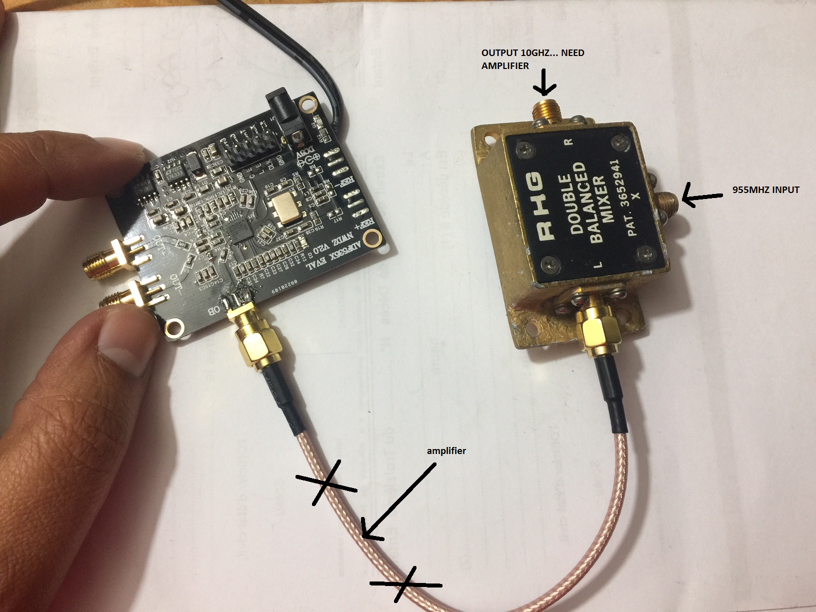

Re: Question about double balanced mixer
The other problem you will find is that the output of a Chinese ADF5355 board is only about -8dBm from the doubler port.
That is not enough to drive the LO of the mixer you have, it will cause poorer IMD performance and a far higher conversion loss
and may not work at all.
Hi Aldo
There are 2 ways you can get on to 10GHz from 900MHz - the first is the "build it yourself" approach exactly as you described in your previous posts and the ADF43xx is the best oscillator solution but you will need amplification on the LO and the final signal.
The other way is to buy a unit (new or secondhand) from DB6NT or other manufacturers. There was a talk on 10GHz at the BATC CAT17 - you can watch it here: https://www.youtube.com/watch?v=L-6bKaFhkEY
73 Noel - G8GTZ
73 Noel - G8GTZ
Hello do u think about this ? if yes wich amplifier must use pleaseg8gtz wrote:Hi Aldo
73 Noel - G8GTZ
question : LO and mixers for analog and digital are same ? !!
- photo mod.JPG (513.68 KiB) Viewed 7259 times
