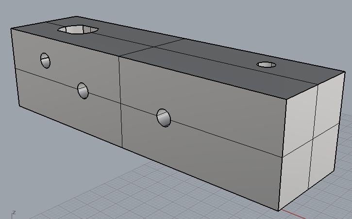

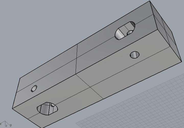

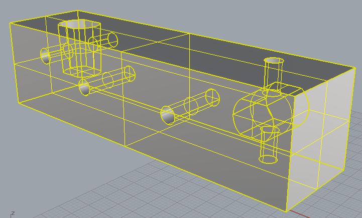

DigiTwist is an experimental 2 axis satellite tracker, primarily for the HamTV transmitter on the ISS. 2 broadcast satellite dish positioners are connected together and are controlled by a dual Diseqc pcb.
I've started to put details on the BATC Wiki: https://wiki.batc.tv/DigiTwist
Circuit diagrams and software will appear shortly.
The most difficult part is the drilling of the complex shape of the positioner rotor arm in the joiner bar. Quotations are currently being sought for production of a batch. To gauge demand, it would be helpful to register an interest by PMing or emailing me. my callsign at yahoo dot com

3) the "joiner bar" : currently you need to make one for yourself, there is no even such bar ready available for TM-2600 M3 motor. that I guess is another point to just use another motor model altogether. in fact for TM-2600 M3, the joiner bar contains complicated shapes that need to be cut in the metal, which is disadvantage in making such bar easily. So, by taking measurements on my TM-2600 M3 motors and with help by Brian (giving me some measurements of the "proof-of-concept" bar they made), I designed (with help of a friend) computer 3D model in STEP format of that bar, which is compatible with HAAS CNC milling machines. Maybe that's actually machine-independent, I don't know, not an expert in the field. However, manufacturing even a single piece turned out to be very expensive and I am looking for another manufacturer with such machines. I don't share the computer model I made here, because it's not proven to be correct - that will be clear after at least one piece is made. Anyone with access to CNC machine compatible with 3D model in STEP format, feel free to contact me. I am attaching few pictures of my 3D computer-generated model.
