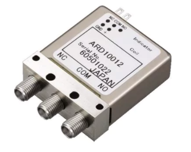

by M0YDH
Hello Noel
Further to your advice, I found that Transfer relays with SMA connectors to be better value on Ebay and struck lucky with the pair pictured below which I purchased in person from a trader in Wolverhampton. I went to meet Stew who turns out to be a broadcast radio and communications engineer with a house full of surplus gear that he has to sell. [The 1.5kW dummy load was as big as a labrador dog!]. N.B. he has some super inter-digital filter that he plans to re-align for 437MHz on his VNA
The 5 port 4 way was described thus:-
DC- 12.4GHz 5 Port 4 way 24V SMA Coaxial relay 850W - 85W (@100MHz -12.4GHz)
This is a used but good condition 4 way changeover relay, 24v coils, plus revertive contacts to indicate the made position if switch-over confirmation is needed.
The specs are at http://www.rlcelectronics.com/products/ ... eries.html
with a power graph at http://www.rlcelectronics.com/index.php ... id=5&id=61
Would you be able to add notes on revertive contacts and their application to ensuring safe switching on the Wiki ?
The other relay is a "SR-TC relay, plus an explanation of the numbering system is at;
http://www.rlcelectronics.com/products/ ... eries.html "
I think I'll only need one aerial on 5.6GHz when I build that rig at some point next year!
David M0YDH
Re: Coaxial relays and Mini-kits amplifiers
Posted: Sun Oct 01, 2017 3:01 pm
by g0mjw
Sounds like a successful spree.
The 3, 4 and 6 way relays are relatively common and not too expensive because people don't realise what they are. However, they are not usually transfer relays, they connect the centre port to one of the outer ports. You need to be careful using them for TX/RX switching as there isn't really anything to prevent you from activating more than one port at the same time, which means you could connect the TX to the RS. Some sort of fail safe is advisable but these are best suited to switching between multiple antennas or signal switching.
The transfer relay is ideal for what you are trying to do. It does the job of two SPST relays (take care the isolation is sufficient). Be careful with power ratings, I have seen these melted on 10GHz in key down modes. Stick to less than 10W and it ought to be OK though.
I don't know if your relay is a latching one. If it is W6PQL has a PCB to drive it.
