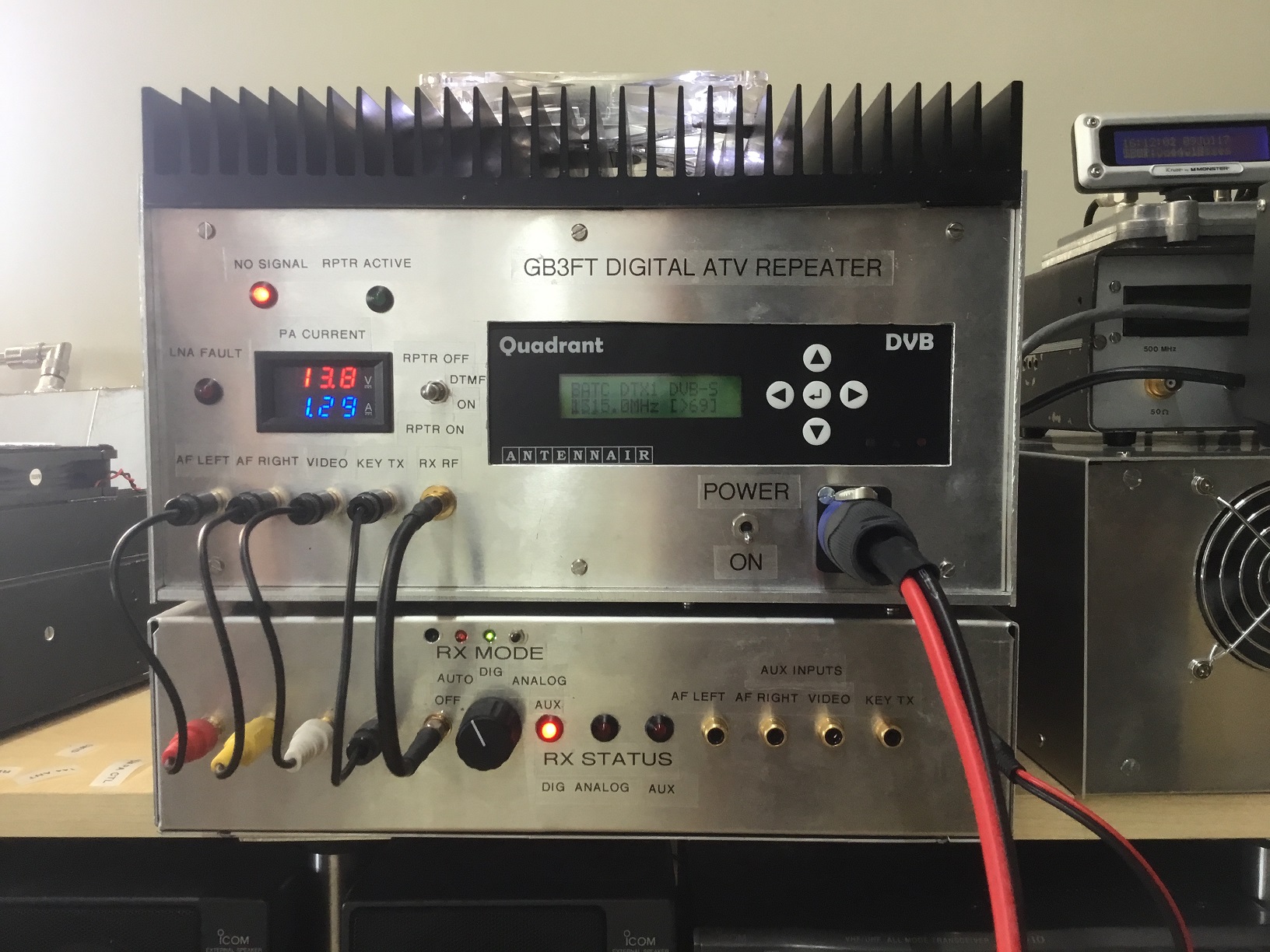

GB3FT is coming along nicely and under going tests using clause 10 from my qth before being installed at it's final location.
I've created a qrz.com page for it which contains a summary. I'll add more info to it as time permits.
Also in the coming months expect to see an article about its creation.
The intent is to foster more activity in the North West and maybe eventually link up with other repeaters.
Many thanks to GM4ISM, G3ZGZ, G3RFL, G3WGU, G0AIN, G4EWJ who all contributed in someway to the creation of GB3FT.
Now we continue to wait for license approval.....
- GB3FT Front 50.jpg (536.24 KiB) Viewed 9495 times

Re: GB3FT - A new DATV repeater for Fylde coast and surrounding area
Nice job
Just a suggestion about the 3 AV leads that connect to top and bottom box
Generally thin leads don't have much copper in them and can cause degradation of picture quality
The Yellow video lead in particular may benefit from having some good shielding
To protect it from some of the nasties that live in a repeater hut
It may do nothing, but it's good protection
A piece to RG6 Quad or RG59 Dual with F types and a couple of F to RCA adapters would be what I'd use
Thanks for the tip re RCA leads, a similar thought had passed thru my mind as well, however fortunately the repeater is located in a fairly benign location (loft space) and is easily accessible should the need arise.
Bigger problem is the performance of the 146.5MHz rx which currently seems 'deaf'. Not sure if the rx is getting blocked or if the antenna is not performing as it should, hopefully will get it sorted out before too long.
73 Tim
73 Tim
