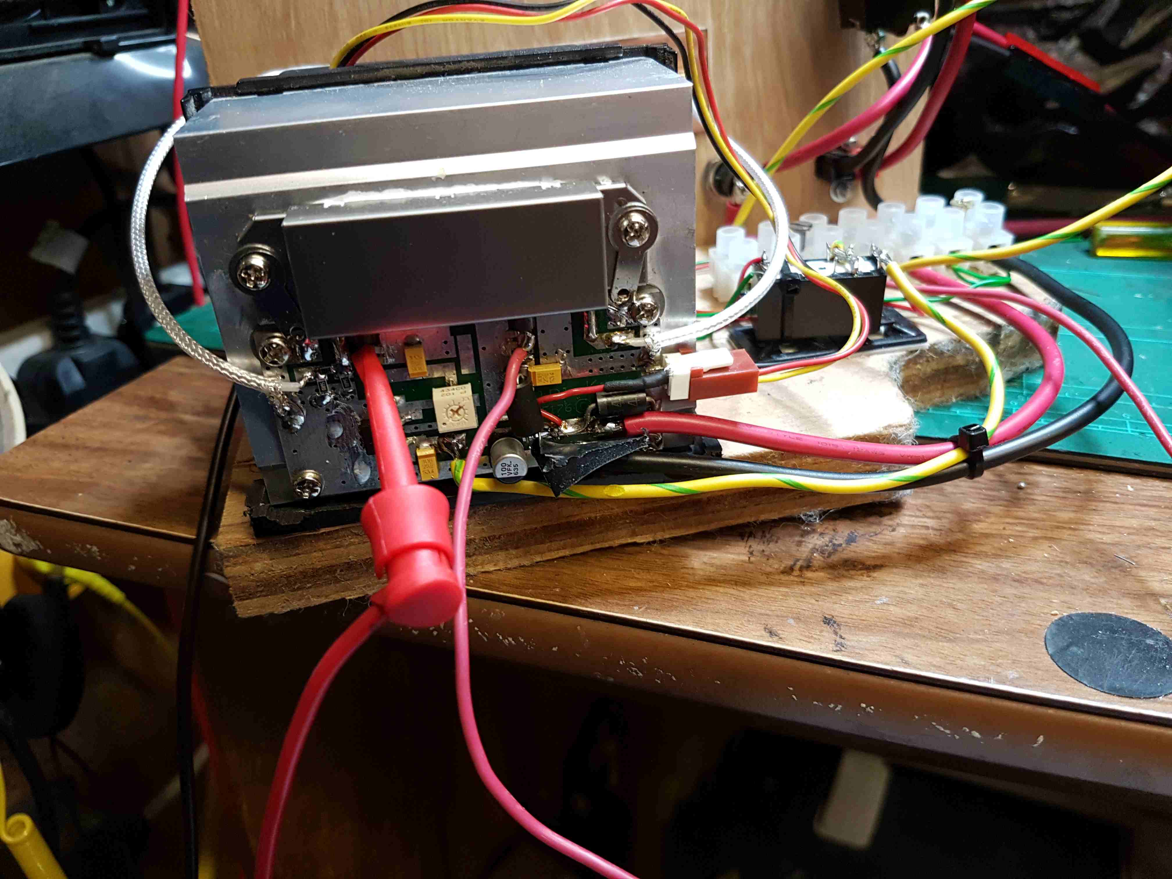

Hello all
I think I've reached a successful conclusion to the amplifier build. As there was no advice elsewhere to expand on the instructions I made a film of the steps I took and the results. I'd added an arbitary 20dB attentuator stage in place of the 0ohms link per the instructions so from circa 100mW out of the FT817ND through the attenuation and out of the amp at 400mW seems satisfactory for now.
The film is here:-
https://www.youtube.com/watch?v=RoLburL23VA
Any obvious errors?
Hopefully our club's new analyser will have leads, pad and adaptors after National Hamfest shopping and I can complete setup. I'm making a G4KLB controller for the PE4032 programmable attenuator that's on the slow boat from China. I hope to then see spectrum from the Portsdown and find the level of drive.
Any recommended cases or enclosures for these amps when mounted on old computer heatsinks like mine?
David M0YDH

- Mini-Kits RA series UHF amp under test at M0YDH
- 20170927_RA series UHF amp under test.jpg (362.38 KiB) Viewed 9048 times
Re: Mini-kits Amplifiers
Hello David
Nice build! Did you reach a conclusion about what enclosure to use? And how deep roughly is your heatsink from the plate where you've fitted the module and PCB, back to the fan?

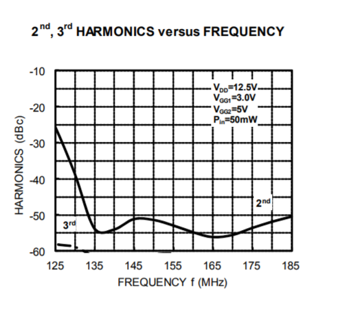

Hi Jules,g0nzo wrote:Excuse me hyjacking this thread....
Does anyone have any words on how good the internal LPF is on these modules?
I have a 2mtr and 70cm version of these and about to start assembling. Wondering how clean the o/p from the bare modules are
Jules
Their filtering is not quite good enough. You might consider glancing at the device data sheet it you can find time. The 60W 2m module for example presents this graph.
As you can see, it's the second harmonic that is only about 50dB down. The table at the start indicated -35dBc which is much worse, but perhaps that's at maximum output. If you use the 43 + 10 log P rule of thumb, at 17 dBW (50W) you need another 10 dB. Of course if you are running it at 5W then chances are, the harmonics will be low enough but its good practice to put a low pass filter on the output, a simple 3 or 5 pole LC filter ought to be sufficient and would be pretty low loss.
