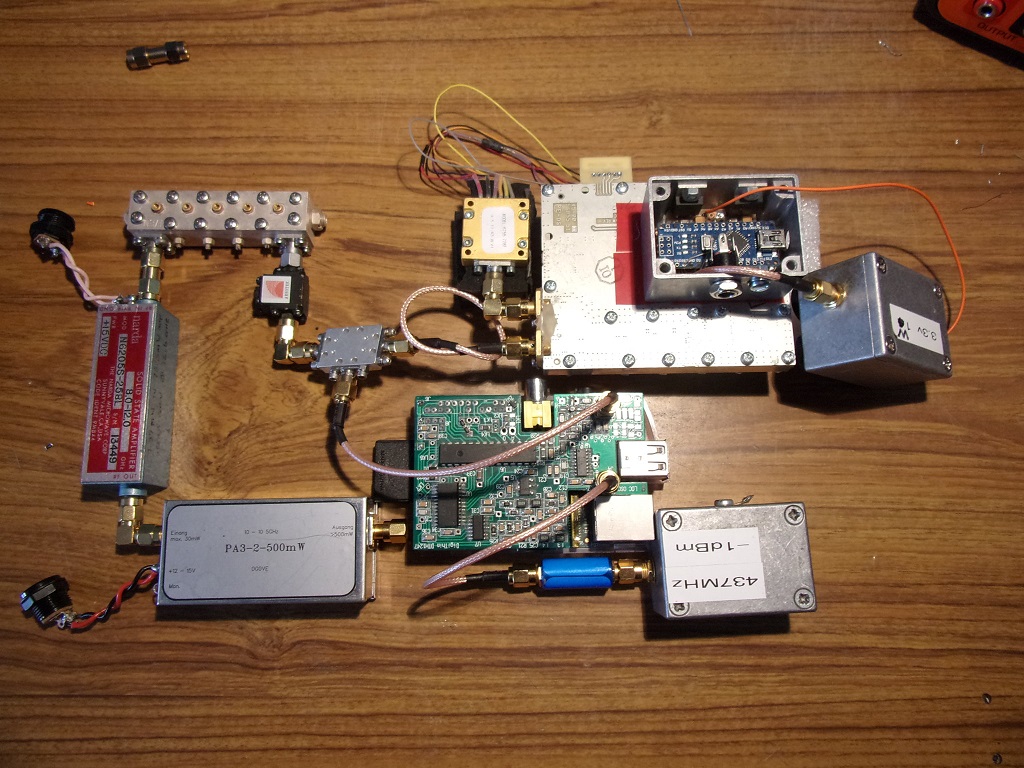

I'm putting together a 437MHz to 10GHz transverter at the moment. For simplicity and to avoid soldering tiny components, I'm using a packaged double balanced mixer MC64PG-11. There are plenty on eBay - cheapest is £38. MiniKits have a range of the bare mixer devices, but few go to 10GHz and some are hard to solder.

I have my YIG oscillator / MC64PG-11 mixer based 10GHz transverter working in lash-up form, but the close-in phase noise is not good and I want to use it for NB as well with the the FT817. I also want to go the ADF4351 tripler route. I've listened to the 3rd harmonic of the ADF4351 on 10368MHz through an Octagon LNB and I can't hear any unexpected noise when I tune across it on SSB.
The harmonic output of the ADF4351 is appreciable as it stands. I set it to 3456MHz and fed it directly into a 15dB horn and was received on 10368MHz by G3UVR 5km away. I'll need extra gain for the LO and after the mixer to drive the DG0VE amp. The only MMICs I've found that go to 10GHz are NLB-310. Minikits have them at about £4. Mouser have them, but more expensive. Perhaps BATC would consider stocking them.
