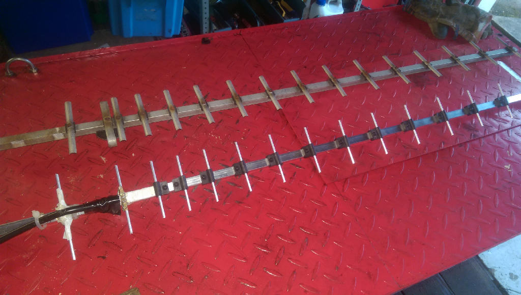

2x Aerials.jpg (103.97 KiB) Viewed 8073 times
The far one is my unknown AE.
The near one is basically a commercial AE but it's had the Radiator and reflector modified (reasons unknown), so how can I check that they are correct?
The severnside is up a pole..
Dah-di-dah

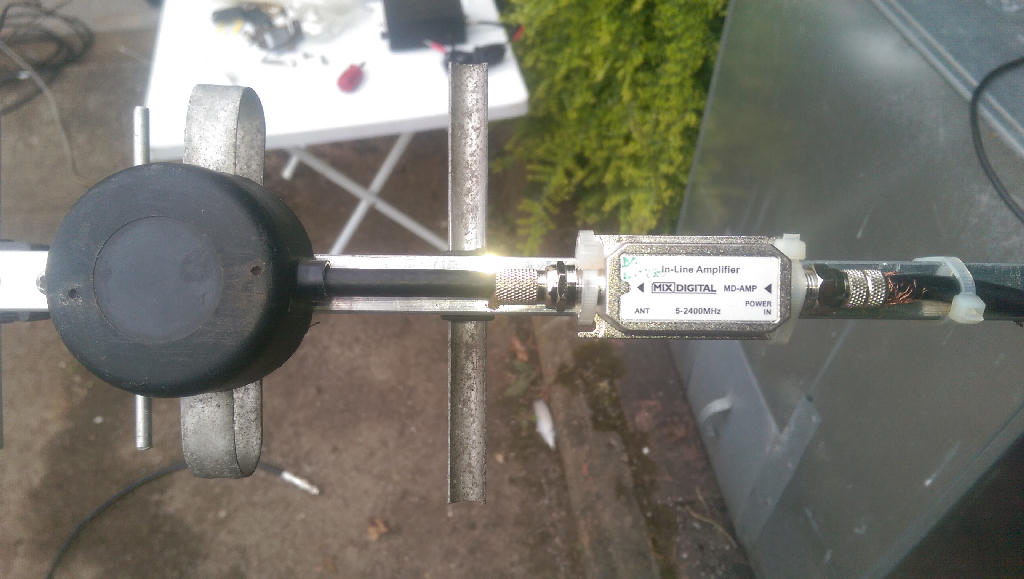

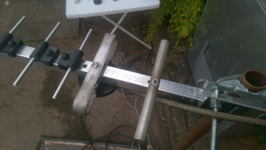

I've not heard of a Sandpiper, but I canibalised the far one yesterday and used the Folded Dipole and reflector to rebuild that one, it did improve it no end (and tidied up it's looks too.. They were still loose at this point to allow me to play and find the right spot to drill and secure them.
[attachment=2]IMAG1489s.jpg[/attachment]
It had been the best AE for RX during my testing yesterday, So I have built it as an RX AE for my mobile set up and fitted a Masthead Preamp.
[attachment=1]IMAG1490s.jpg[/attachment]

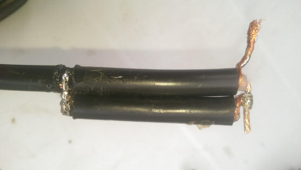

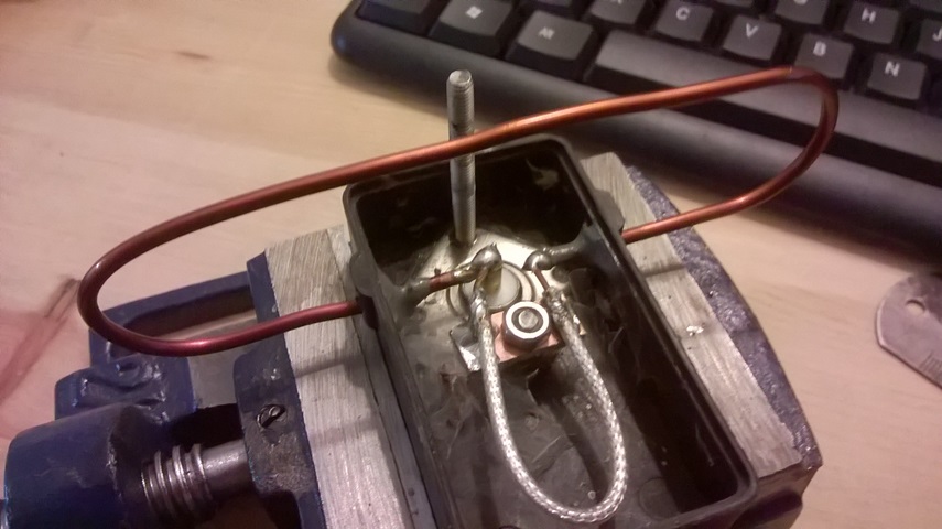

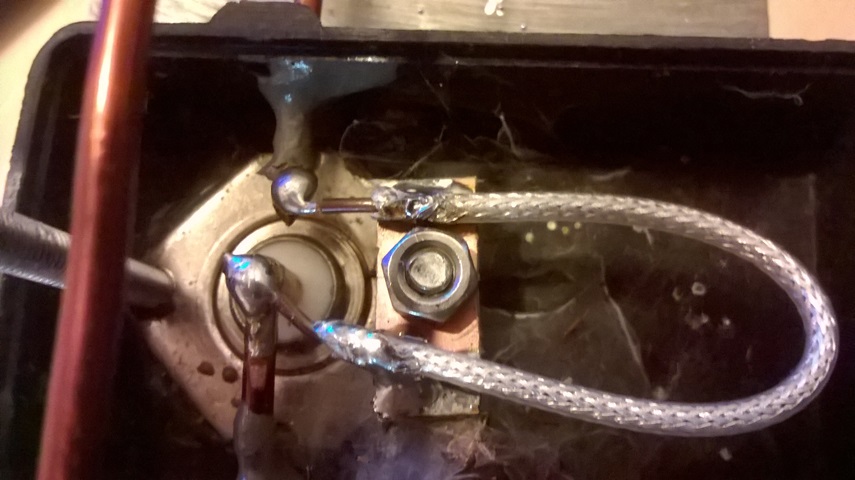

I made a Balun this morning for the TX AE, everything went well, except, there was less RF output with it fitted... Typical
[attachment=0]IMAG1491s.jpg[/attachment]
It's my first ever attempt at any sort of matching, so I daresay someone might come along and pont out the simple thing I have overlooked that stops it from working as it should.
All my tests have been relative, I either got an improvement or things got worse, so my AEs still might not be brilliant, they are simply not as crappy as they were.

How come there is no direct connection to the outer of the N Type? Although it does appear to be potentially connected to the Boom when assembled.
