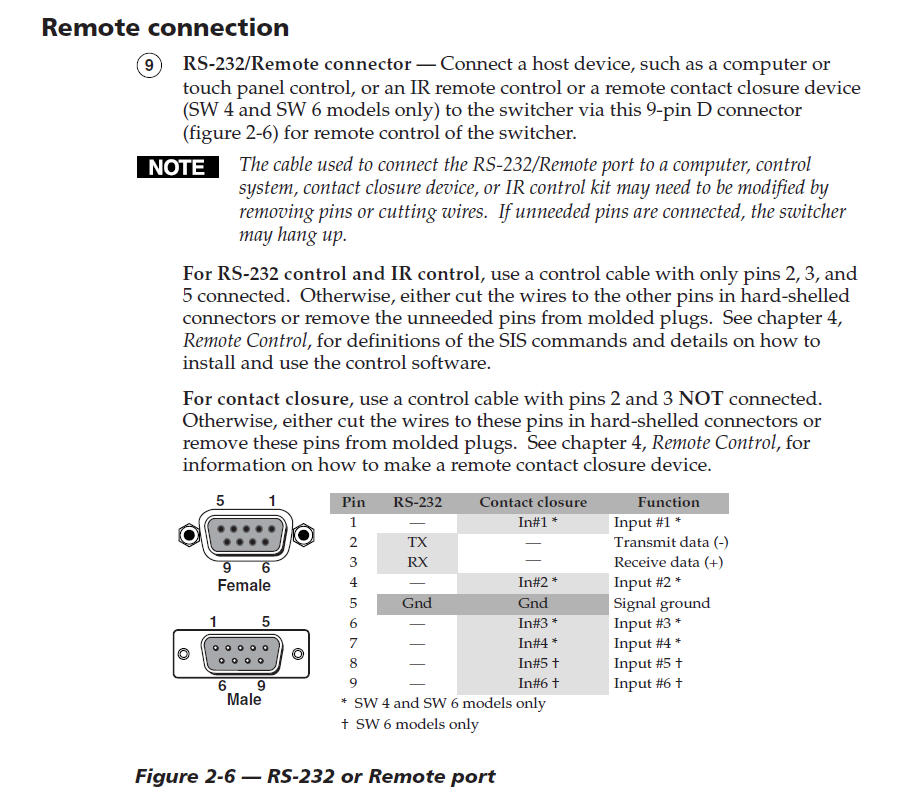

I'm using an EXTRON SW 4AV RCA Four Input Composite Video & Stereo Audio Switcher Ebay 282093227531.
You just ground the inputs to switch video, so by keeping CH1 grounded for test card input the other 3 inputs will override as valid signal comes in from various lock lights / Analog decoder on various Rx's. then switch back to test card as default, other EXTRONS may not have that simple override a grounded input feature, so will need a different approach.
