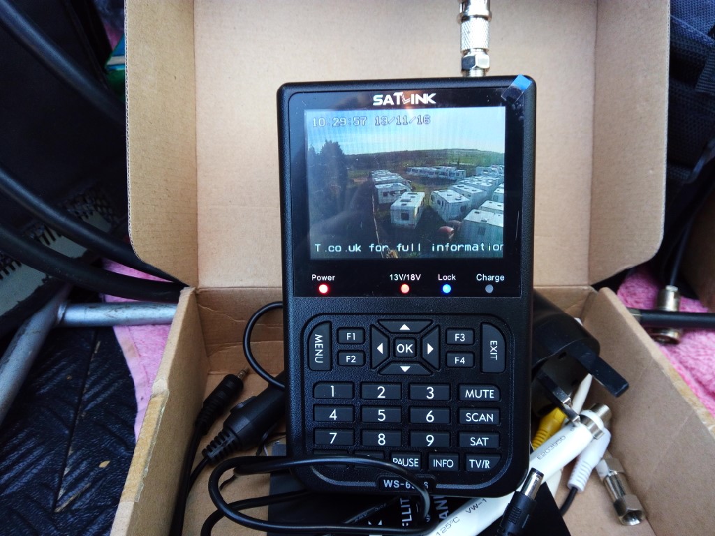

Quite a few ATVers are going for these at the minute for 23cms. A bit more than your V7 admittedly but everything in one and portable self powered too, they had come down to around £40 at one time but seem to be creeping up again.

Most of us in Bristol have one of these Satlinks and they work very well for 23cm. I've had mine down to 1133ks/s, but no lower. They are available from UK suppliers on Amazon for about £65. There is one slight snag - they put out a sprog on 2m, exactly 144.750MHz would you believe!

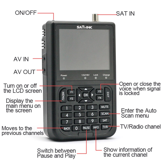

The Satlink can be opened up and a small switch and L.E.D easily fitted to the top panel near the antenna socket in order to isolate LNB volts.
The only time you need to switch OFF the voltage is when using an antenna such as a beam or Alford Slot where it would cause a short across the socket if plugged directly into the device.
You can see several points where you can cut the track or lift a component and test with a multimeter to check the voltage is there.
of course it changes with vertical / horizontal so you can see that you are on the correct point.
This allows you to switch OFF the LNB voltage or of course ON so that you can power a preamp.
If you don't want to go inside the device then you need to isolate the voltage coming out of the F connector some other way.
Theres appears to be a function in menu's to turn ON or OFF the voltage but on mine that function doesn't work.
If anyone out there finds a way to turn off the LNB volts from menu , please let us all know ?

Just ordered one of the satlink receivers ...look ideal for the money
Will be using it with mast head pre amp powered over coax on 23/24 cms

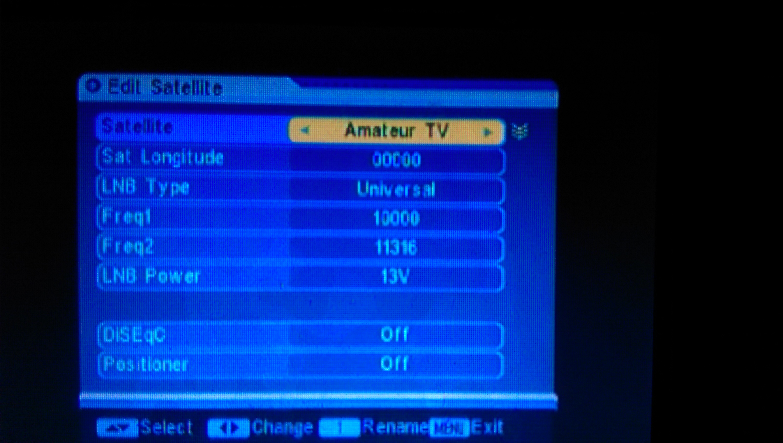

First thing you need to do is to Add (a New) Satellite.. I called mine 'Amateur TV' Oddly enough..
Sat Longtitude can be left 00000
LNB set to Universal
This next one makes your life easy, set the LNB Freq 1 to 100000 since this would be the LNBs 'downshift' frequency, the actual frequency required will simply have this amount added to it. ie 1316MHz will now be programmed as 11316MHz.
So LNB Freq 2 (for our local repeater) is set to 11316MHz Give us the Channel frequency to scan.
I set the LNB Power to 13V since the Preamp is probably happiest closer to 12V than to 18V.
22K and DISEqC can be left OFF.
That has set up a New Satellite, and (potential) Bank of Channels.
Next, when in range of a Digital signal, Repeater or whatever, you need to do a SCAN of the Satellite..
Any available Stations should spring up in the search list.
So you save the result(s) as a new channel and rename it as you like.
