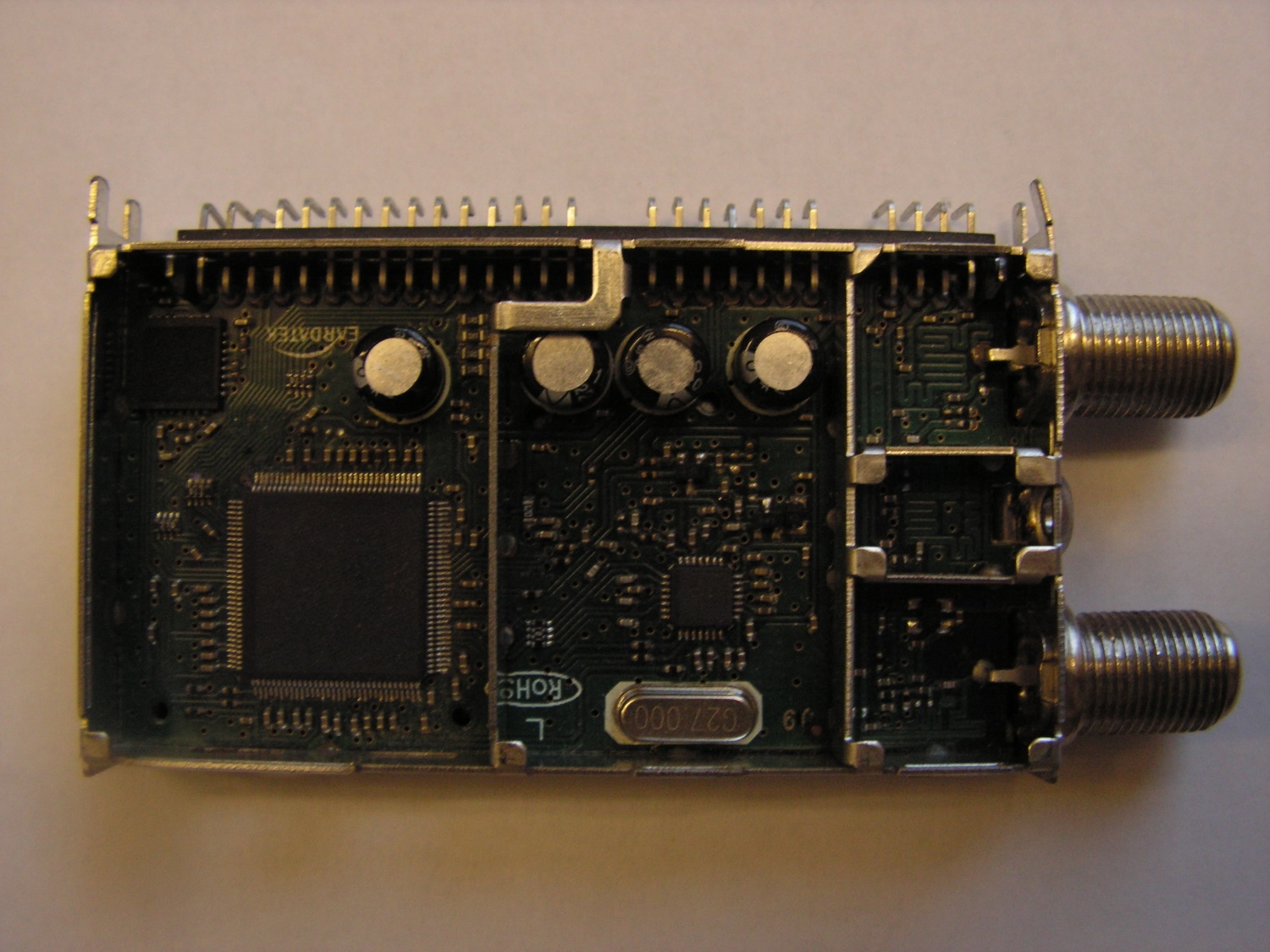

I found a discussion here about using a Eardatek tuner. I have few pcs but they seem to be faulty.
The tuners are a part of a satellite tuner board - in a repair shop tuners are not repaired - only PCB board ,if there is no LNB voltage(13/18V) that is made in PCB board.
If there is LNB voltage and yet no signal then tuner board is throw out with tuner, which is a pity.
Has anyone tried to repair a tuner like that made by Eardatek ( or ALPS )?
Can anyone suggest a method how to repair them?
Here is a a picture of Eardatek

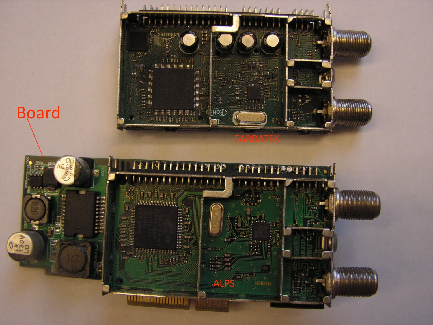

and here is a picture of Eardatek and ALPS tuner( used with a board). Eardatek replaced ALPS tuner and is used in the same way - so pins should be the same as ALPS

I have never repaired one of those devices but I suspect it might be the LNA "low noise amplifier"
that has gone (chip bottom right hand corner). You should be able to test that by using a signal generator
@ 1 GHz, inject a signal into the main LNB input and then measure the output on the 2nd LNB
connector which is usually connected to the output of the amplifier. If there is little or
no signal present at that connector the chip has gone and will need to be replaced.
A heat gun, tweezers and a steady hand and you should be able to replace that chip.
I am only guessing.

Most tuners have two connectors on them.
One connector connects to the input of the tuner's LAN the
other connector is connected to the output of the tuner's LNA.
It allows you to daisy chain receivers. It will also allow you to test the
LNA to see if it has gain by connecting the connector on the output of the
LNA to another receiver.
Yes you can use that signal generator but don't overload the input to the LNA
as you might damage it.
You still need something to measure the output of the LNA.
Using the method I suggested you can do the testing without the need
for any test equipment.
