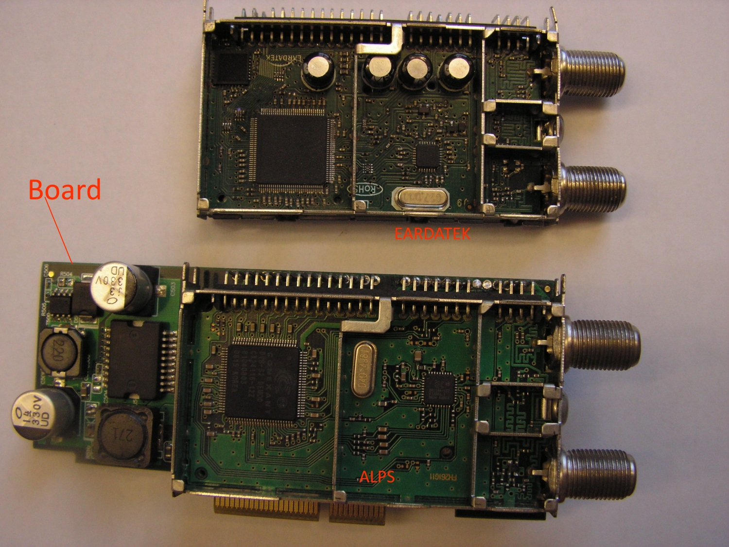

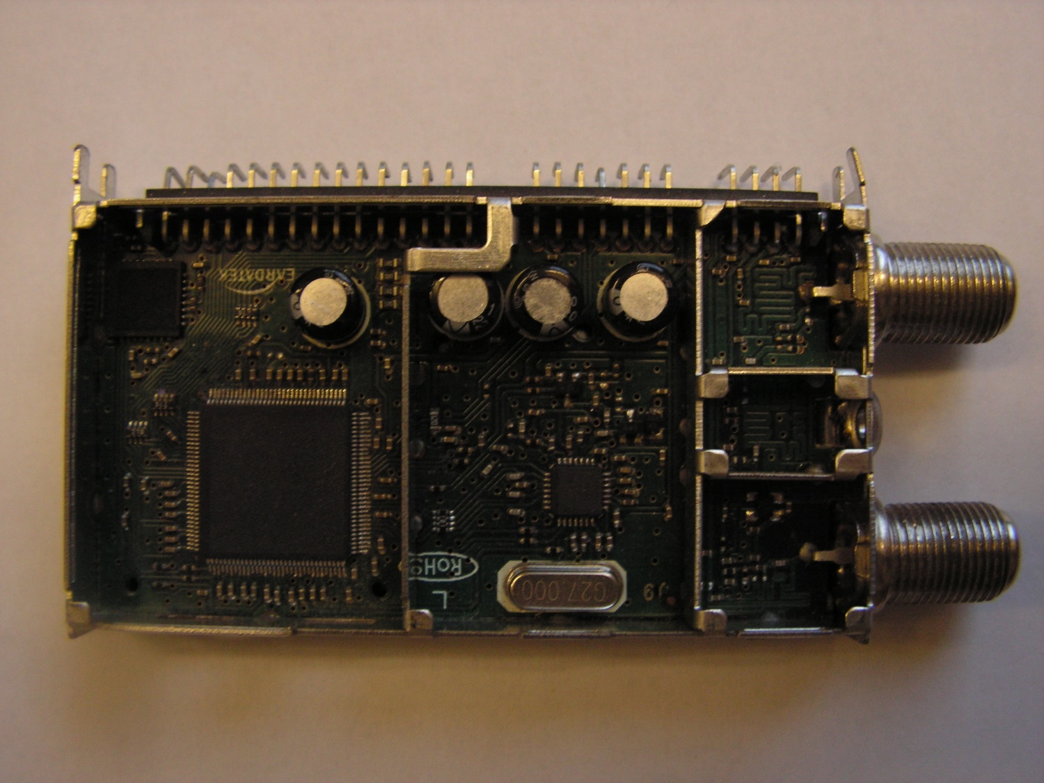

Here is a a picture of Eardatek
and here is a picture of Eardatek and ALPS tuner( used with a board). Eardatek replaced ALPS tuner and is used in the same way - so pins should be the same as ALPS

I have never repaired one of those devices but I suspect it might be the LNA "low noise amplifier"
that has gone (chip bottom right hand corner). You should be able to test that by using a signal generator
@ 1 GHz, inject a signal into the main LNB input and then measure the output on the 2nd LNB
connector which is usually connected to the output of the amplifier. If there is little or
no signal present at that connector the chip has gone and will need to be replaced.
A heat gun, tweezers and a steady hand and you should be able to replace that chip.
I am only guessing.
