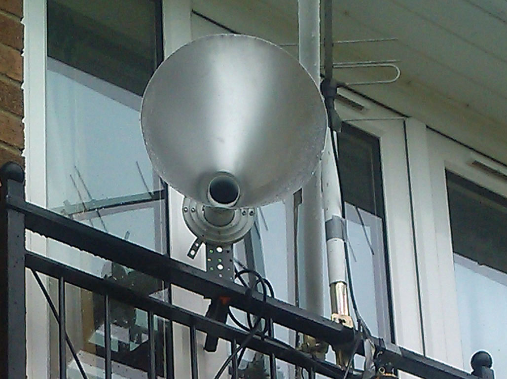

Here's a pic of the horn I made to fit one of these LNB's.. although I can get a pic from GB3NV the local DATV repeater 16 miles away just by pointing the LNB out of an upstairs window without any antenna.
Tony.
G4AXN
Tony.
G4AXN
- horn2.jpg (156.82 KiB) Viewed 12560 times

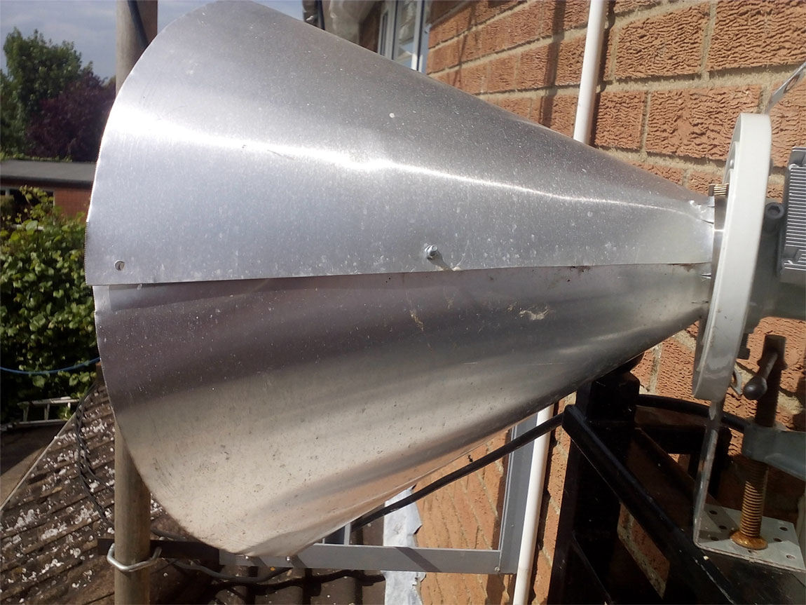

Nice job with the Horn Tony!
Is that riveted or welded at the join?
Re: C-band LNB.
Good question Rob
As is often the case the view from behind is not as attractive as the view from the front !
Slightly hidden is the jubilee clip which clamps the serrated narrow end of the horn to the circular waveguide on the LNB.
Important to slide the horn up and down the waveguide for max gain using a signal meter or spectrum analyser before tightening the jubilee clip.
Tony.
Tony.
- horn4.jpg (226.81 KiB) Viewed 12374 times

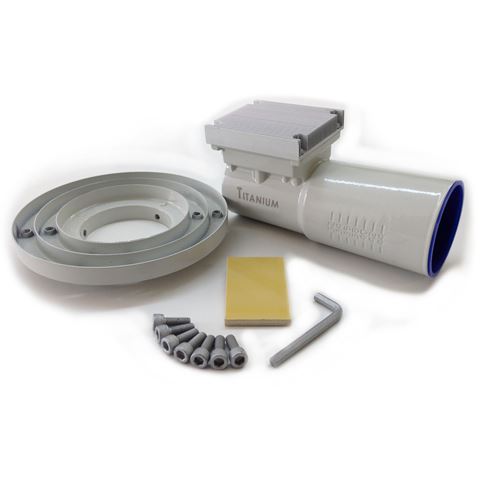

As a thought...with the C1W-PLL, there appears to be a progression in diameter from the feed tube block to the front.
The "extra" tube is approx. 9cm long and internal diameter at the front end of 6.3cm a label inside says 65dB Gain.
Is there a way to extend the progression in diameter to get a little more gain?
No great loss if no, could put up as is for local signals.
Pic attached of similar feed.
Peter
Peter
- C-Band.jpg (15.66 KiB) Viewed 11857 times
