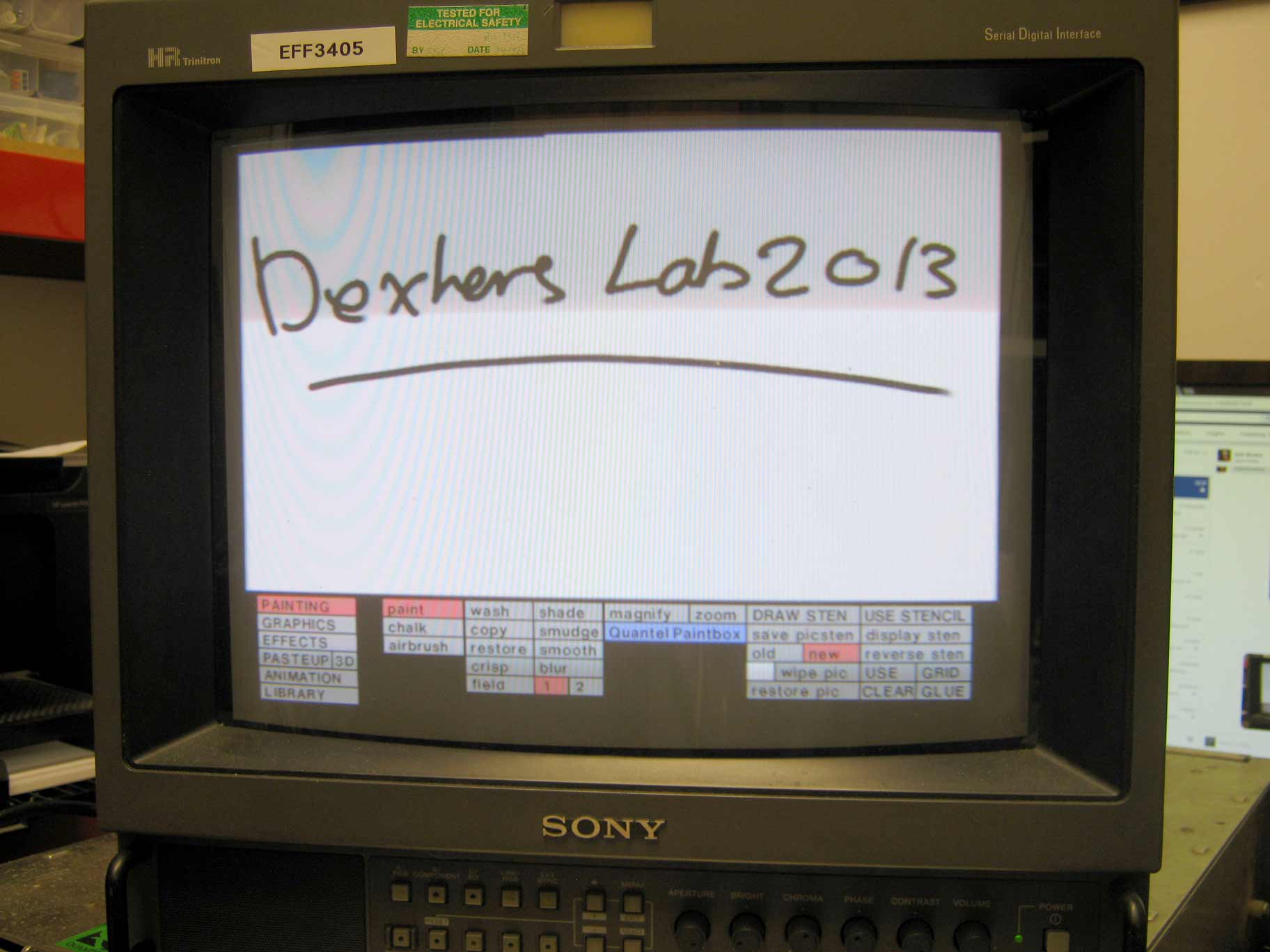

Sorry to bump this thread but i wanted to let people know that with the help of many i now have a working paintbox! I can tell you it was not an easy task!
If anyone stumbles across this thread in the future and needs help with a paintbox you can track me down by sending me a message here or googling for dexterslab2013 where you will be able to find my blog and youtube channel.

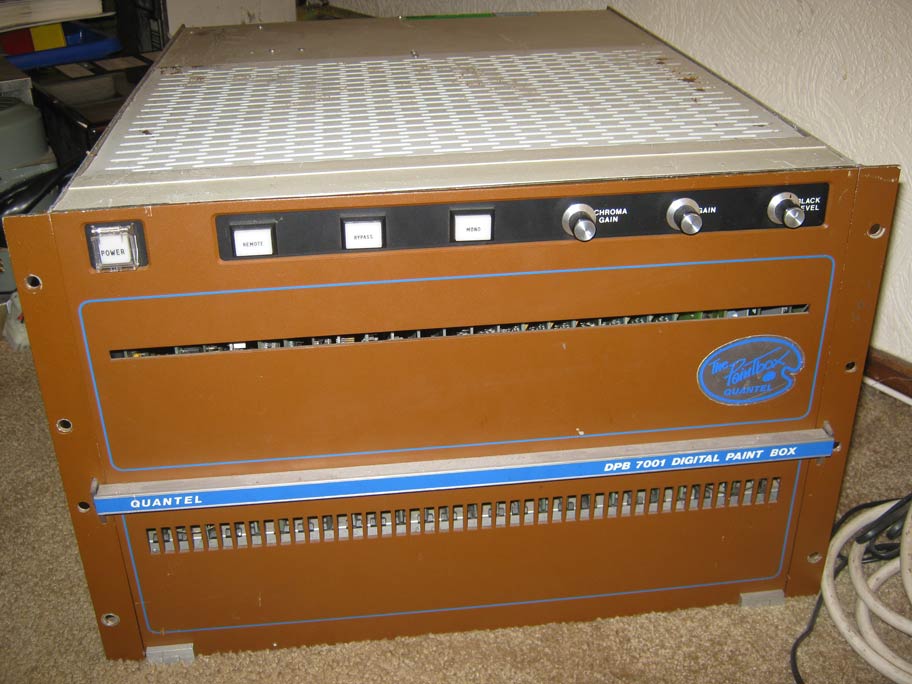

If the one you bid on looked like the attached picture below then yes that was a first generation one, the ones from the 1990s are usually 3 or 6U and somewhat more stylish and typically beige. The one featured in the picture below is actually mine as well, it's a DPB-7001 which is basically a first generation Paintbox with a couple of tweaks. But it's a behemoth and it's 14" winchester disk is just as imposing!
