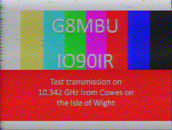

After more tests this afternoon, I grabbed this screenshot: The signal was received off a partially obstructed dish looking at a nearby crane at a distance of 14 km from the beacon.
Next step is to permanently fix a Sky Dish on the wall outside pointed at the crane (and hope that the crane stays there for a while!)

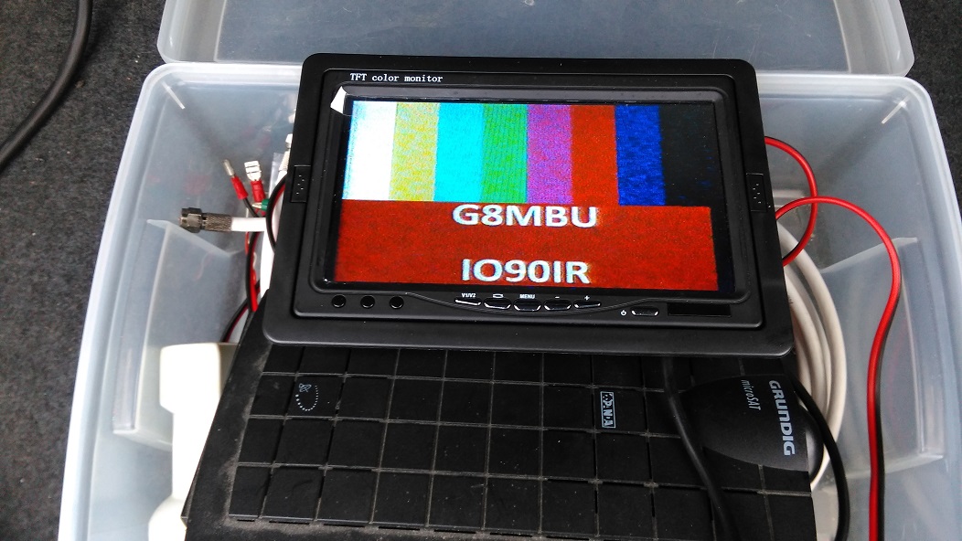

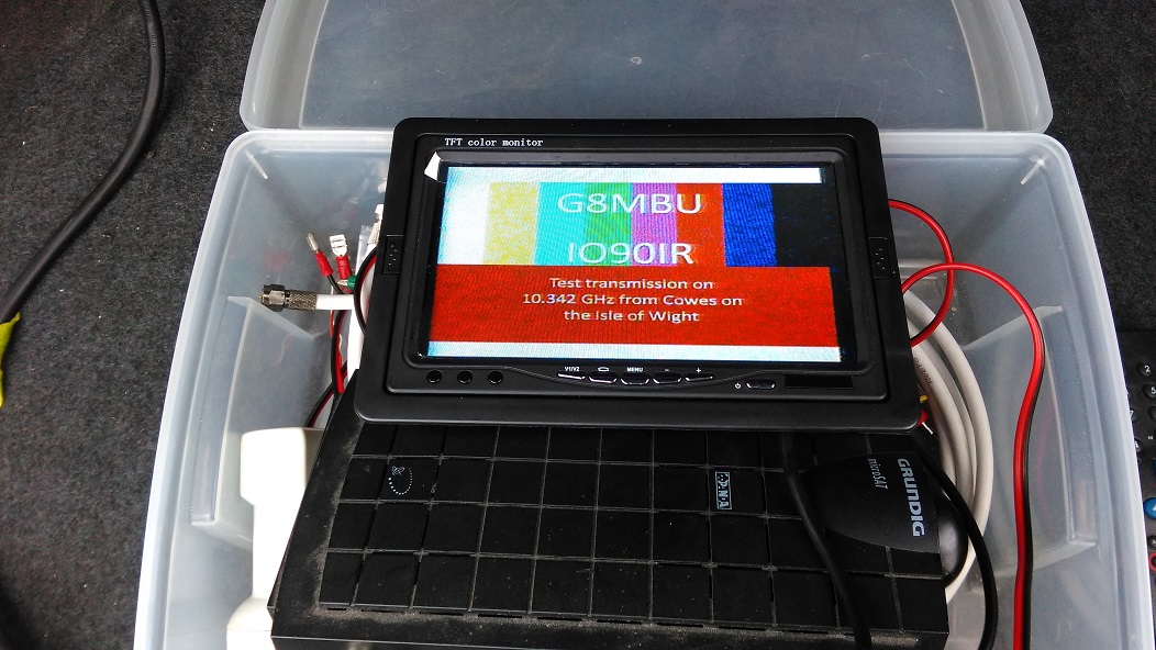

Success today, P4 with Sky mini dish and P2 with a horn and LNB.
Went to a spot on the overcliff between the piers.

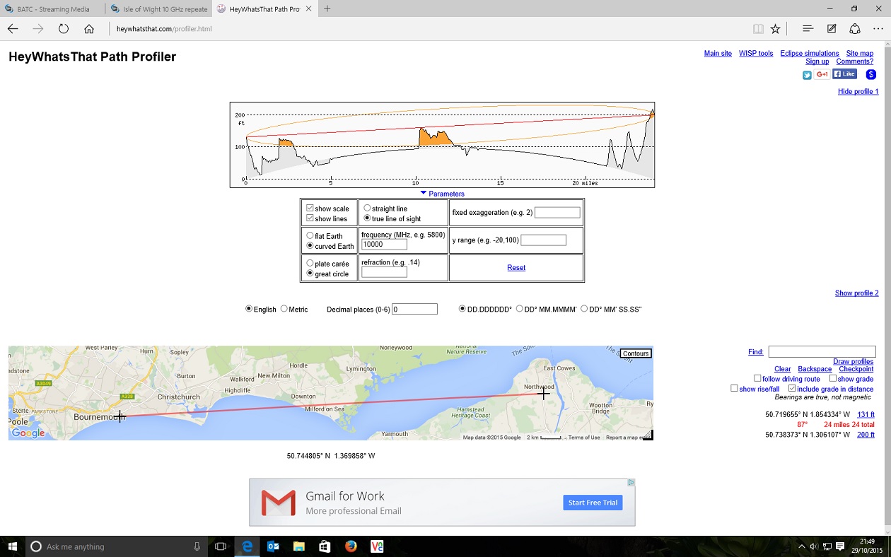

Path plot gives distance as 24 Miles

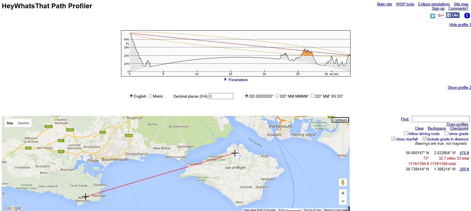

Went a little further today, had a P3 picture at 32.7 Miles

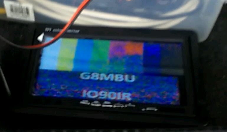

Didn't take many photos of this trip, so only have this out of focus screen grab!
The dish had moved a little at this time, some work to do on the tripod mounting next
