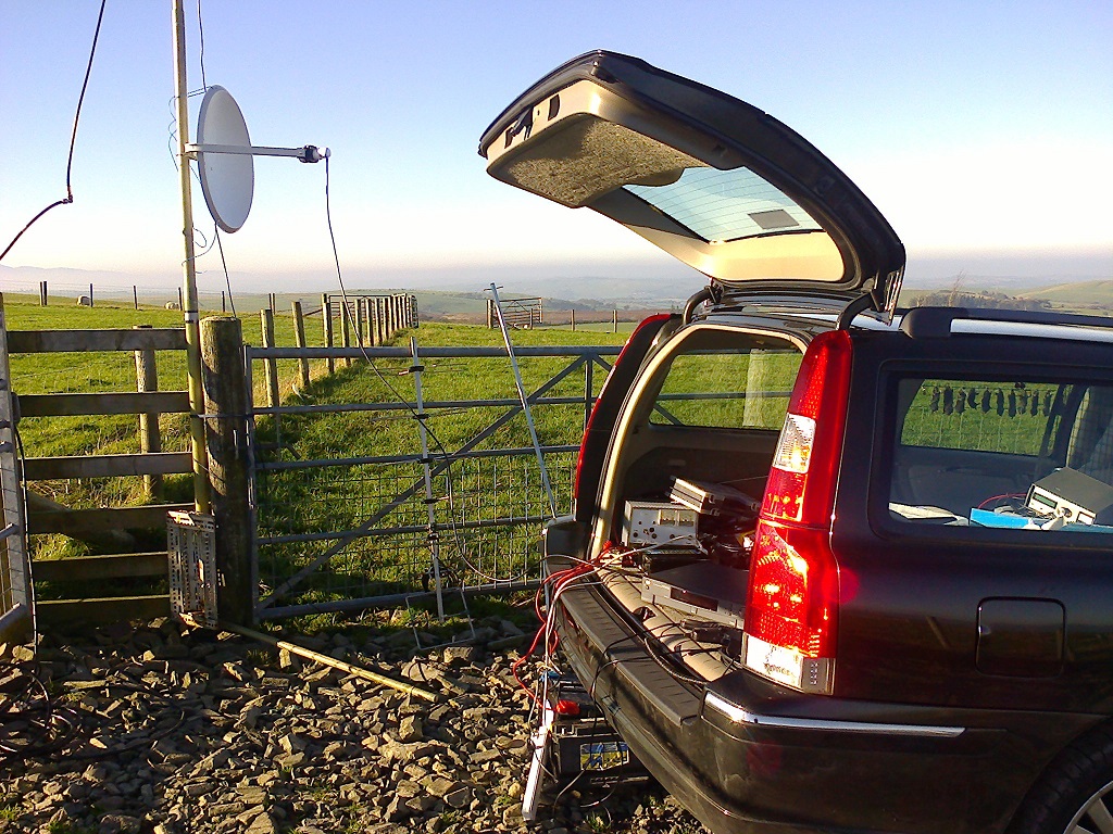

As G6NOI and I left the Wirral, it was a horrible, damp, murky day. As we climbed the hill into Wales, we broke out into bright sunshine for a warm day that could easily have passed for June.
G1LWX/P was running 2W to a 60cm dish on 10425MHz and was easily received on the 85km path. In fact he was so strong that a dish wasn't necessary and he was P5 with plenty to spare on just the LNB.

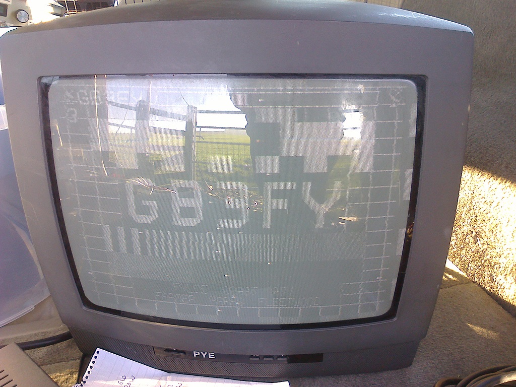

The GB3FY repeater in Fleetwood on 10240MHz was received at P4 on a 60cm dish over the 91km path.

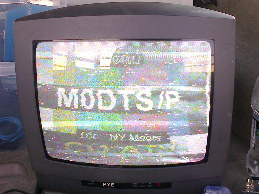

Unfortunately M0DTS/P on the North York Moors could not be received on 146.5MHz RBTV over the 220km path. The signal was S3-S4 when tuned on an AM receiver, but the combination of the DG0VE converter and the MiniTiouner was showing lots of noise. More investigation required. The antenna was a 9 ele portable Tonna. Signals on 2m FM were very strong both ways.
M0DTS/P was received at up to P4 at times with a 21 ele Wimo on 1249MHz, probably due to aircraft reflections.

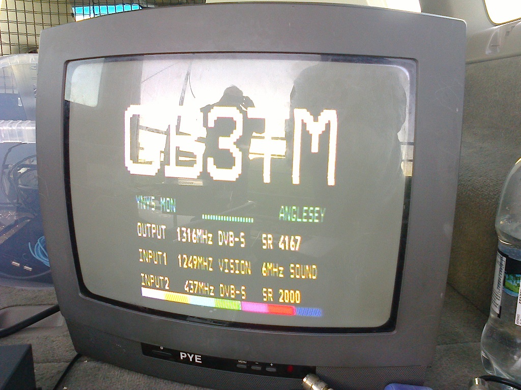

The GB3TM repeater in Anglesey on 1316MHz was received at D5 over a 59km path.

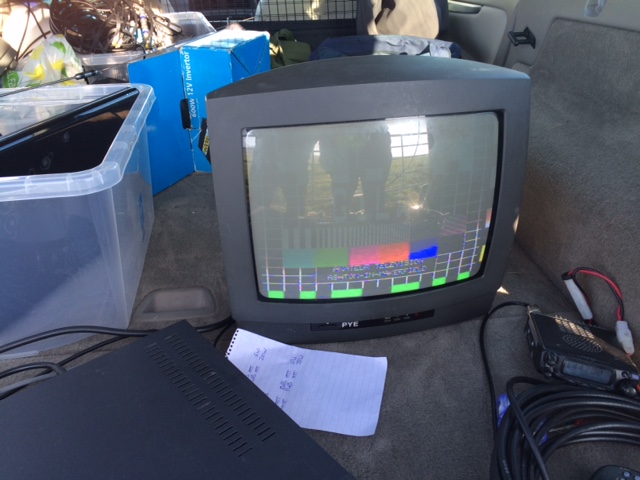

G1LWX's test card just about visible, due to the strong sunlight.
G6NOI adjusting the beam heading to G1LWX/P.

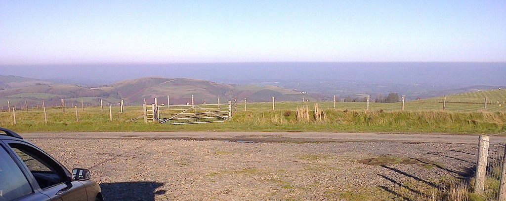

The takeoff to the north-east. The horizon of rolling hills is obscured by a layer of murk.
Not much chance of working to the south-west.
