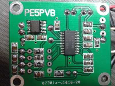

Re: OSD units
I designed one myself. It uses a MAX7456, which is currently still in production. With a rotary encoder you can easy choose the position on the screen, then push it to select the character...
- 2013-02-25 14.40.15.jpg (44.24 KiB) Viewed 6680 times
