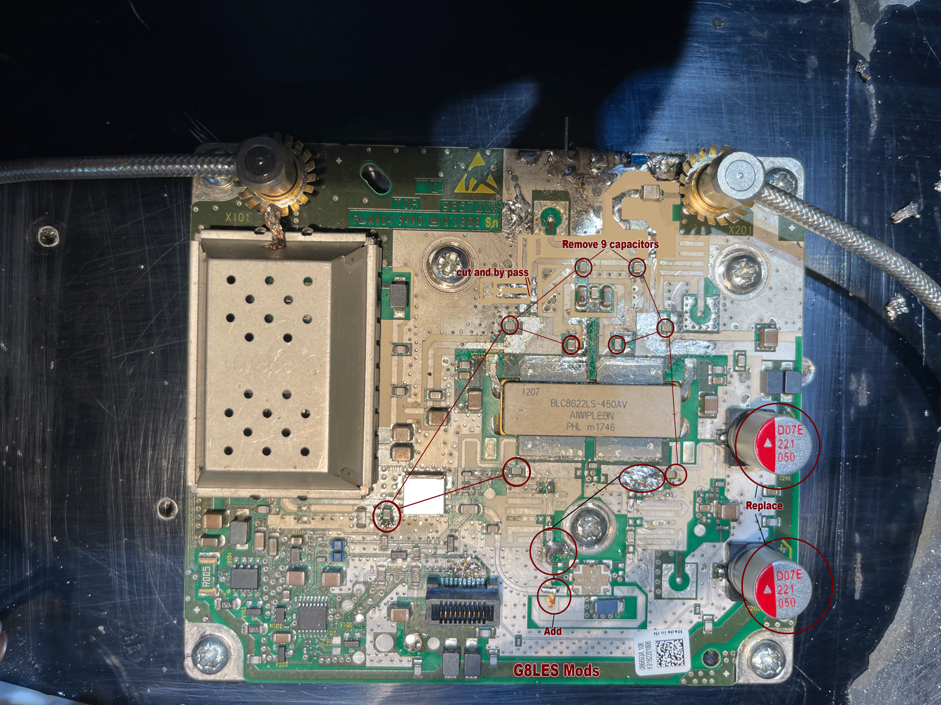

Re: Nokia? Polish eBay amplifiers BLC8G22LS-450AV
Posted: Tue Aug 15, 2023 12:20 am
by G8LES
Are they Nokia amps or some other make?
I have one going properly now.
The spectral regrowth was awful on 2390-2400 but ok on 2320. Nice staircase on the analyser of regrowth. The transistor phasing lines aren't working on 2400 as one of the drain tracks are too long and the transistors are fighting each other's phasing.
The driver is clean to 50dB has 38dB gain and produces 3watts drive when driven with DATV express at full output.
After removing lots of capacitors and a hairpin track by bypassing it and it works great now, enough to warm up LMR 400 after 15minutes. Heatsink nice and cool.
I have a picture with the mods on I have done in Photoshop - enjoy
The Bias on the output transistor is running all the time, so turn off the 28/32volts otherwise it gets warm without the fans running.
Mike G8LES
