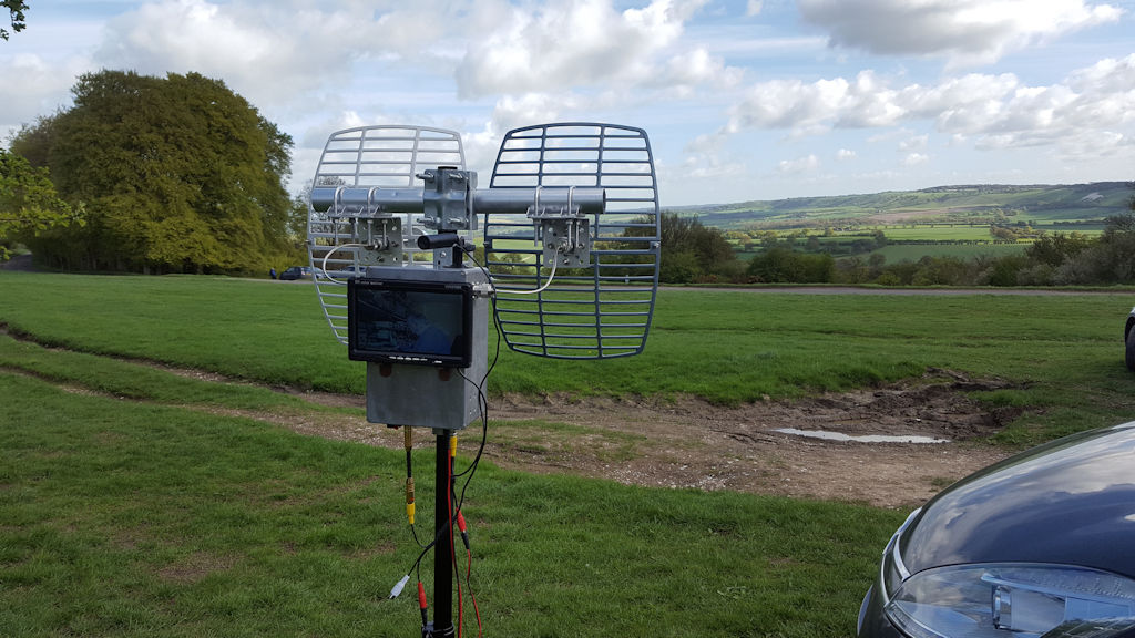

As we near another activity weekend I thought it was about time I tested my second generation setup; I built it before Christmas. :oops: Here's one of the picture taken early this morning close to Ivinghoe Beacon; my planned location for 5th May activity. The gentleman on the monitor is Arthur G4CPE whose breakfast I interrupted for the test. Pictures were P5 both ways and no smoke. ;)
The hill in the background is Dunstable Downs.

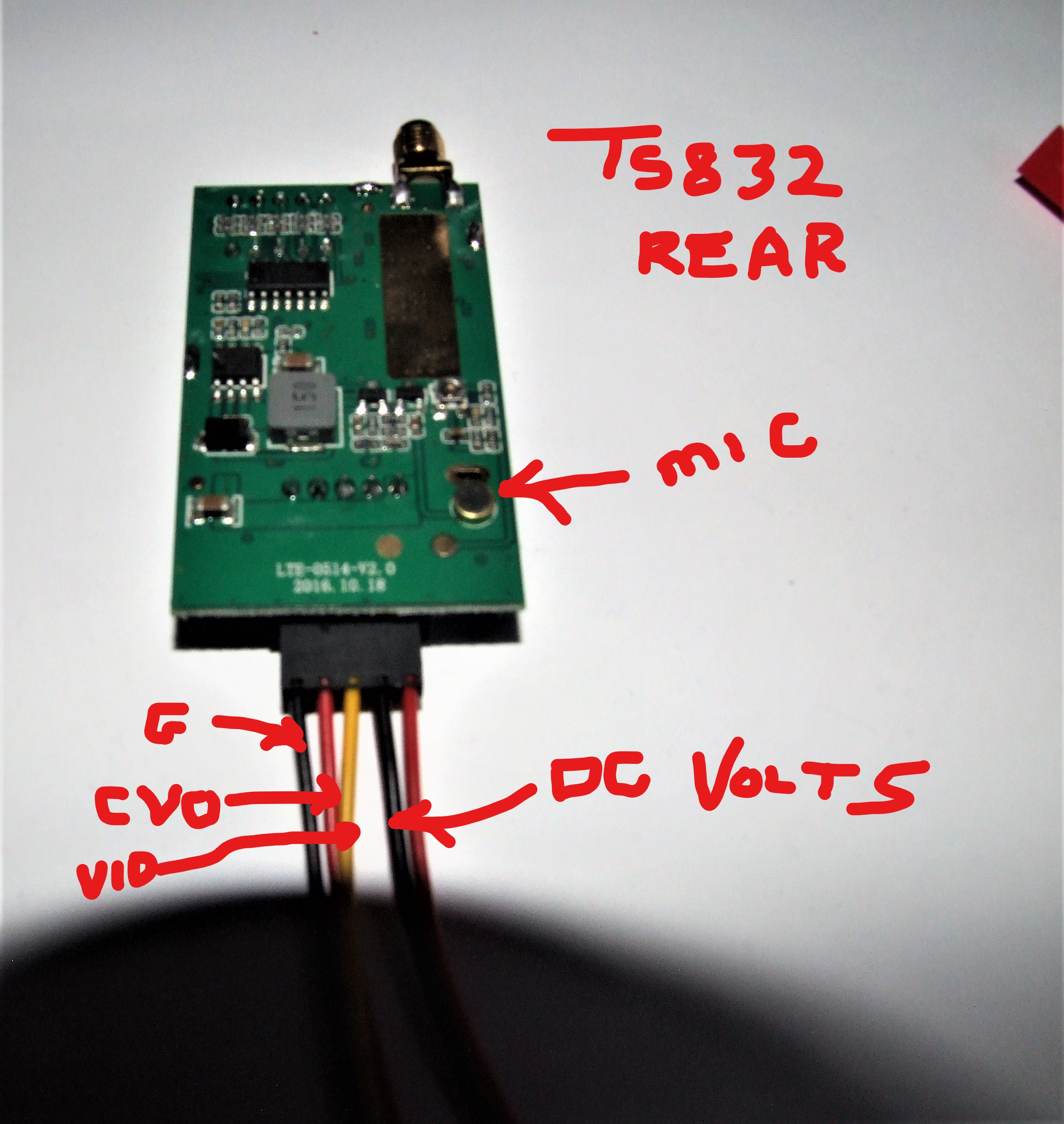

soooo a couple more parts for the project turn up today - the needed reverse to normal sma adaptors and the tx's with the sma fittings - you will remember I mistakenly got one with a fixed antenna ........................ any hoo so i'm looking at the thing and consulting the book of words that was printed on the carton , and it says audio - 6.5 MHz .................. but unlike the other tx there is no audio IN connection/wire .............. scratch head - looking on the back I notice a TINY and I mean tiny - as small as this O - piece of cloth - like you have on a MICROPHONE :shock: :shock: :shock: - and from the looks of it - it is indeed just that ................... hummm - something to watch out for if you buy these things ................. I suppose I could unsolder this tiny thing and put flying leads in - but my eyes ain't good enough to see to do it - but not all is lost as I can just shout loudly at the tx when I go out ..................... should cause a few odd looks :lol: :lol: :lol: :lol: :lol:

Perhaps you could post a few photographs to show what you mean. I am sure that someone here could explain it. With my TX, I had to make up the output cable. The header and each wire was supplied loose.

ok as you will see - lead out on TS832 - RED /BLACK =dc volts in - YELLOW =VID IN - BLACK = GROUND THE OTHER RED IS CAMERA VOLTS OUT .......... no audio lead ............... but that little black thing arrowed appears to be the mic - the board has audio on it so this must be it - sorry cant get any closer - camera not up to much

That looks a nice sturdy setup Steve just the job for a for a gale force wind on top of a mountain LOL (we don't have mountains here in Norfolk Shire but we have heard of them!)
What's the gain on the antennas?
Hello Pete
Top end is solid but the tripod is a let down; no individual leg adjustment. One leg was stood on a brick I keep in the car. :roll:
Next week I should be collecting a modification for a surveyor tripod I acquired.
Claimed gain is 27dB and the TX has a 2.5W PA. My other setup uses a relay but I decided to have separate TX/RX grids on MK2.

and again looking at the wires out - it may have the same mic /audio problem as mine have ( see post re this ) - however, a thought hit me at about 2 am this morning - one could fit a short length of plastics tube over the built-in mike and have like a speaking tube ........... we used to have a similar system called an "acoustic hood " fittable to our fire service pagers for working in noisy environments - old school - but they worked :geek:
