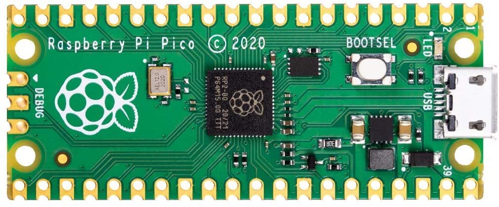

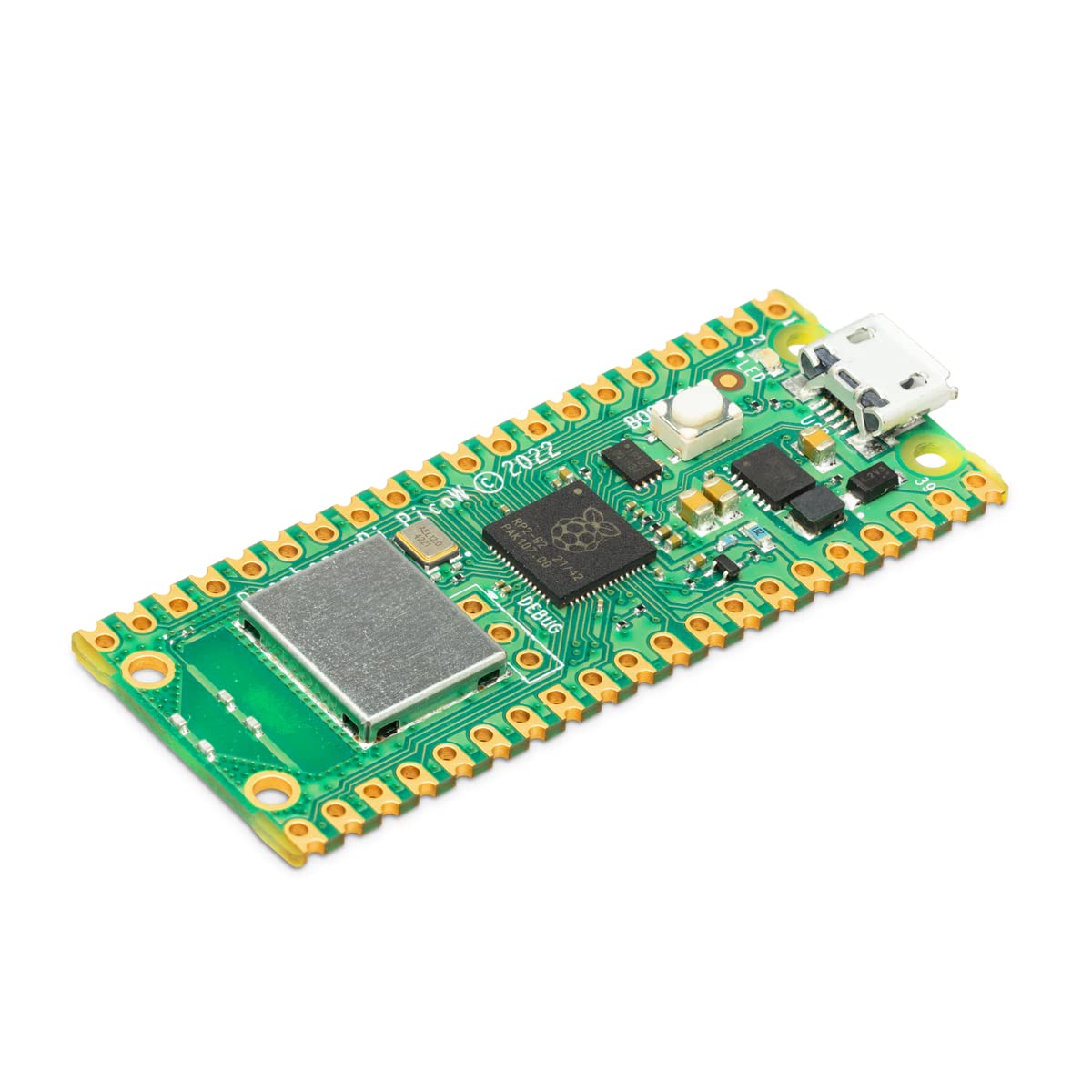

I've just corrected some erroneous information that I posted elsewhere about the Pico W. Apologies for the confusion. It should be pin compatible with the standard Pico. Various Pico options are being looked at, so it may be better to wait. At the moment, there's no guarantee that anything other than the dual TS USB connection on a standard Pico will be developed.
Here are some Pico options:
The standard Pico.
The Pico W (Wifi)

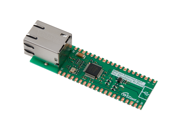

The WIZnet Ethernet hat to fit on a standard Pico.

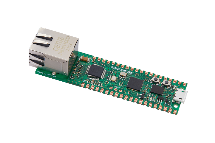

The WIZnet Ethernet chip integrated onto a Pico. Three different Ethernet chip options are available.
