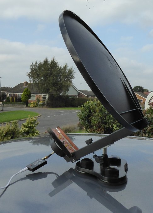

Just a few more of my idea's for portable 5Ghz tests. Shown here is the dish I purchased at Newark which has 3 rubber suction feet to hold it on the car roof (not while mobile I hasten to add!) :D :D
portable dish.jpg (52.63 KiB) Viewed 9997 times

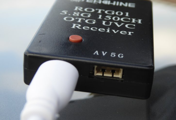

This is the scanning RX and shown below is the USB cable and the miniature 4 pin plug with AV composite out and volts in.
scanning RX.jpg (56.33 KiB) Viewed 9997 times
rx connections.jpg (37.9 KiB) Viewed 9997 times

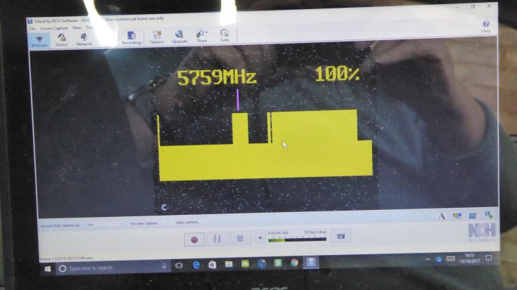

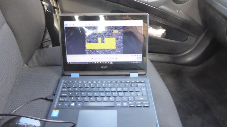

Carrying on from my initial post. The photo's below show the laptop screen showing the frequency read out while scanning,scan paused and locked on a transmission from my shack!
The next step hopefully will be some field trials to see how well or otherwise the system works! I just need some decent weather!

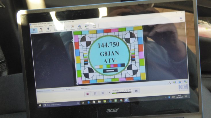

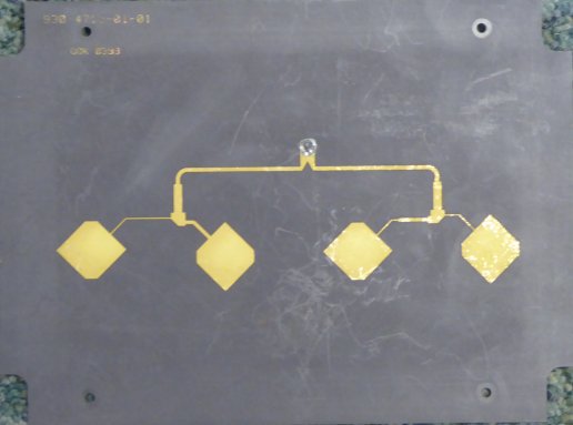

Last week I set up a 600Mw TX feeding into a panel antenna. My QTH is 17 metres ASL Take off towards the West over the Fens is the best direction for me, so having checked in Google street view I picked out two possible RX locations at 4.5 and 4 miles respectively. Previously using no gain antenna's I'd barely achieved 2 miles with a P1-P2 pictures! For receive I used the SCANNING RX previously mentioned but rewired to give stop scan and 2 Mhz stepping. It's a very crude system but I have doubts that in scan mode the RX will pick up a weak signal?
With the RX c/w panel antenna feeding into my laptop via the USB cable and using the NCH Debut software, I set out in my car to the 4.5 mile point.
For whatever reason I never even detected sync pulses! So on to the 4 mile point only to find the layby occupied by a sugar beet tractor! Damn I thought, typical Fen activity!
With the light fading I drove towards home looking for another suitable place to stop. Having no luck I parked for a few minutes at the side of the road and stuck the antenna out of the car window. Wow! Instantly up came my test card P umpteen beautifully stable and as good as I get around the shack! A later check showed my stop being at 3.5 miles and 3 metres below sea level! I must explain that although the Fens are flat, antennas should still be as high as possible especially at microwave frequencies as the most unexpected things can block a signal not necessarily seen in line of sight! One other problem on the Fens is that people are very suspicious of strange vehicles parked up anywhere as the level of crime is surprisingly high.
Here is a screen grab of my received signal using the NCH software and a photo of the identical antennas used at both ends.
Pete G8JAN
