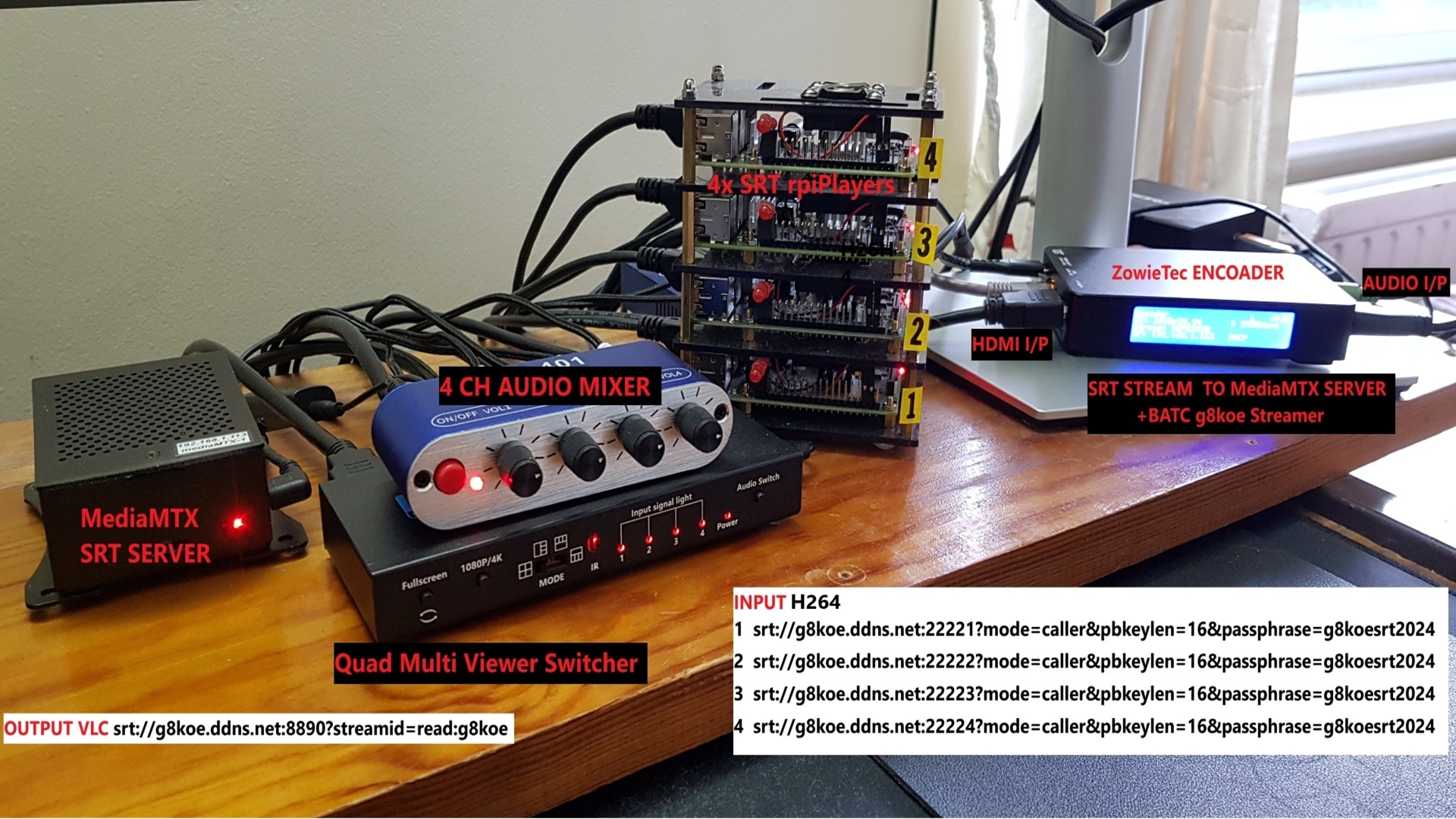

I have made some changes to my SRT Repeater.
The use of a PC with OBS USB video and a sound input capture modules has now been replaced.
The repeater now consists of 4 raspberry pi’s each with SRT RPi Players installed.
4 HDMI outputs are connected to a Quad Multi Viewer giving a single HDMI output.
The audio from 4 raspberry pi’s are connected to a sound mixer producing a single audio output.
The HDMI and Audio are connected to a ZowiBox encoder which has OSD option to produce text or graphic overlays.
Using the ZowiBox now testing a second BATC stream to g8koe.
The main output is streamed to a MediaMTX server on raspberry pi.
You now have audio on all 4 inputs.
With the changes made I can apply power and the repeater boots up in operational mode.

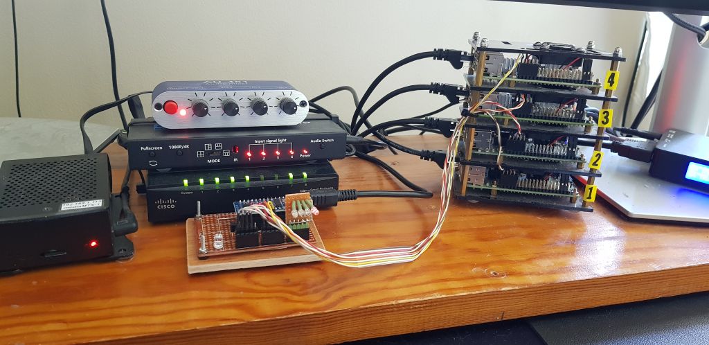

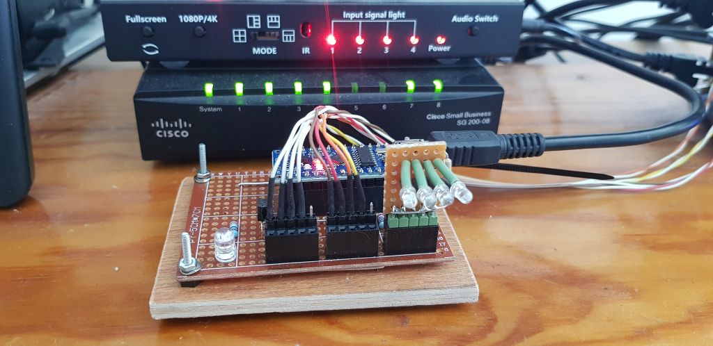

A G4FKK LOGIC FOR MY SRT REPEATER IS UNDER TEST
The operation of the logic is simple if any of the 4 inputs logic goes active the repeater will go into full screen mode. If a second input goes active we go back to 4 screen mode. Be patient when using the repeater the screen changes are purposely slow to minimise spurious modes being triggered. If you are using VLC when changes are in progress it can sometimes freeze and need refreshing. The audio is on all 4 channels. When using the repeater if you could put some text saying which channel you are using for example CH4 etc. There is no easy way for me to automatically implement this on my very simple SRT repeater.

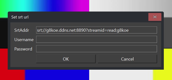

Happytimesoft
After extensive test with VLC to work with the new logic have failed.
When the logic switches modes the encoder box has an interruption to its HDMI feed.
This causes VLC to stop and need restarting.
Yet again Tech Support (G7JTT) has come to the rescue.
https://happytimesoft.com/
“Go to download and look for "SRT client for windows"
This comes with the usual disclaimer use at your own risk.
I have installed it on my laptop with great success.
If the software looses connection it reconnects automatically.

SRT LOGIN INFO for HappyTime Software
