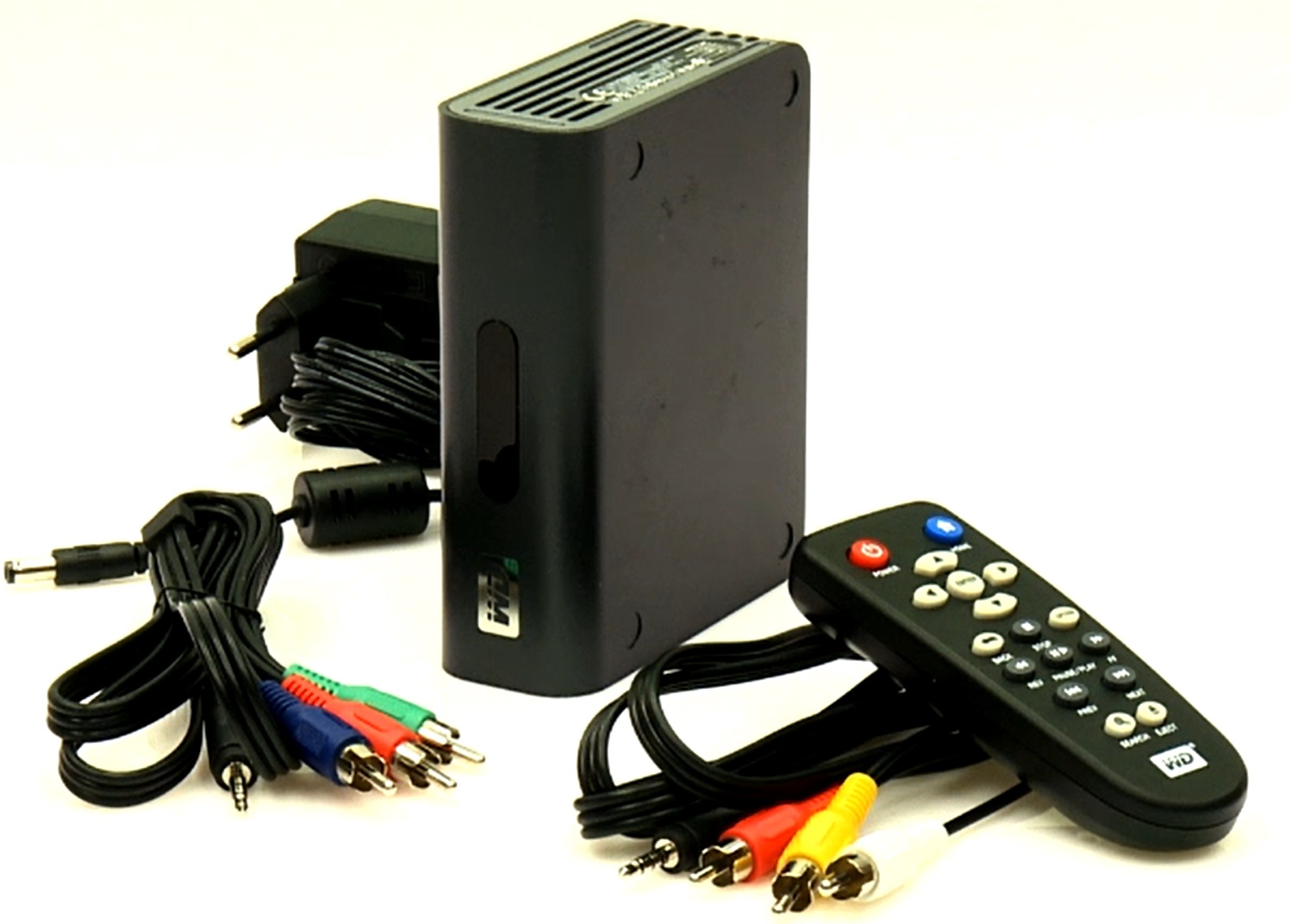

instead of using OBS, I am using an old WD mediaplayer with the content to be streamed on an USB stick.
Encoder (H.264/H.265) is also in separate hardware, so no need for a PC
73 Rainer
