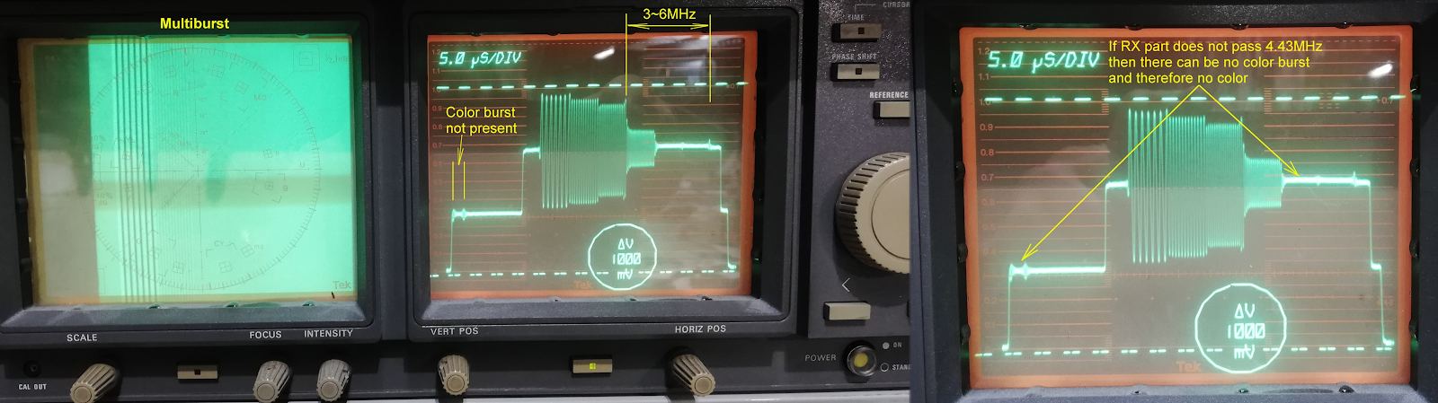

Unfortunately unfortunately , IC-905 in PAL standard region in FMTV mode is almost unusable in its current state.
Here is my test.....
https://oe7dbh.blogspot.com/2024/09/ic- ... imode.html

Hi Rob
Facts:
1. PAL video standard has color subcarrier at 4.433... MHz
2. NTSC video standard has color subcarrier at 3.579... MHz
3. IC-905 ---> video path , measured !!, by software strongly suppresses all frequencies above 4MHz ( RX and TX path )
4. i assume we are of the same opinion, there can be no color without color subcarrier, right ?
5. i assume that the same software is available for download under software version 1.15 for the whole world.
6. and I assume that the hardware of all IC-905 is the same for the whole world ( so does my IC-905 )
An analog PAL camera generates its own color carrier 4,433MHz and sends it together with sync pulse and video content to the video camera output.
You use this PAL camera signal on the video input of your IC-905, correct ?
Please explain to me how you can see the color on the other receiver if no color carrier is sent or present ?

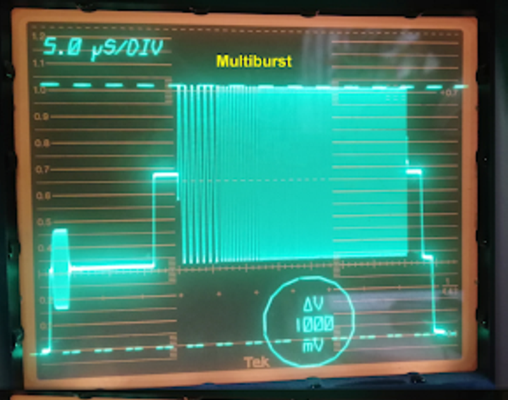

Video signal path, measured frequency response of IC-905.... and this is what it should look like....
Facts:
