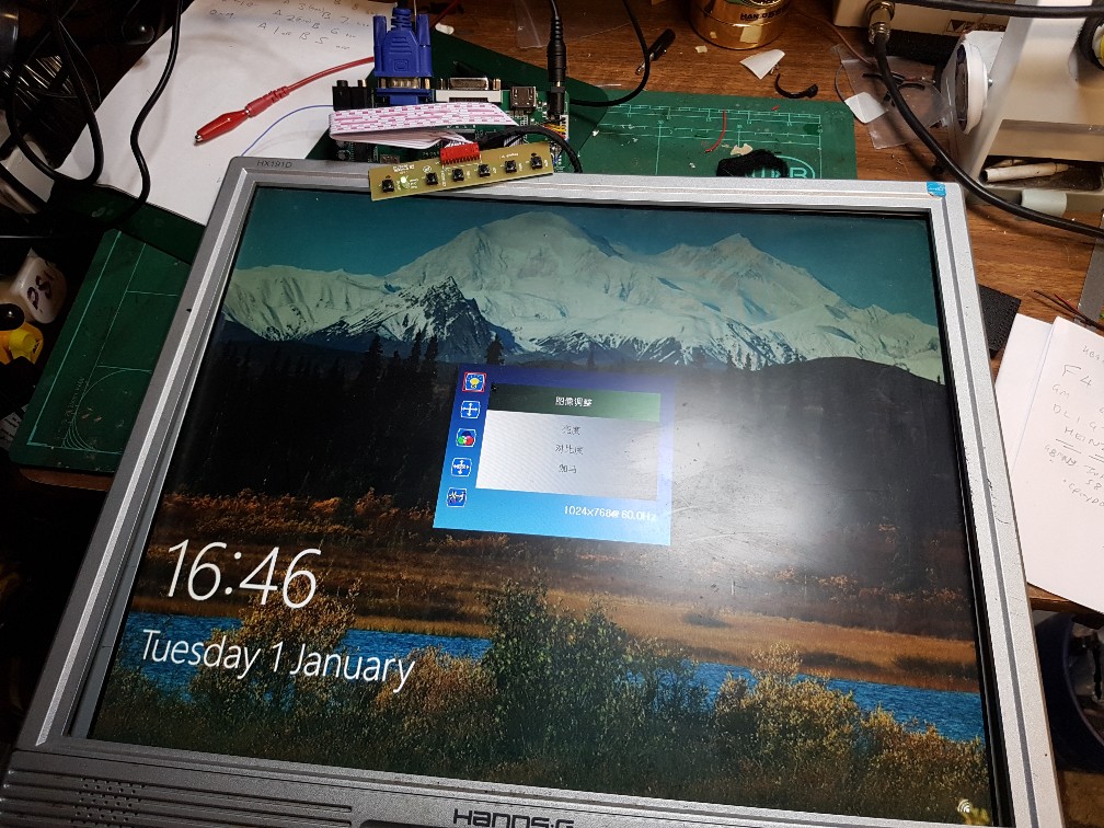

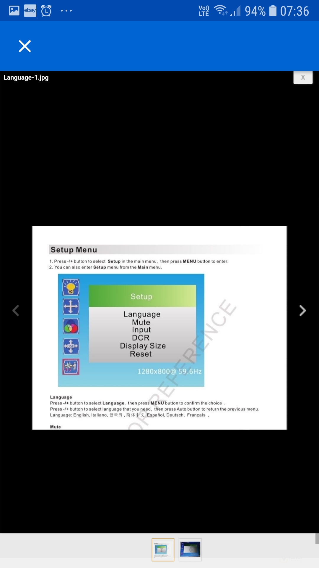

I bought a second driver adaptor board to go with a Hannsg monitor. This one came without remote control. It had a good image on the panel straightaway. There was just the Chinese on screen menu. The vendor sent the helpful images below to get me into English.
I hope this is helpful.
David M0YDH
English.
English.
Finding language settings
Panel and driver as received.
