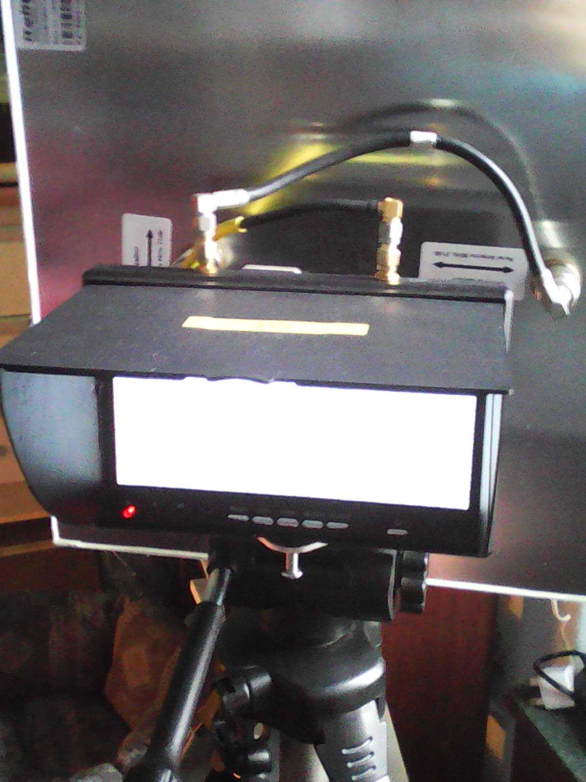

its cheap and easy they said ……………………. uh huh ……………. latest snag on the build - got a small TFT screen - and lo its one of those that does not display unless its presented with a decent signal level - the rx being an RC832 ……………………
soo what to do ?? - buy a dvr and put in line ?? - more cost and a fair wait for it to come from china - or quicker from italy - but wow the postage is steep - or build some sort of video amp ?? - again fine but my eyesight is not up to much so it would have to be descrete components and on vero board - ............ looks for design ............ er ........................ help !!

Hi - to be fair the problem with modern "blue" screens has been well advertised and is prominent on the wiki page - https://wiki.batc.org.uk/5.6_GHz along with various solutions to get round it inlcuding using a USB receiver in to a PC or mobile phone which is mentioned on an earlier post on this forum.

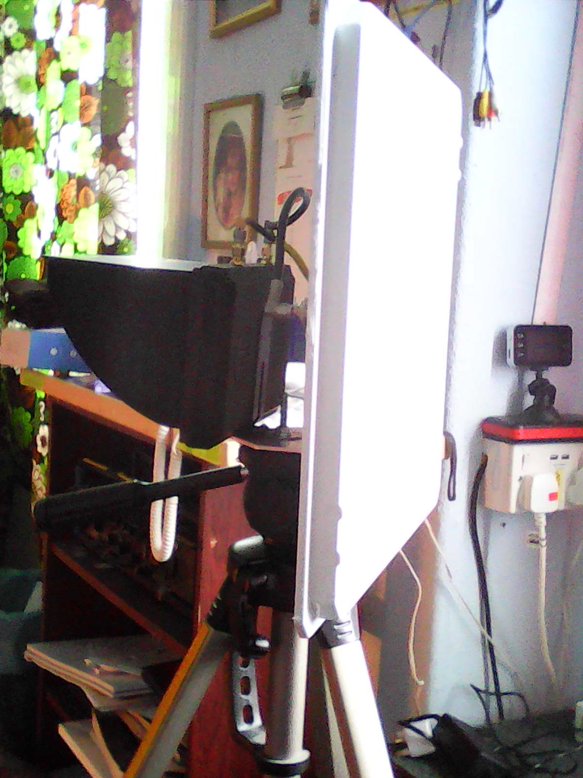

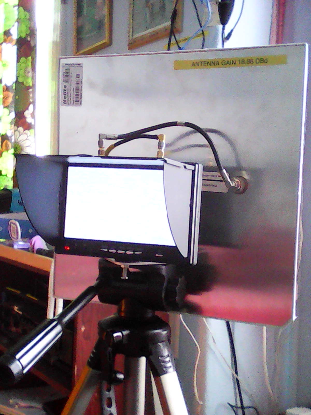

what ho - well FINALLY found someone interested in this - here in Plymouth - so building of systems is ongoing - flat panel ants - 6oo mw or more once it comes and a large 30dbi gain ( claimed ) dish - so is there anyone up along the south cost /IOW that would fancy some tests next year once the weather gets better ?? found this handy path tool for wifi https://link.ui.com/# - and from the START POINT area there appear to be quite a few workable paths
