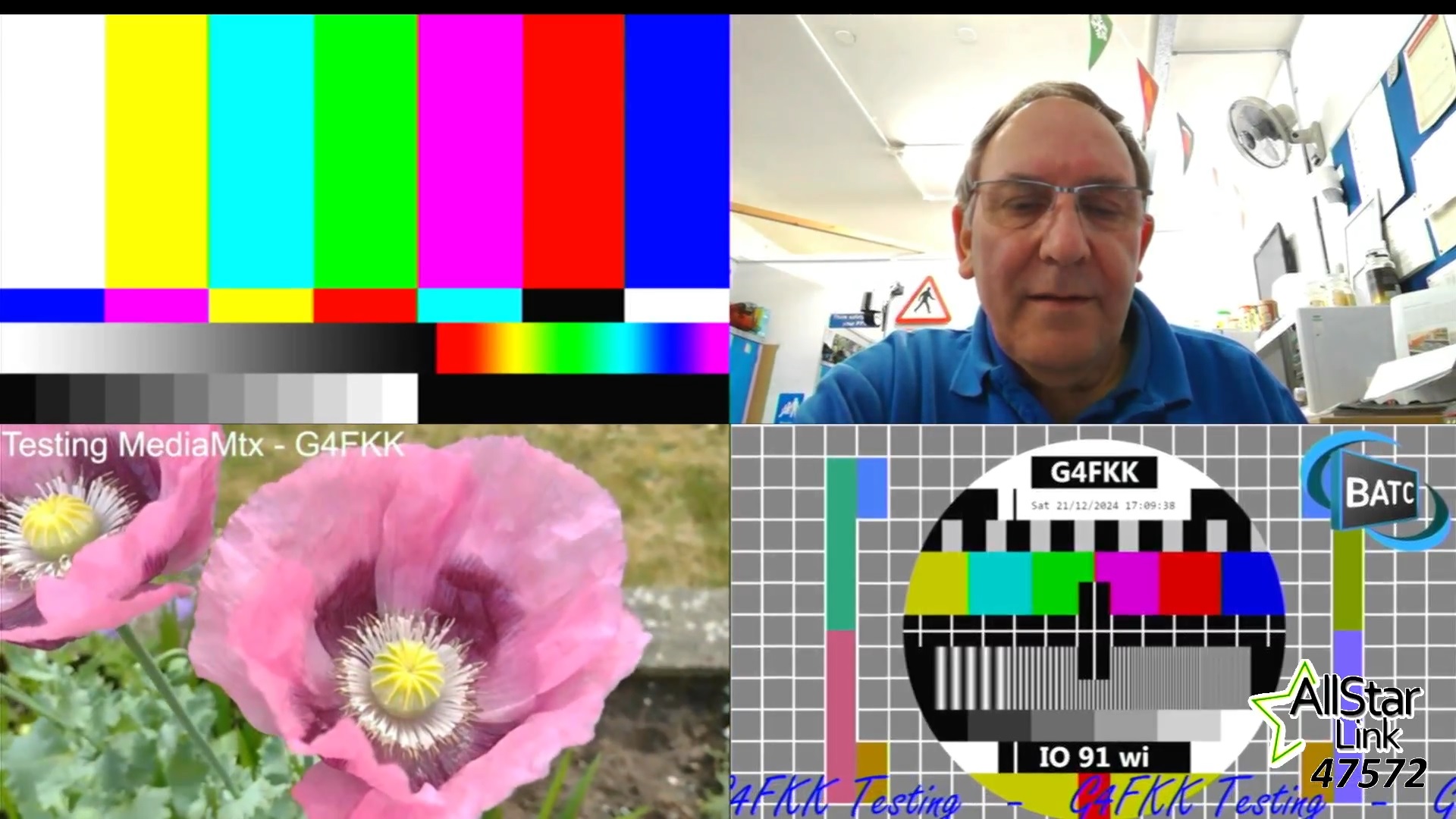

Just received two streams from Martin G4FKK
Martin
G8KOE
Martin
G8KOE

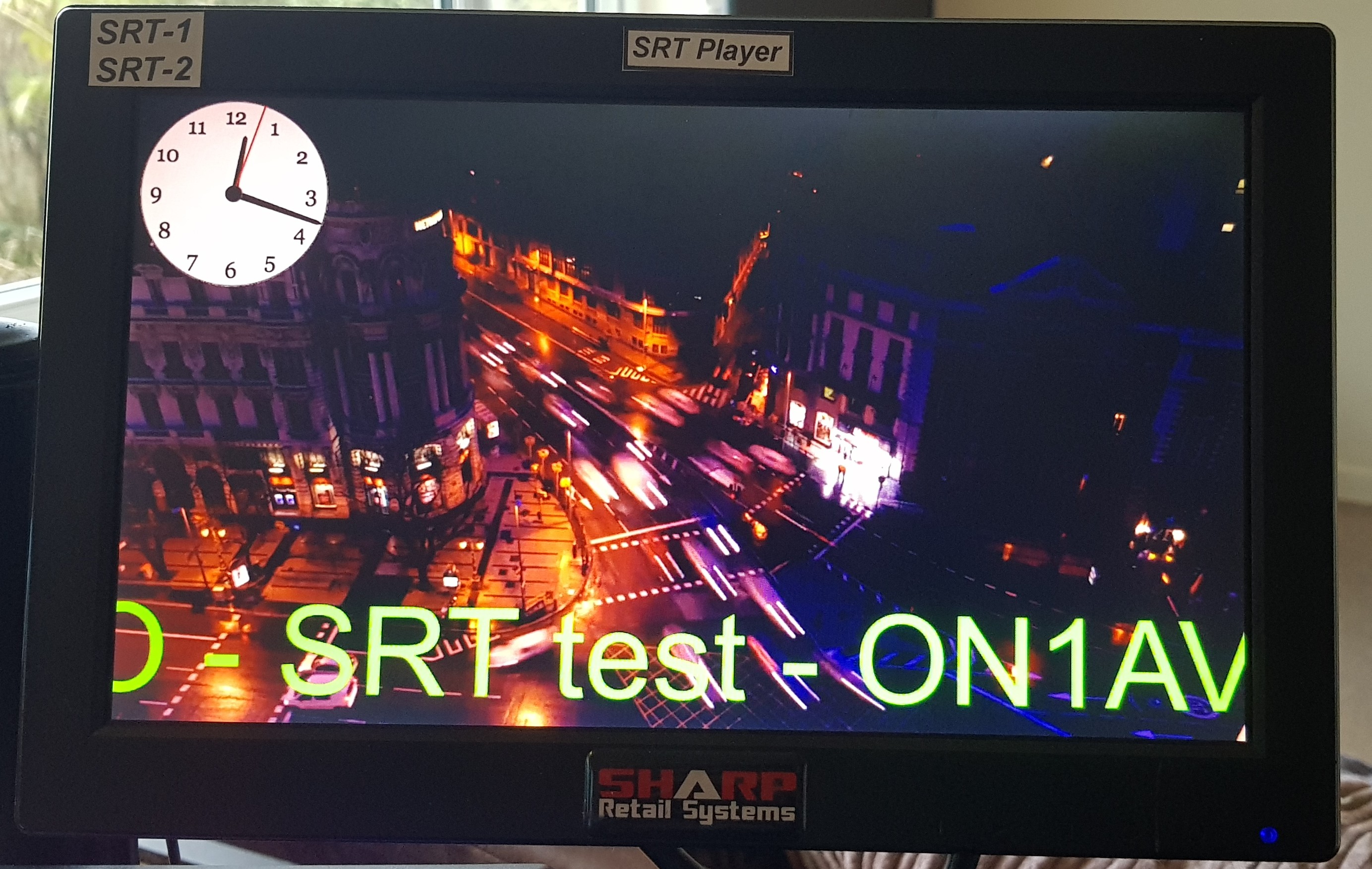

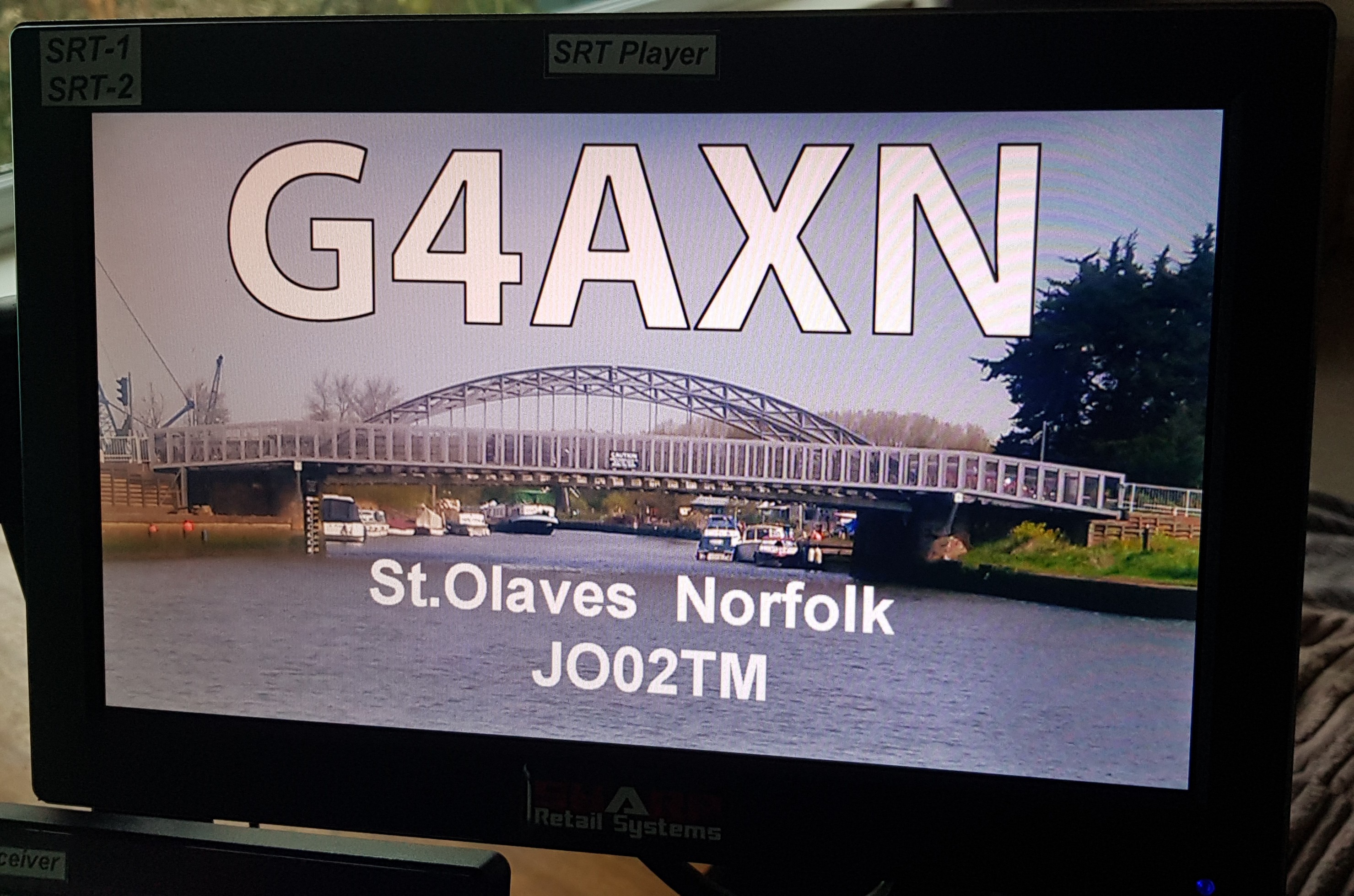

Two new stations have connected to my SRT server today.
Freddy ON1ANO & Tony G4AXN
- ON1AVOsrt.jpg (964.62 KiB) Viewed 11937 times
- G4ANXsrt.jpg (1.23 MiB) Viewed 11937 times

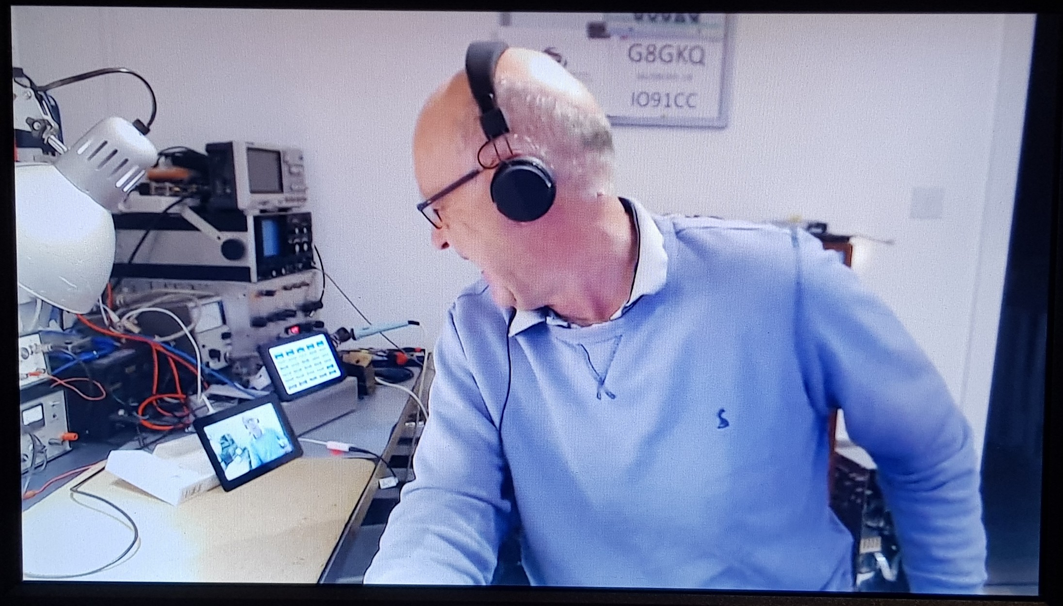

Dave G8GKQ testing SRT
Picture taken with my phone of my SRT receive monitor.
Martin
G8KOE
Martin
G8KOE
- 20241218_194203.jpg (717.8 KiB) Viewed 11456 times

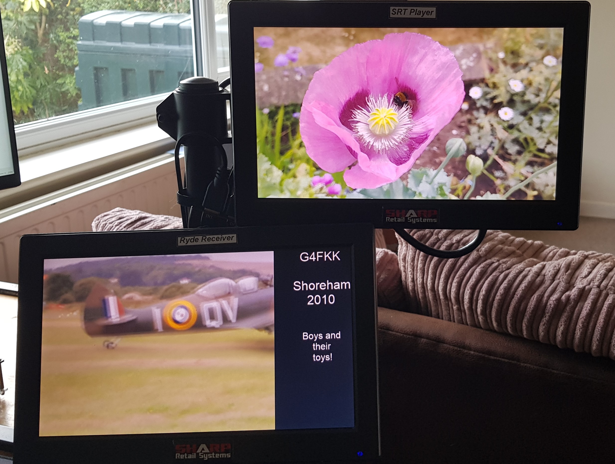

Re: Secure Reliable Transport
Just changed SRT1 input so that all four use the same key.
If your SRT one has ww at end just replace the ww with 2024
I can only have audio on one of the four screen at a time
Default will be screen 1 (SRT1) with audio.
Talkback AllStar 47572
Martin
G8KOE
Martin
G8KOE
- G8KOE 4 Screens.jpg (357.85 KiB) Viewed 11177 times
