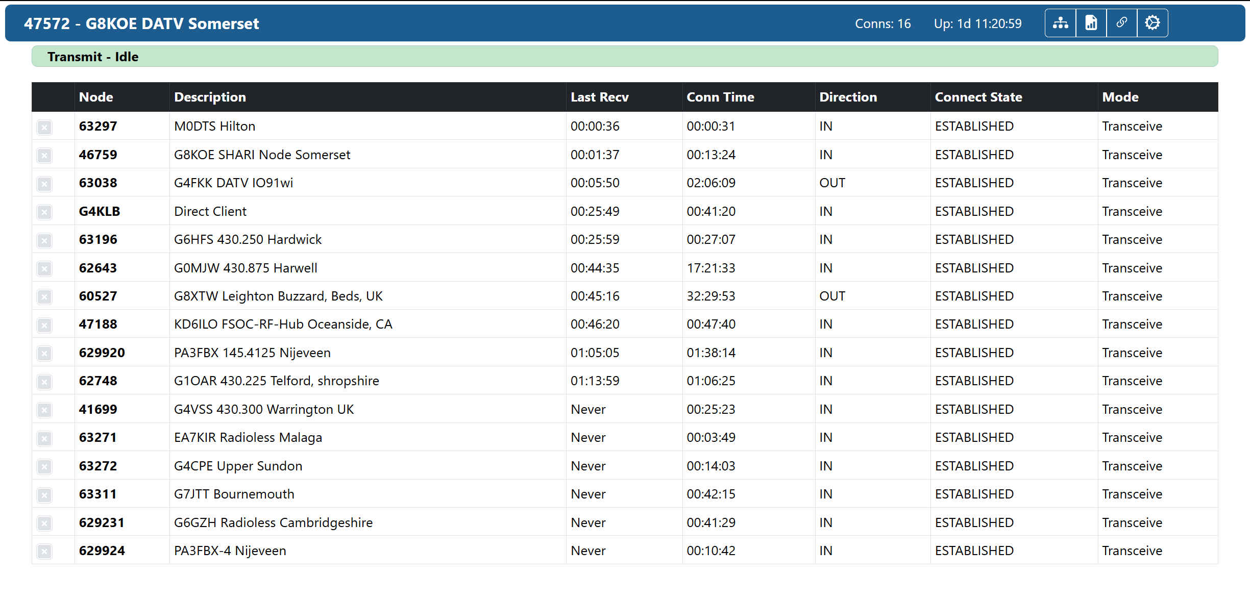

Re: ALLSTAR DATV TALKBACK NODE 47572
16 stations connected to DATV HUB 47572 during BATC NET
Thankyou all for your support.
