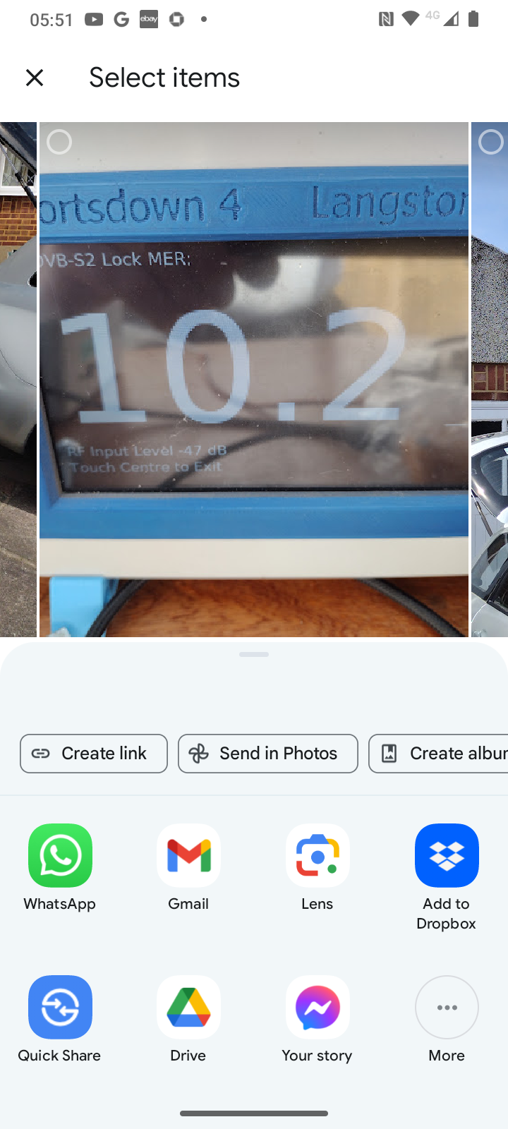

Yes it does accommodate 10.x.

You can also monitor the WB beacon downlink using the Ryde receiver, once you have a signal above the receive threshold (see photo, CAT24 beacon on 1.2m).
