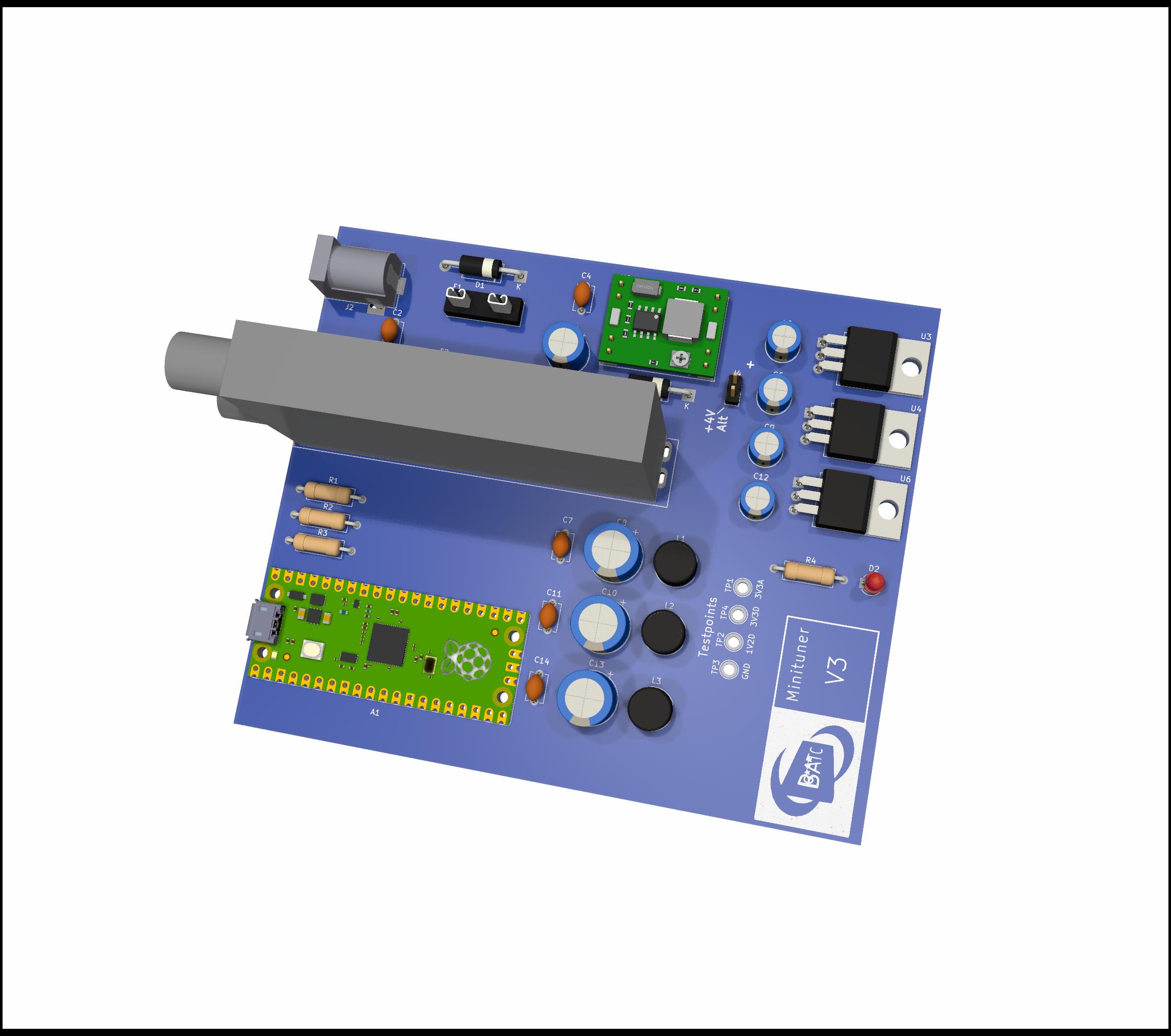

So something like this perhaps?
(Don't worry, it is only a mock up)

From my experience you could also delete the dc-dc converter, saving a few extra pennies and reducing the component count.
I have always powered my minitiouners directly from the USB 5V and have never had a problem.
You would still need the power input socket to provide LNB power if you need it.
Colin G4EML

There's something to be said about using an external bias-t. You don't run the risk of blowing up the internal Serit chokes and it makes it easy to switch between WB and NB polarisations.
Regarding SMD - there would only be a few components. I have no trouble with soldering SMD components. If this 73 year old can do it I can't see why younger members can't!

I agree, SMD is easy, if not easier, as long as the parts are not too small. However, a specification is a specification and that's currently to not use SMD unless there isn't an alternative. One of the biggest problems people have with SMD arises from not using thin enough solder, 0.3mm, not 0.6mm. This isn't helped by the thinner stuff being harder to find.
5V power good - but we would need a different connector. USB-C perhaps, for the full 2.5A experience. Also a proper cable that doesn't drop too much.
On the Winterhill I used an LM317 to limit the 12V current as a simple bias supply.
I could keep it but instead delete the two 3.3V regulators. With a DC-DC giving the 3.3V and with extra filtering for analog, just like I did in the Winterhill. Another little switcher for the 1.1V digital supply. It would probably have to be an SMD one though. That would allow a fairly wide supply range, ideal for running of batteries and would be more efficient.

I like the idea of bringing it up to date with usbc . Plenty of reasonably priced 65 watt power units, auto swithching to power phones and laptops needing 5,9,12,21v outputs. Also higher powered usbc cables to match.
I only need to take one charger away with me for most of my gadgets. John G8IKP

I have started writing a program for the Raspberry Pi Pico to use it in place of the FTDI module. It is progressing well and looks like it might be possible to get it to work with Longmynd and Ryde with little on no changes to their code, but it will probably not be possible to make it work with the Minitione software. That uses the FTDI drivers in Windows, and I am pretty sure they only work with genuine FTDI chips.
Hopefully I can do the first testing in the next couple of days. If it works I am sure Mike will be able to come up with a new PCB for Minitiouner V3.
