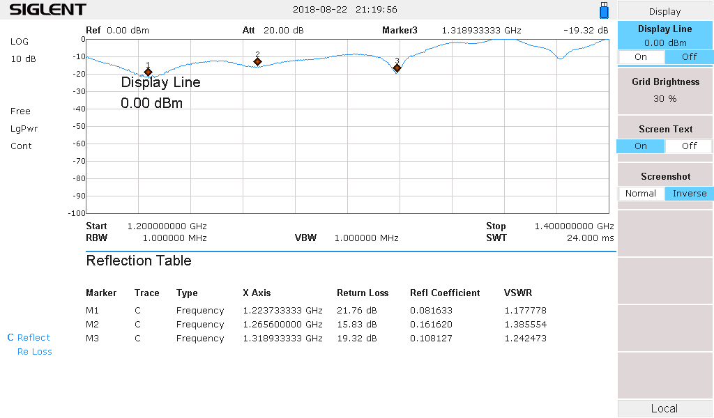

I see the second attached plot (of Dave's JVL model) has vanished. Seems tot be a feature of this bulleting board for me. Here it is again.
- JVL-lp.png (16.83 KiB) Viewed 4045 times
