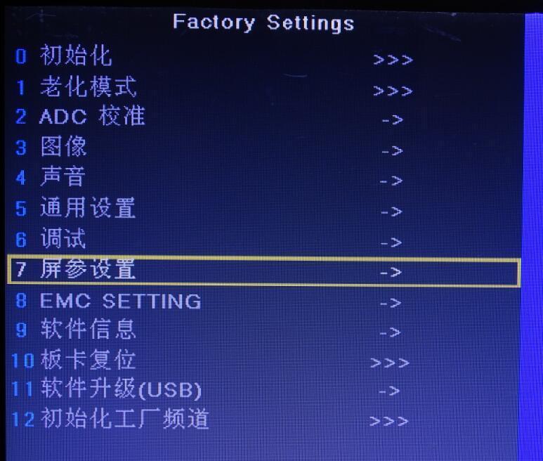

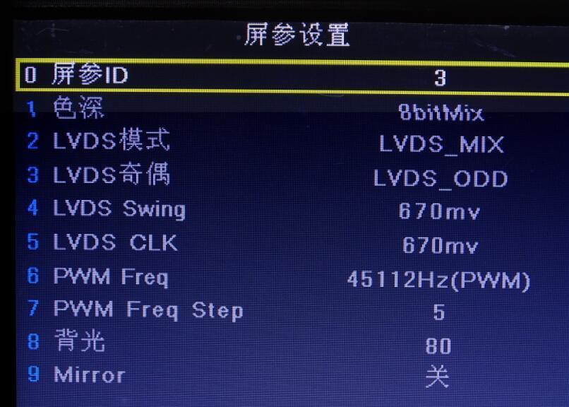

Hi Arthur you need to go into the menu and type 1147 this will bring up a hidden menu. Go to general settings and change LVDS map till the colours are correct.

LVDS 0 fixed it colours are now correct. I did not know there was this other menu, no information was supplied with the board.

I'm battling on with the panel. Today's episode snatched defeat from the jaws of victory. Menu 1147 - numbers lightly pressed and remote pointing at the sensor at point blank range - opened the service menu for the first time. I'd been pressing them like mechanical typewriter keys before.
Item 7 was chosen
then item 0 where the ID was labelled as 0 with the dire colours
I pressed this per the vendor's instructions and the ID changed to 3 with a sharp desktop image behind. Unfortunately in trying to press OK I lost control of the software somehow. The second try nearly worked but the menus were back in Chinese. Now it's an unresponsive image in flickering black and white. I guess I've bricked the software and have to reply to the vendor for more help. It's quite a trial :roll:

Hi David sorry to hear your having issues, firstly from the menu button you need to go to the end option and click on top option to change to English. Then type 1147 to get to the hidden menu. Go down to general setting, then go to LVDS map and try the options until the colours are correct. Failing that if your near the Southampton area I'll gladly have a look for you.
