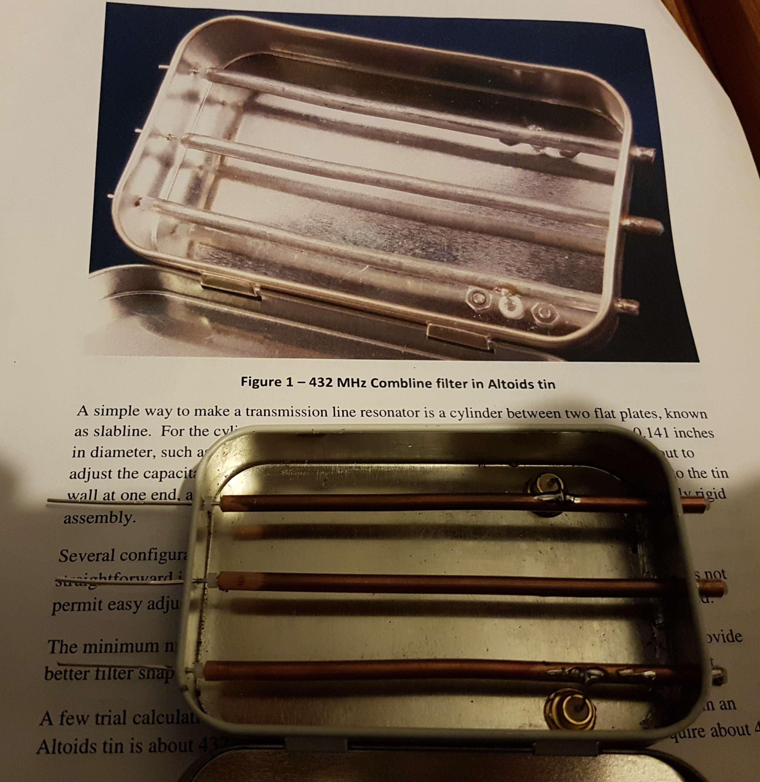

I made the lid and sides - the coupling can wait till CAT17 workshop session. Then I made a 432MHz comb line filter per the W1GHZ recipe on the club wiki. It looks like a piece of witch craft :D
I hope the club wizards can get it tuned on Saturday......
See you
David M0YDH

G4FRE
Posts: 214
Re: CQ250 bandpass filter
Post by G4FRE » Thu Sep 07, 2017 10:03 pm
i built the w1ghz 432 filter a while ago and it tuned up "as advertised"
dave
