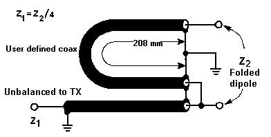

The screens of the balun are connected to the body of the N socket.
Attached Pic from internet, ignore dimensions, this one meant for 500Mhz ish folded driver.
Lots of ways of doing the same job, I do like the Sandpiper attempt.

Of course it's obvious that there is no DC path when I look at the thing with me eyes.. :oops:
Cheers Peter.
